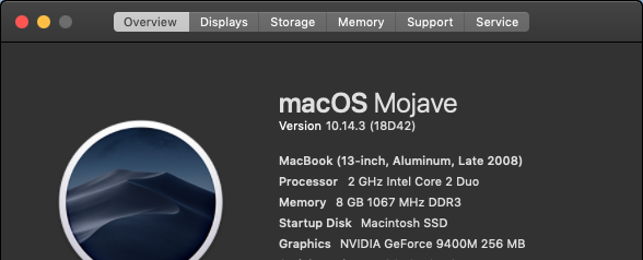

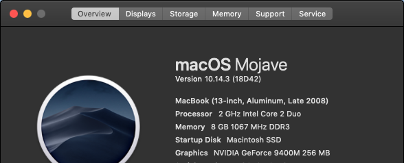

Straight through from the 10.14.2 to 10.14.3. Installed the update manually as I need to update my supported system as well. All up 25 min (including downloading the update, running patches, manually patching night shift, running Onyx).
I had to run Onyx as going into Displays in System Preferences was casing System Preferences to crash.

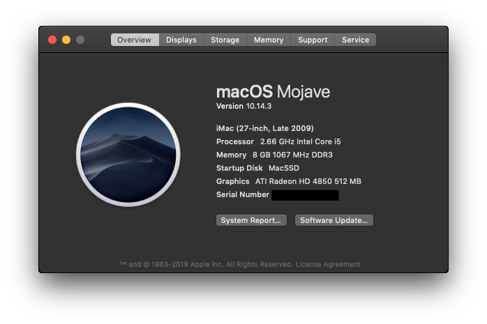

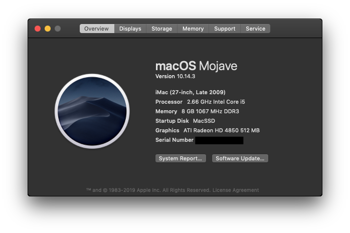

I'm happy to report my late 2009 iMac successfully updated to 10.14.3
I didn't do anything "manually". MacOS simply prompted me a new system update is available. I clicked on download and install, waited for a while, probably ~20 min give or take. The computer restarted by itself and after I logged in I'm on 10.14.3. So far everything is working just fine.

Just did it! So far I am very pleased with it too. This is the fastest my Mac has been so far using Mojave since this update. Somehow, my Mac boots at least 10 seconds more quickly. Thats also a plus. 100% recommend this update. Just be sure to reinstall your patches afterwards and you'll be set!

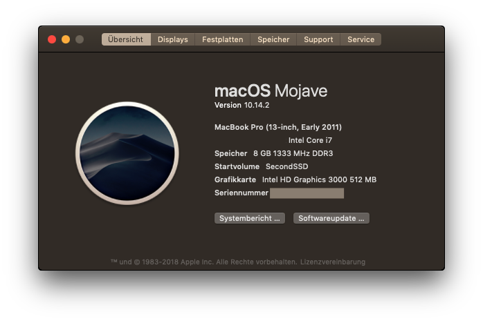

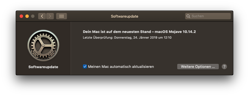

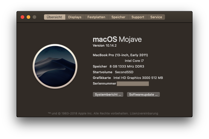

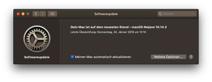

I don't get the Update to 10.14.3 :(
I did also download the 10.14.3 from Apple Support, but I get the message that my Hardware would be not supported.
Any ideas ?

Since your MBP natively supports it, you could convert your drive to APFS to benefit from the update feature within System Preferences. But mind that you would still have to patch every update through dosdude's patcher after installing the update.
