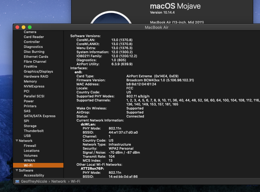

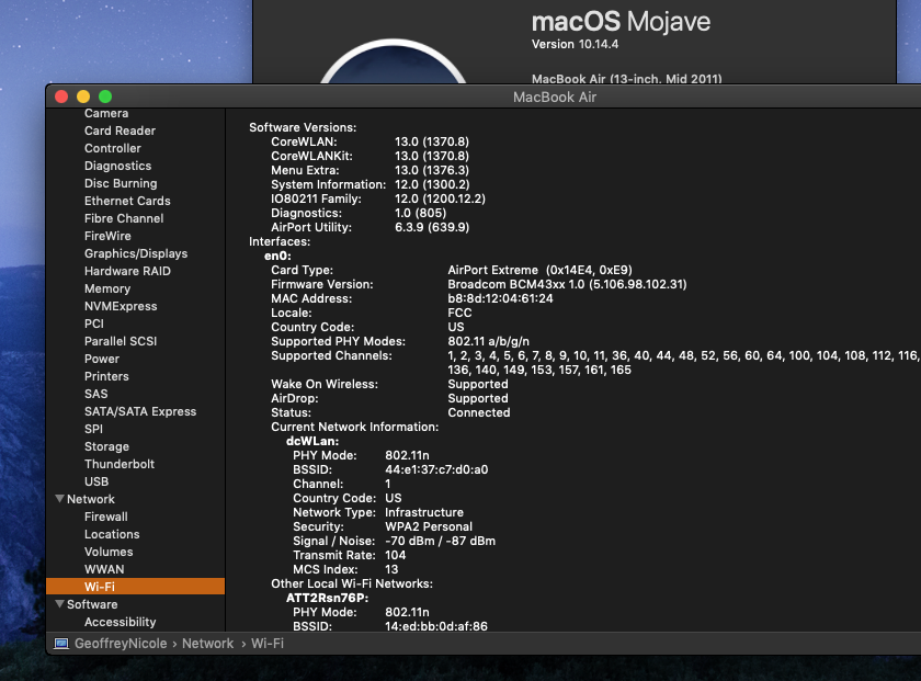

@dosdude1,
I have a question related to the BCM4321 Wifi Patch.
I have this on my system report regarding wifi
Do I need this patch although my wifi is working? Many Thanks.

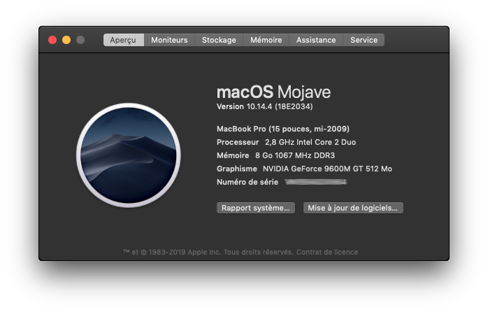

Hi, all
MacBookPro 5,3 updated successfully to 10.14.4
But:
- Siri doesn't work
- iSight doesn't work (worked fine with 10.14.3)
EDIT:
- Siri work well with Larsvohier solution #12894 (Thanks Larsvohier)

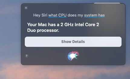

Pls. tell us how it went - do you lose Siri listening/mic input or is that related to the "double punch" I gave my MB5,2 with first re-applying all patches and then the backlight fix?
If someone experience Siri sound problems (no input device,...) try this:
sudo kill -9 `ps ax|grep 'coreaudio[a-z]' | awk '{print $1}'`
It will work perfectly.
