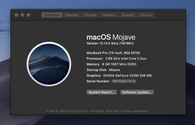

"WELL S.O.B.!!!" "It worked like a Charm!!!"
I let the "Software Installer" install . . .
Then rebooted to the Patcher;
Ran the patches;
Rebooted and got an instant 2/3rds done progress meter for a long time. Thought that was my "White Whirlygig". Then "13 minutes remaining" popped up and the install finished and . . .
It went right into the "Analytics" panel you get after a new install;
Clicked through all that, it went away and the "Patches" have been over written pop up came up;
Clicked "Re-Install Patches", it did and then asked if I wanted to reboot now, I did and;
It booted faster than in 10.14.4 and I have . . .
But it's feelin' slow and things are Hot on my MBP Mid-2010 7,1!! Just looked and "No Graphics Acceleration". No transparent anything . . .
FaceTime Camera works. FaceTime came up and ready a lot faster than .14.4.

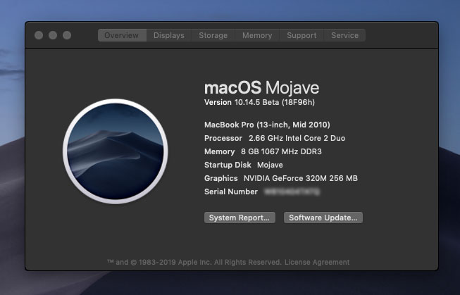

Ran the patches;

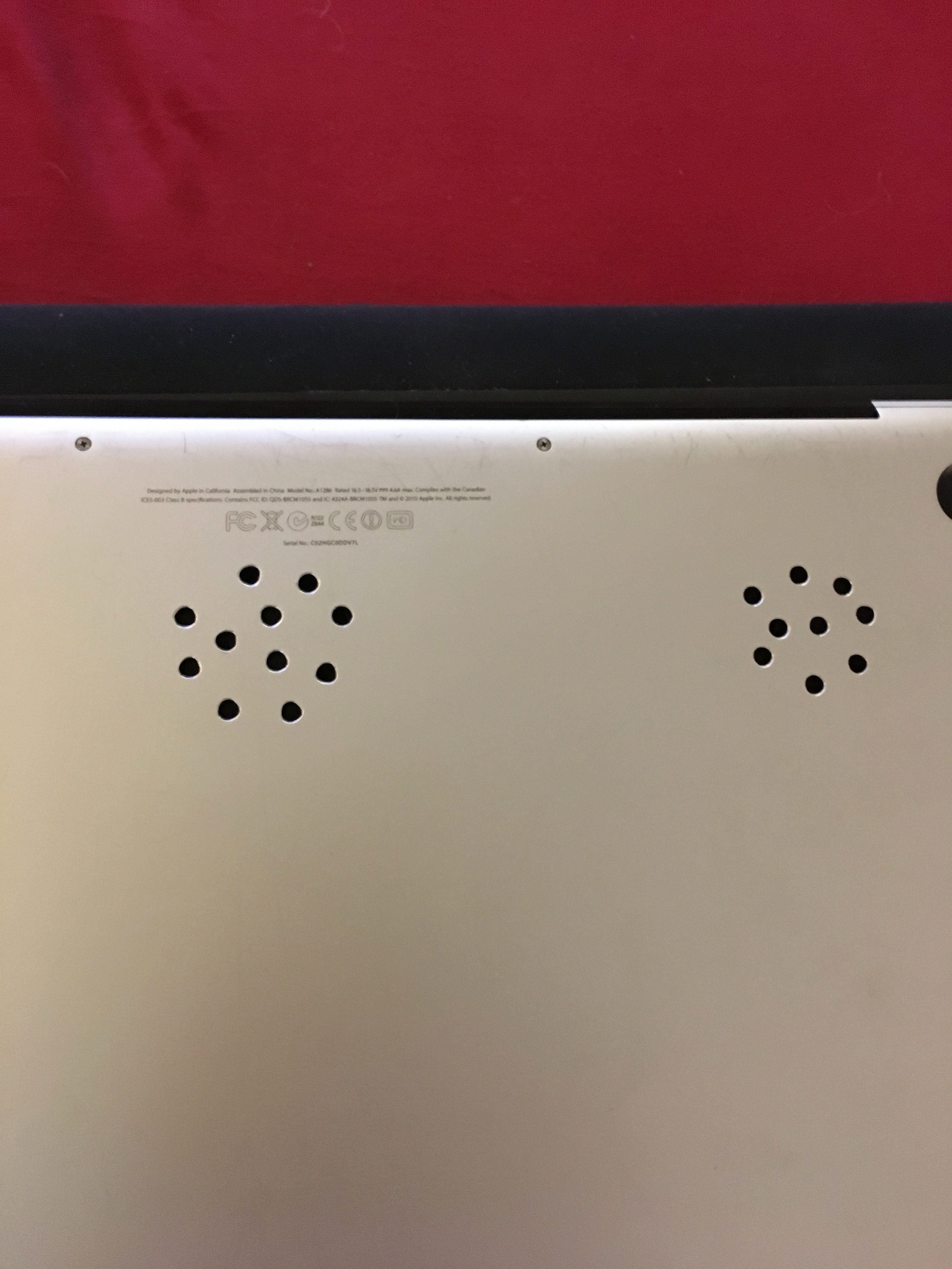

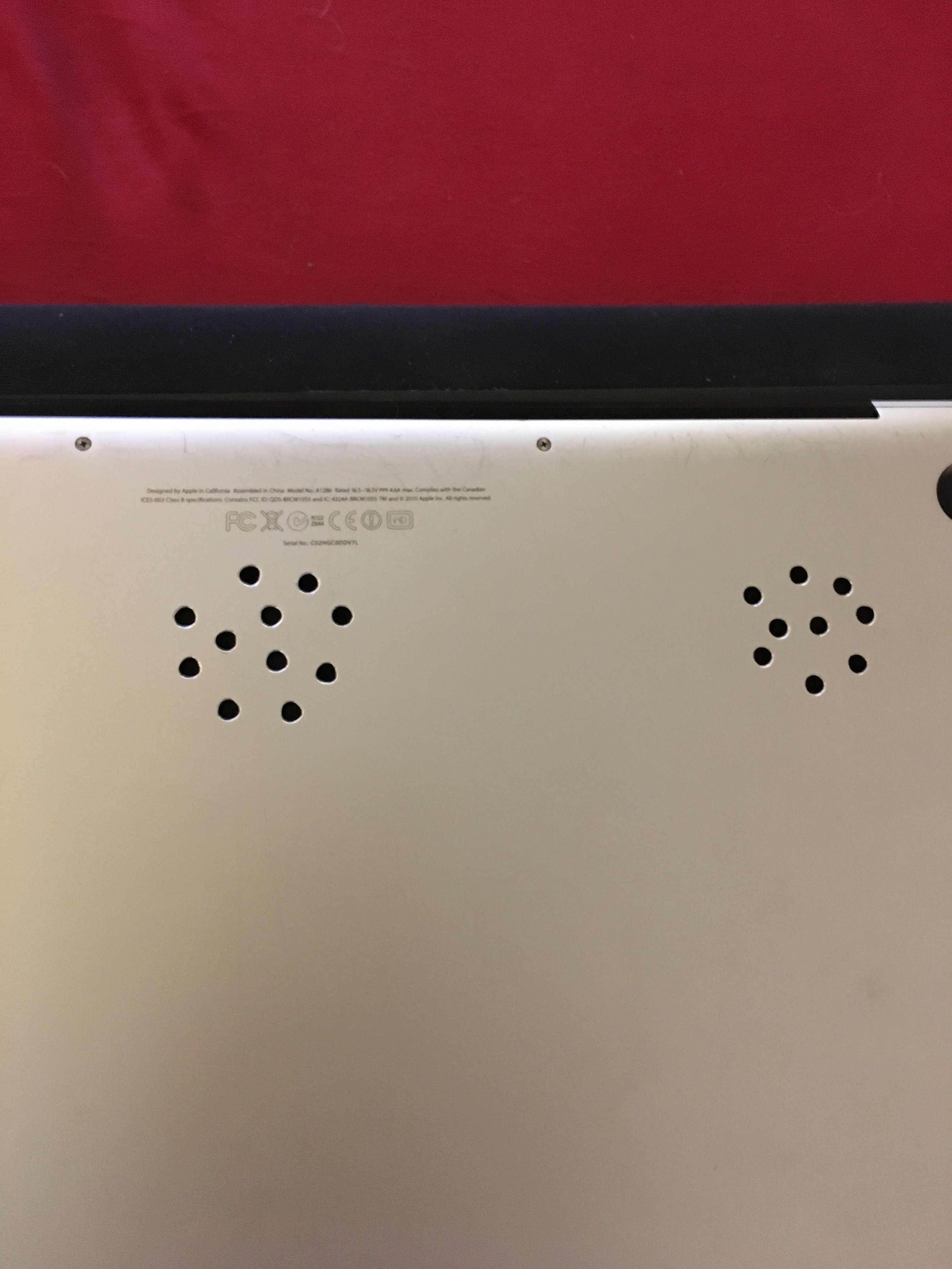

As far as MBP running hot, seems to be a typical problem...one of the mods I've done that is really not recommended by anyone but me, is when I replaced the battery and ram I took the bottom lid down to the shop after drawing circles inside where the fans sat...I drilled about 10 air holes in the bottom of my case and then deburred them, wiped it down and reinstalled it...when it gets hot I sit it on my laptop USB fan tray plug it in and watch the tmp drop 5 degrees...
Obviously you cannot have it on a table with drinks since they can seep in the bottom, and its not a pretty fix...but 5-8 degrees can have a prolonged affect on the life of this thing...its probably part of why the nVidia GPU has never failed...
I did get a MuxHat and plan on that mod...but I have other projects more pressing...
I'm not saying this is a pretty mod but it does work.

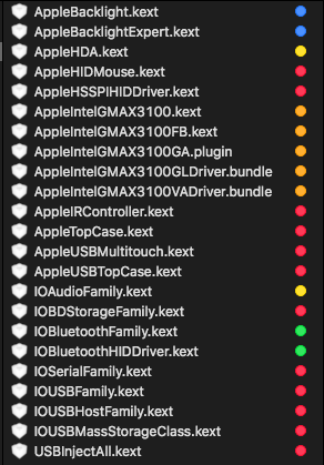

Tried the dev version of the patcher. Ran the patch command with terminal.
Same behaviour: Bootable installation but no USB/trackpad functions.
Idk what else to do. I have attached an image of your extensions folder. All of those should be in /S/L/Extensions except USBInjectAll and the Backlight ones. What you could do is find each one in /S/L/Extensions and compare the version number with yours. It would also help if you could run the patch command in verbose mode and save the output and send it to me. A verbose boot video might help as well. This is considerably harder to fix when I have to tell others what to try. I apologize to the community for these issues.
Red: USB
Orange: GPU
Yellow: Audio
Green: Bluetooth
Blue: Backlight

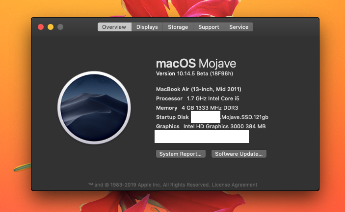

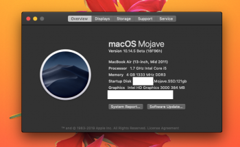

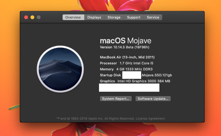

I was able to upgrade my unsupported MBAir to 10.14.5 developer beta 1.
Steps followed using @dosdude1's Mojave Patcher App 1.3.0 :
  • OTA
  • rebooted to the patcher usb device.
  • removed /System/Library/Extension/AppleIntelHD3000GLDriver.bundle/ (this is specific to my mac)
  • had to do the above to be able to boot.
  • continued installing update.
  • after boot, ran dosdude1's 10.14.4accel script.
  • rebooted and now on on 10.14.5
Only exception after upgrade is that no graphics acceleration (transparency) accomplished.
So I'm rolling back to 10.14.4 Final release.

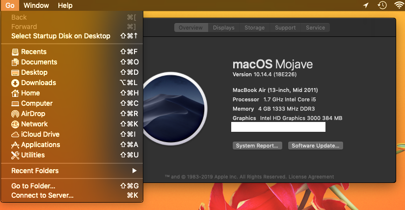

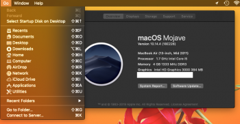

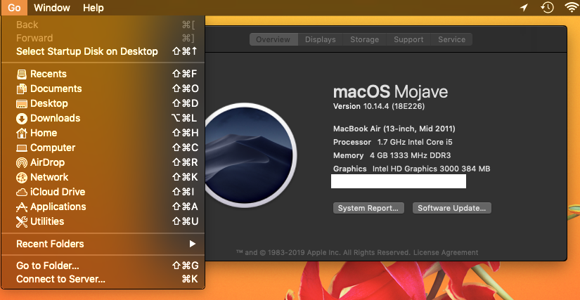

  • OTA
Rolled it back to 10.14.4 and retained graphics acceleration (transparency).
