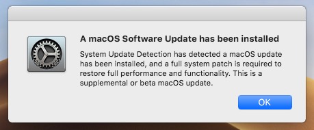

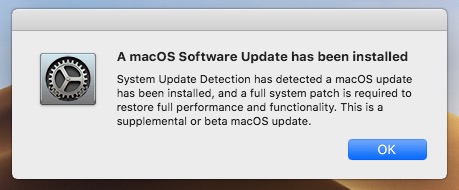

Have updated my MB4,1 manually (using pacifist) to 10.14.5b2
(The OTA did not crash, but just boot into the beta1 all the time, even without re-applying patches).
It seems to work this way - but now this message pops up on every boot.
Perhaps pacifist does not correct the receipts / there might be a discrepancy now between EFI boot volume and the installation or what might be the cause - and more helpful: What could I do to get rid of this and do a "full system patch"?
A degraded performance is not noticeable, though, everything is snappy as before...
This is a feature within my patcher to remind the user to patch their macOS installation after an update. To remove this you can either patch macOS or disable it on a per device basis by running sudo sudutil and then select to disable it. If that doesn’t work then I’ll walk you through removing it entirely.

The good thing is, the replacement kexts for the MB4,1 still work, v.1.1 and newer kexts v1.2 also, see spreadsheet-zip for info.
Just add the entry for the MB4,1 in the plist located in the Resources directory inside the application bundle. The APFS ROM patch itself should work just fine on the MB4,1.
