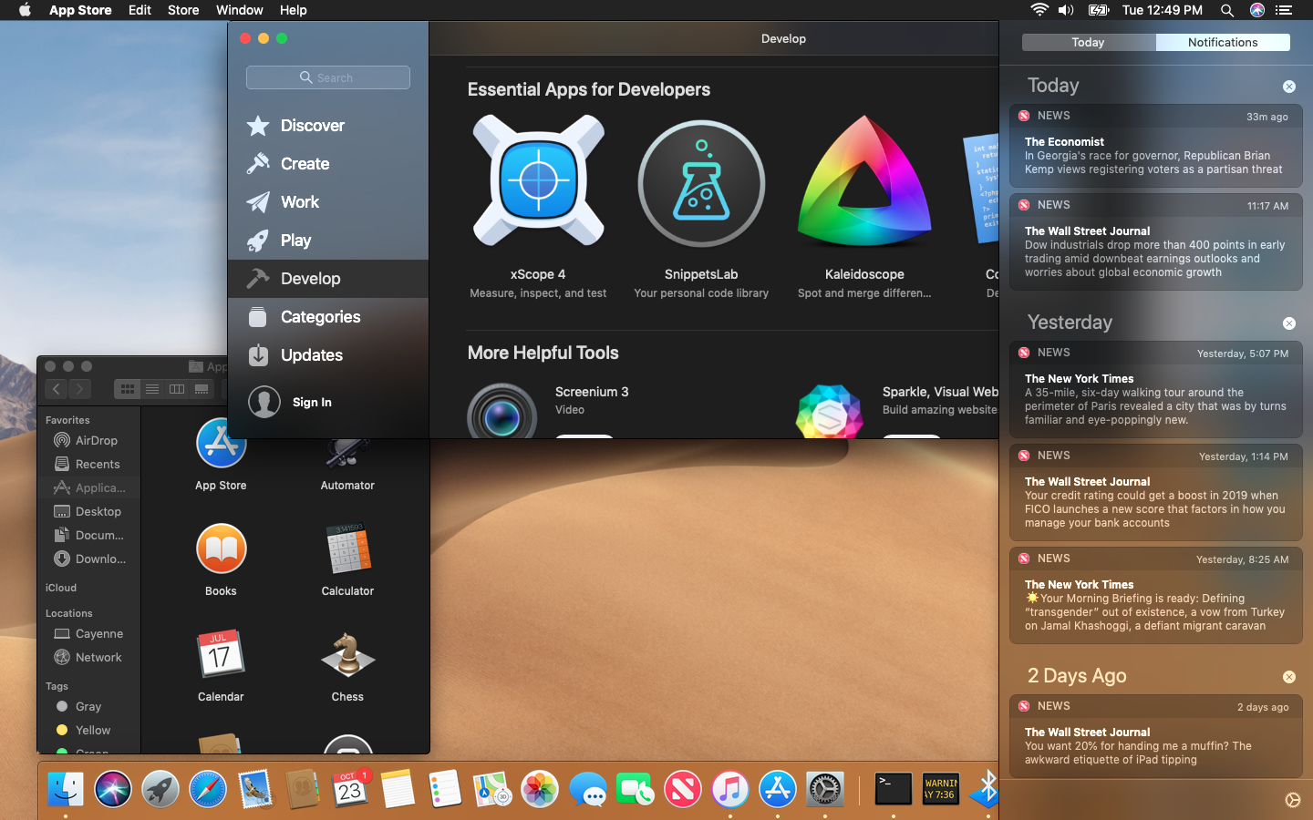

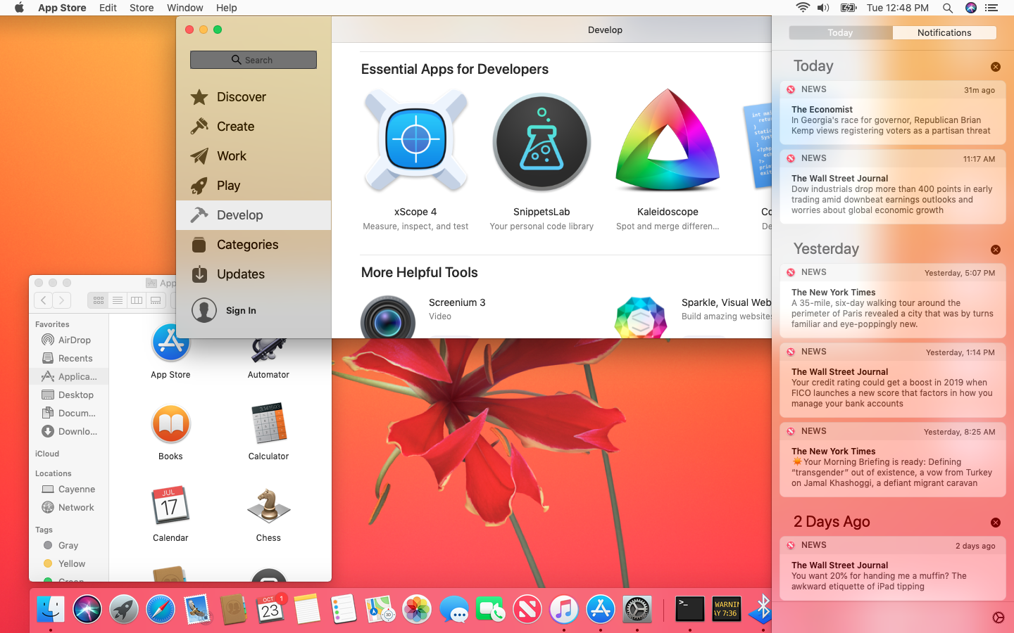

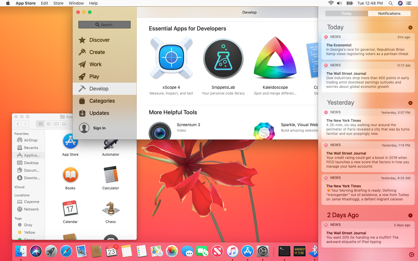

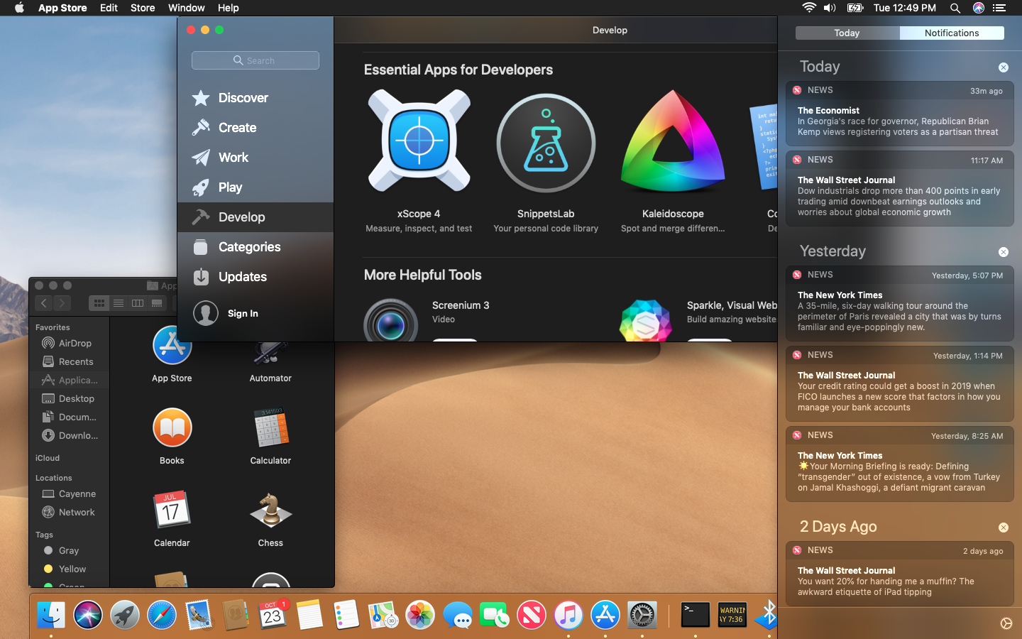

Hi all , a HYBRID MODE UPDATE (transparency and vibrancy fixes for Mojave Light Mode)...
Mojave 10.14.3 and 10.14.4 compatible Hybrid Mode updates are now available for download:
For 10.14.4 : https://github.com/SpiraMira/HybridMode-Public/releases/latest
For 10.14.3 : https://github.com/SpiraMira/HybridMode-Public/tree/v1.4.2
All the gory details screenshots , credits and installation (+recovery) instructions are available here as usual:
Hybrid Light Mode with vibrancy
Hybrid Dark Mode with vibrancy
NOTE: not everything was (or can be) fixed and some trade offs had to be made that affected mostly the menu bar across both Light and Dark Mode. Still in a work in progress...
Enjoy.
