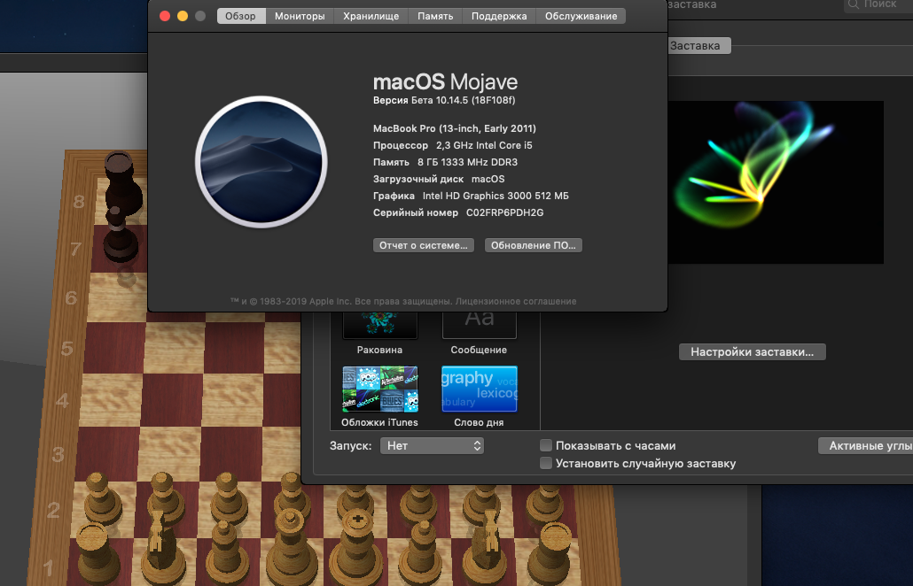

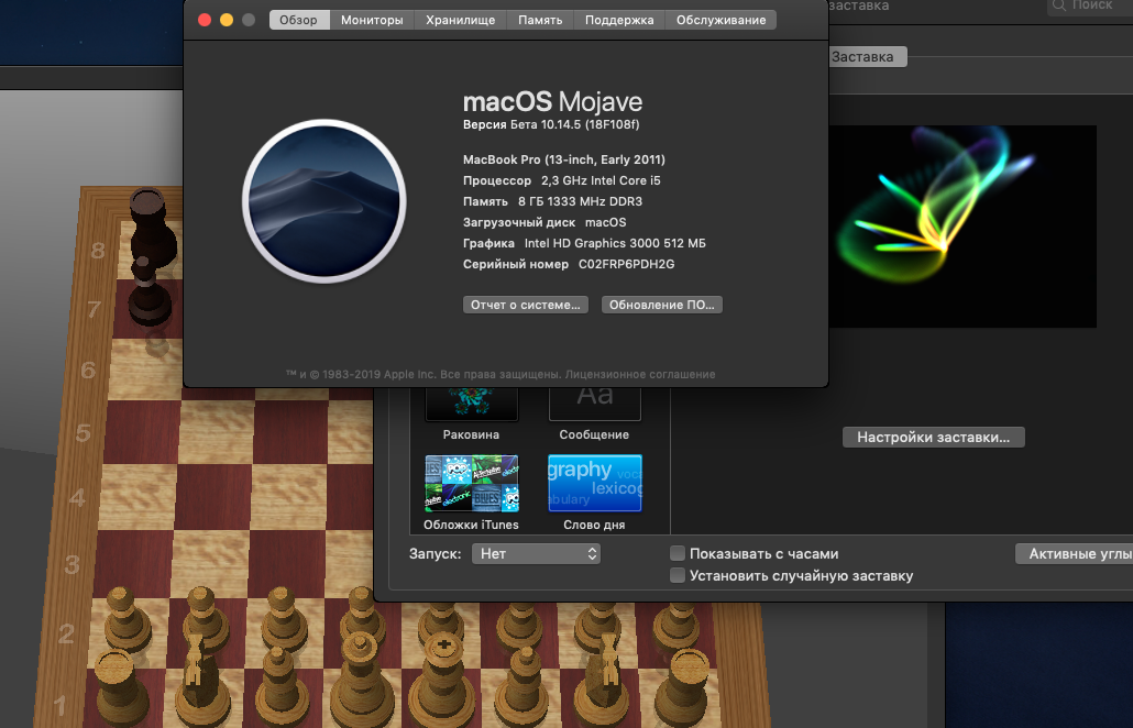

For my early 2011 MBP 8.1 13" with Intel3000 I have absolutely same story as @peanutismint.
After updating to 10.14.4 from .3 using @dosdude1's patcher 1.3.0 I have no system transparency, Siri wave, Chess and a couple side apps that use OpenGL rendering such as Jump Desktop etc.
I've even tried fresh install .4 on new unused before ssd no luck with above problem. Now I'll going to try to up for .5b2 with @ASentientBot finding of .3 CoreDisplay.framework, and if it fail I'd to go back for .3.
updating to .5 beta2 will bring a better OpenGL experience overall, without those previous .4 side effects, and at 99% you will have "transparencies" and acceleration this time.
Simple route: update via OTA, apply dosdude1's post install patches for your machine, adding in addition an manual replacement of CoreDisplay.framework , that's all.
Forgot to mention, to those who have had unusual OpenGL not detected, another attempt try to delete from SLE the NDRVShim.kext .
Even if worked with or without it, I don't use it on any of my machines.
So... I've updated to .5b2 OTA, then patched with 1.3.0 + .3 CoreDisplay. And I have everything working again!

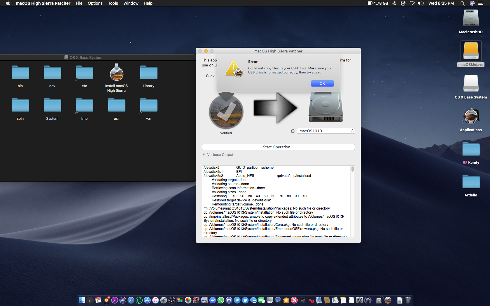

I bought a 500GB Hdd tried installing 10,14,2 but it won't boot tried making a High Sierra patcher and get this bs I am getting frustrated about to throw my iPhone se MacBook and iMac in my creek in the back yard and go back to easy hacker access windows so my of my info can be stolen
Probably something funny about the formatting of drive.

yes there is something wrong with the patcher formatting I format my usb HFS extended journaled and the patcher formats it extended I tried booting into 10.14.2 I had a sliver left to the end of the first stage of the boot process watched the Amazing race it took 42 mins to get to the end waiting another 30 mins no black screen with the apple logo I am so mad I never had this issues when I installed 10.14.2 when it first came out did apple change something so when we installed it again it doesn't work
[doublepost=1555565680][/doublepost]I guess I will keep using my old and newer Mojave patchers and apply the post install patches from each 3 I have and force rebuilding my caches until it lets me in or my iMac catches fire

In Disk Utility, try selecting View>Show All Devices. Maybe this will let you erase/format the entire volume.

Since I couldn't make a HS patcher I re-downloaded macOS Mojave Patcher 1.2.3 download 10.14.4 created the patcher rebooted and installed the post install patches from it since the patches from 1.3.0 weren't working I got into my desktop finally :)
It seems that the patcher renamed your target USB drive as OS X Base System. Have you tried naming your USB drive OS X Base System?
