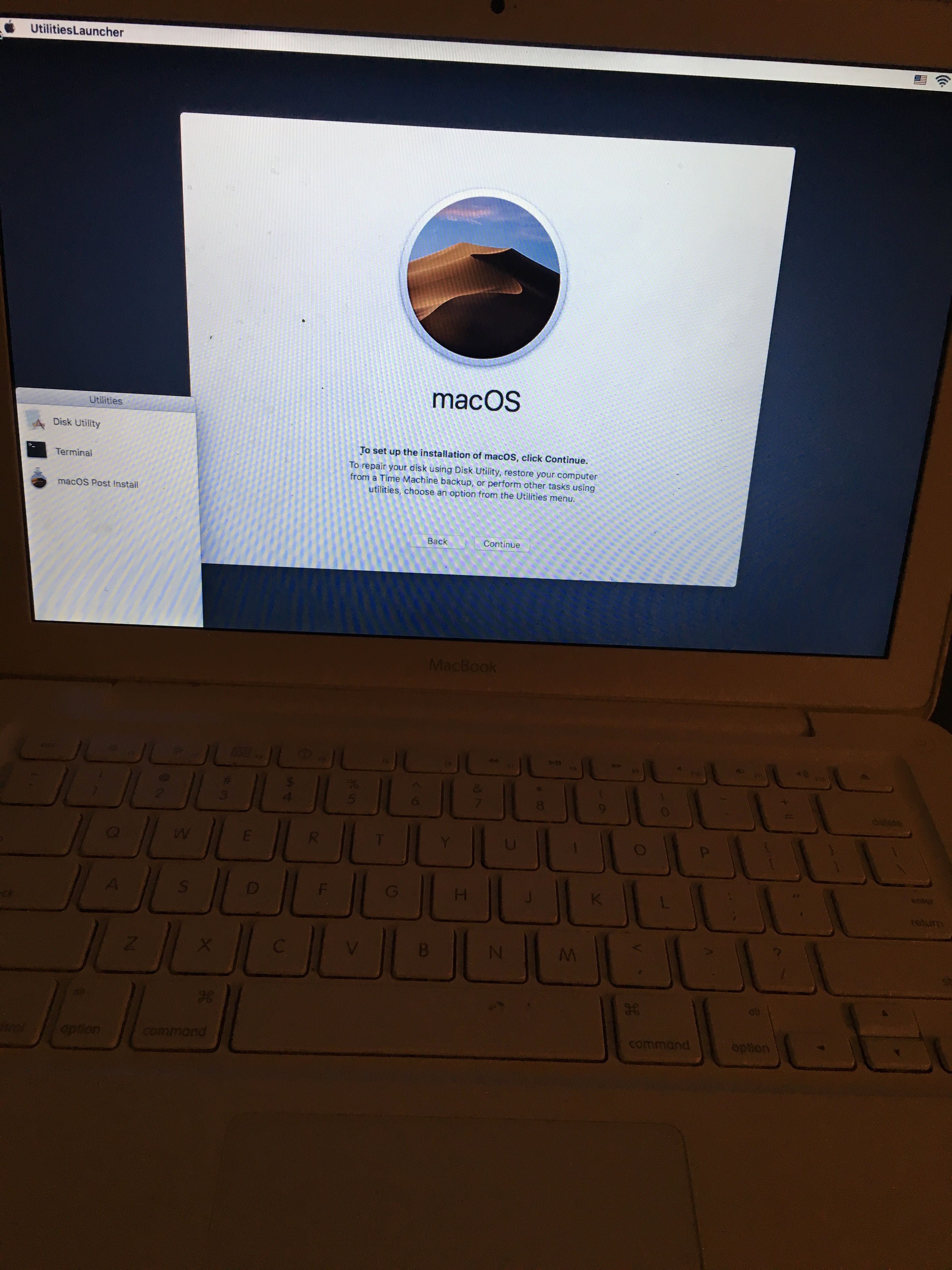

I just tested dosdude1 Patch Tool for Mojave and it appears that it boots on my MacBook Unibody 7,1. As soon as it goes into the installer it loads the Installer but, I can't use the mouse or keyboard and I plugged in a USB Mouse and it didn't work either. Maybe this is helpful? I hope so. I attached a picture of what happened.

@Loyd-01a Your issue/discovery has already been discussed.
#1451
It’s been talked about in this thread.
