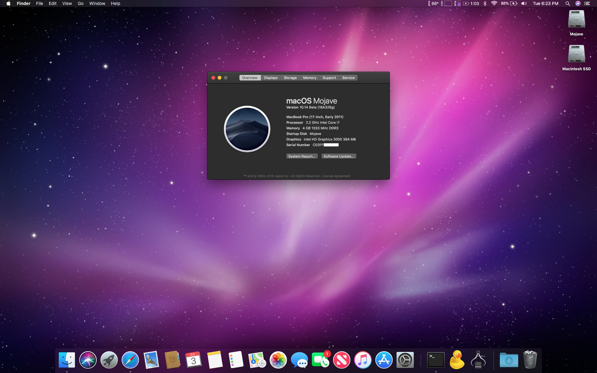

The update had to be done using a supported Mac, but is now running fine on the 2011 MBP. Beta 3, build 18A326g.

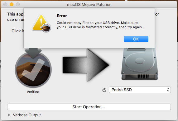

I already tried this patcher, but unfortunately, it was unsuccessful.
But I did the download of the beta 1 version from thepiratebay.org , but when I tried the patcher I received the following error:
How can I fix it? Can you help me?

[doublepost=1530668605][/doublepost]16 GB or bigger USB stick?
Also not necessary to dl from PB. The tools menu in the app can download straight from Apple.
I couldn't download the app straight from Apple using this patcher, I received a message in my App Store that my computer doesn't support this version of MacOS, so I downloaded from PB. Regarding the pendrive, I think that the software was trying to access the file in the mounted app. As the mounted app has only 5,7 Gb I think that this is the trouble. I'm trying now to copy the file to my SSD, or I will try to copy to an external HD and try the patcher again.
I have a 2009 iMac I was able to download MacOS Mojave even though the patcher tool said my Mac was compatible and I created a usb stick using dosdude's patcher

Use Beta 2 or later. Use the "Download macOS" option in the Tools menu to get the latest release from Apple.
