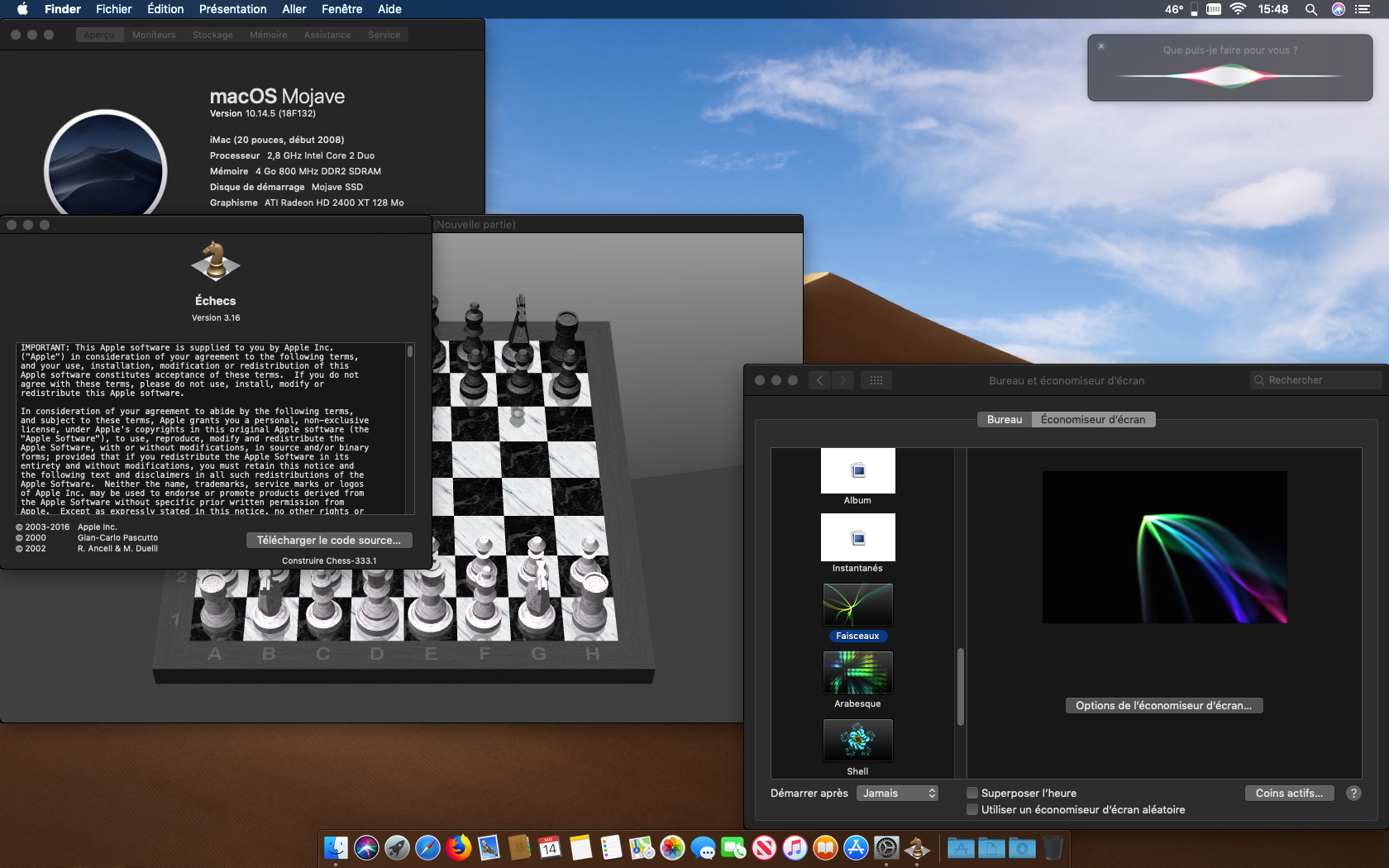

Hi everybody
updated 20" iMac 8,1 Early 2008 to 10.14.5 (18F132) from .4, I re-applied the patches with "macOS Post Install.app" 1.3.1 and force rebuild cache.
iSight (with FaceTime), Siri, Chess, Flurry and News work well (still no News+)
Only F1 and F2 for backlight control do not work
