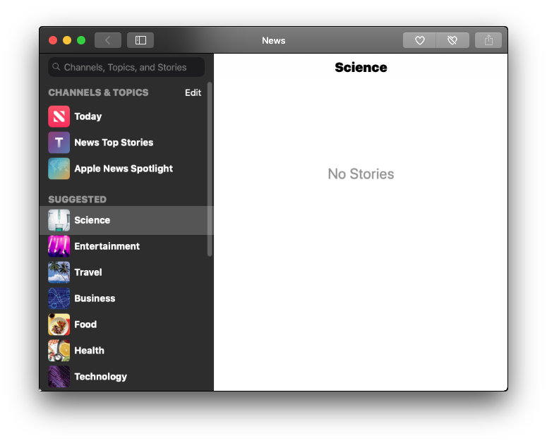

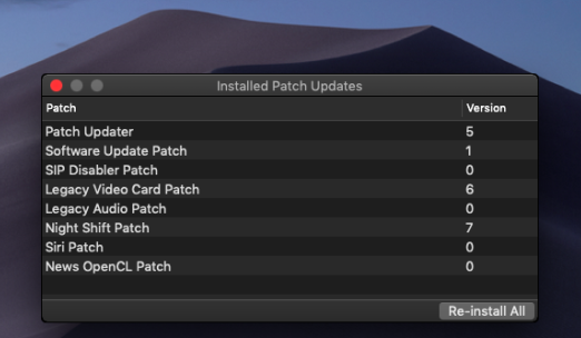

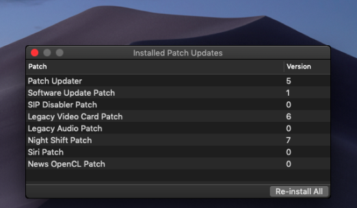

Just checked Patch Updater and got notice of "News OpenCL Patch" availability. So I installed it and now News works great.
As always, Thanks so much @dosdude1 !!!!

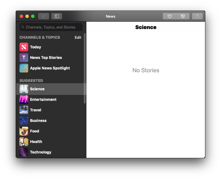

Swapped the .3 dyldƒ with the orig. in .6b1, reboot, installed "News OpenCL Patch", reboot. News and + continue to function. Great work by Minh_Ton, jackluke, ASentientBot and the dosdude1 for the timely patch.
Putting OpenCL.framework to Whitelist did not change the News app behaviour on my MacBook5,1. Still no sign of News+. It is nice to know that now I have OpenCL support for it in case it will work in the future.

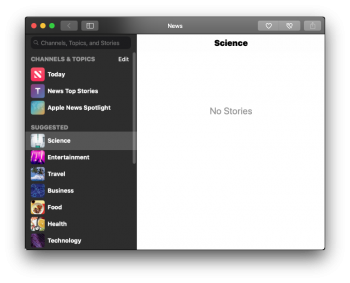

Thanks, but I meant I don't receive any content.
I thought Apple is actively blocking me from seeing content with its com.apple.geod.xpc
