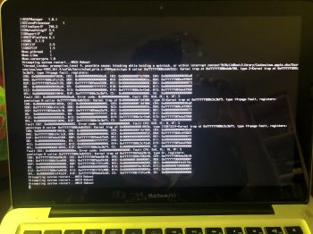

So yesterday I have updated my MacBook Pro 2011 and then I have booted to installer and patched files. Now I am hard stuck on: "attempting system restart mach reboot". @dosdude1 ? I have downloaded lastest USB Patcher and did everything as usually. So?

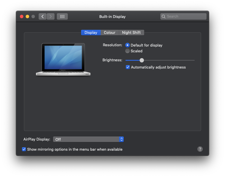

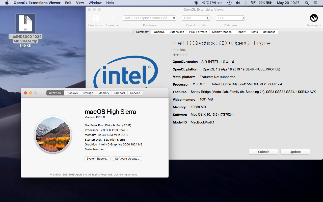

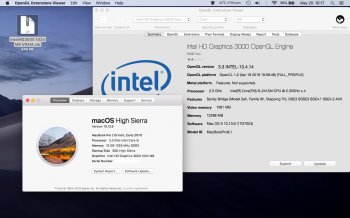

Hi guys! Who has a MacBook Pro early 2011 with iGPU intel hd3000 graphics please Do not upgrade to Mojave! You will not have the full video hardware acceleration with fully working intel quick sync technology! On top of that you will have bad looking fonts and other glitches etc. You'd better stay with High Sierra I'm telling you!... It works not worse but even better and smoother because of the video card unfortunately(... I've tried both systems compared and chosen High Sierra though...It's not that old fart yet)... Just my advice imho
I got mbp 13", early 2011 and i've already run Mojave. How to tell if video hardware acceleration is enabled?!
Reactions: TimothyR734

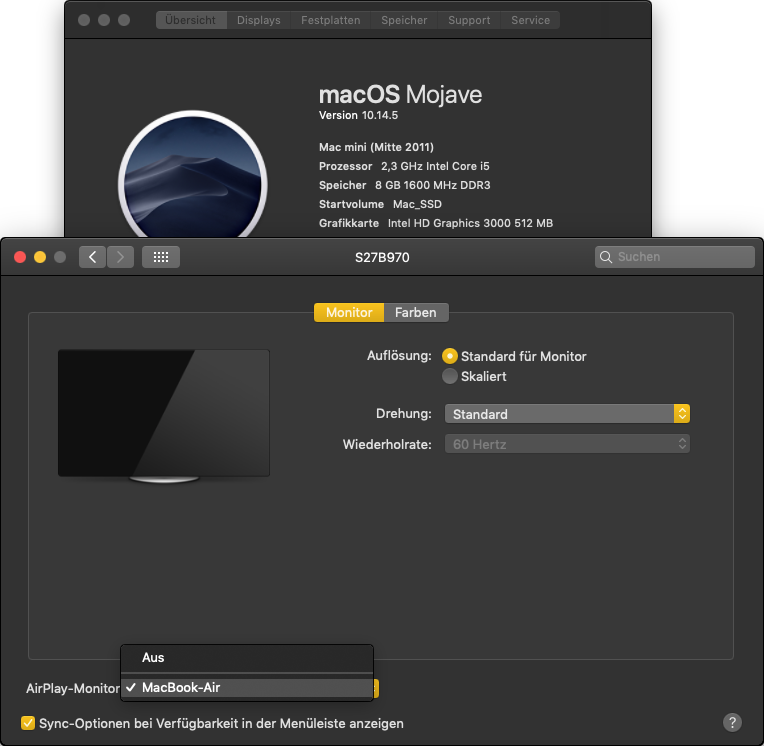

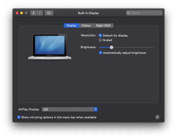

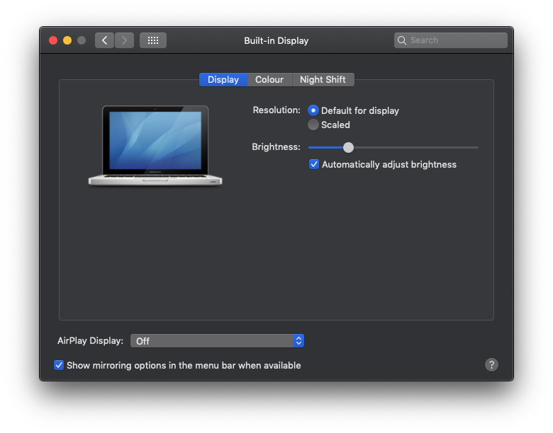

If I don't get wrong "Intel Quick Sync" is also the technology adopted by IntelHD GPUs (from Sandy Bridge and forward) for "Wireless Display" and AirPlay Mirroring, and it's correctly working on Mojave but MBP 13" 2011 with an IntelHD3000 only.
So technically if in System Preferences's Displays you don't have the "Airplay Display" function available, then you don't have the Intel Quick Sync feature.
Example picture attached, if there is no "Airplay Display" then there is no IntelQuickSync enabled.

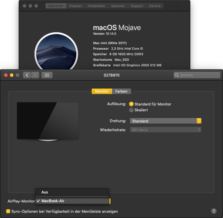

Of course there has to be an available AirPlay-Display" in the network.
In my case, the MacMini5.1 with HD3000 runs absolutely smoothly with no glitches or freezes whatsoever on 10.14.5.
I mean that I'd tested in real life with final cut pro x and quicklime player by exporting different videos watching iGPU load, and the result was way faster almost half time faster compared to Mojave. Tried different versions of final cut and all is the same. Even quicktime player on high Sierra loads the GPU fully but not on Mojave... Everything is in terms of time. If you just need some Mojave cosmetic go for it but if you need better performance in terms of video acceleration and so on stay with High Sierra or even better with El Capitan where everything is the fastest but unfortunately new software support is dropped and you are pushed to run High Sierra. But if you don't need new software the best option is running El Capitan the most reliable and not demanding OS I guess. SO have a good choice It's up to you what to use. I just share my thoughts with you guys. Have a nice day or night)

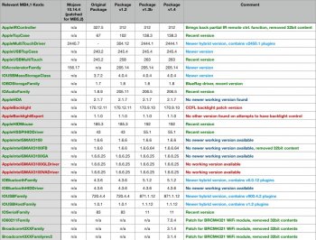

For the MB4,1 lovers:
I've updated my kext-package to v1.4 with the Broadcom Wifi kexts needed to run the original BRCM4321 card that the MB4,1 was equipped with. Runs fine and has been tested on 10.14.4 and 10.14.5. Thanks to @dosdude1 for the test machine! (In the MB4,1 that I previously used I swapped the card to get around this but after folks started using @0403979 alternative patcher it became clear that the old card was really not supported any more - just like in other machines). There will most certainly be better/cleaner/more straightforward solutions for the WiFi issue than this initial kext combo. Julian has some ideas, too, that can be tried out. More to come, it'd seem ;-)
What did not work was the Broadcom plus corecatcher replacement and corecatcherresponder solution that did the trick on other systems with similar cards...
Here's the download link for the package. Install with kext utility or copy to /S/L/E and correct permissions. Then rebuild prelinked kernel and reboot.
See screenshot for current kext contents in v1.4 compared to older versions.

P.S. I'd recommend you guys who has intel hd3000, you are able to increase your VRam if you'd like to. It will give some performance increased if you will... Just install two kexts by using kext utility in the archive attached (drag and drop onto it and wait until it's done the job). Afterwards just restart your Mac and you're good to go. To check whether everything is fine please use OpenGL viewer from Mac App Store it's free. Give it a like if you will)...Sorry but before all that disable SIP protection from the recovery mode, my bad)...also works on Mojave for the record)
