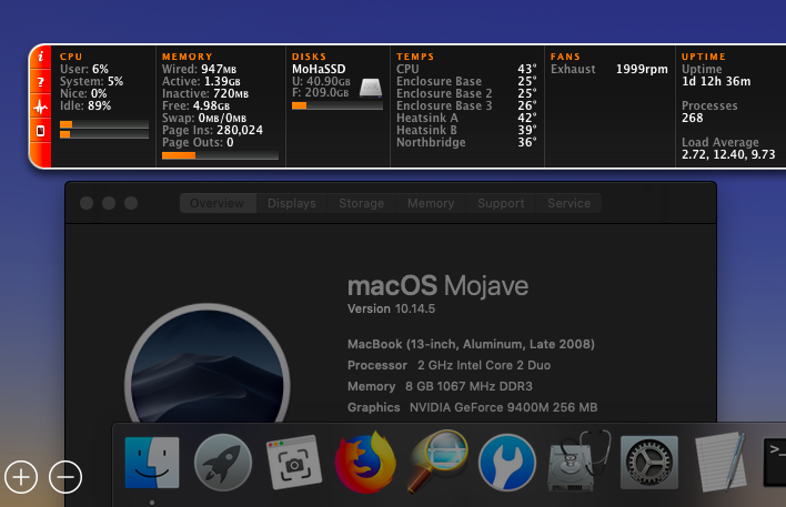

iStatPro 4.9.2 an ancient 32-bit widget. Very useful even in Mojave.
Thank you.
Is there a recourse where I can download it? I have older Macs that still run 32 bit apps. I'm purposely not upgrading them to keep some apps functionality, that were left behind by Apple. Soundtrack Pro from FCP Pro 7 is awesome and extremely powerful with functionalities you can't get from any other app today, and that's just one among many. I do have a 5,1 that I do want to put Mojave on, and I'm sure iStatPro 4.9.2 would be very helpful in that endeavor. Thanks.
[doublepost=1560489462][/doublepost]
Is it FCP 7 OR x? 7 is 32 bit, and unfortunately no longer supported. That's why I've kept a couple older Macs on El Capitan. The functionalities are no longer available today. I bought a 2017 5k iMac, and by the time I had the same functionality my 9,1 has, it cost nearly $3,000. Welcome to adapter and dongle hell.
Try here: https://istat-pro.en.softonic.com/mac yields v.4.9 VirusTotal sez OK
The version currently used here came off a Leopard PPC from 2009 v.4.9.2. ck your old HDs?
Reactions: jackluke
Thanks I'll look. I have the original cd's of Lion, & Mountain Lion, but if you're asking if I per chance downloaded it previously, I can assure you I haven't. I've only heard of it a month or two ago. A very useful tool though. I can live with v.4.9. Thank you.
