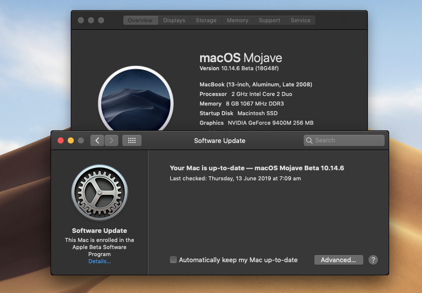

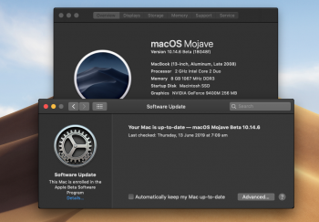

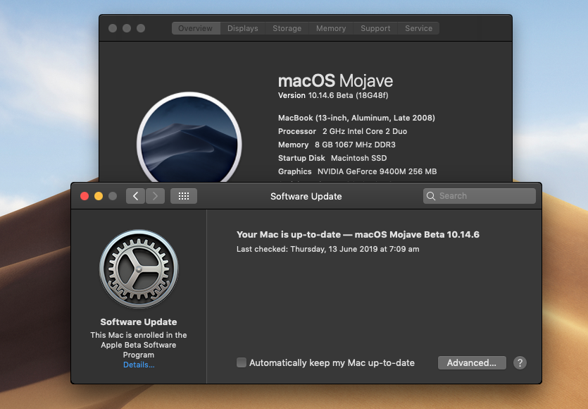

just installed 14.6 b2.All good except night shift patch.SysPrefs quits again and again.
Is in the display prefs,allright, but not in notifications pane!
while checking its boxes in display, sysPrefs quits!?

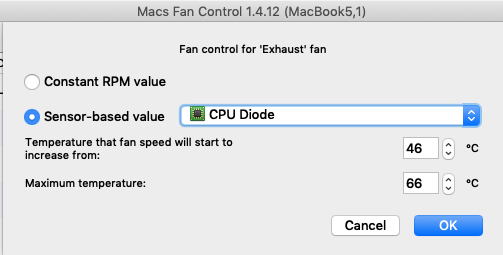

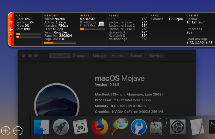

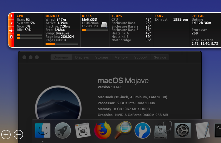

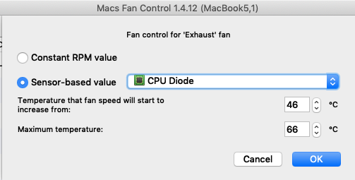

I did not notice any difference from the .6b1. CPU diode usually runs at about 50oC, when I watch 4K and 8K videos in IINA player the temperature goes up to about 70oC. I am using Macs fan control.
Here's what the MB5,1 on .5 sits at but got to 88oC briefly during a transcode fans at 3K, native fan control. Have you re-applied CPU paste?
MB5,1 temps:fan.png
Yes, I re-applied the thermal paste about 6 month ago. Native fan control is geared more towards quiet operation unfortunately. I only recently adjusted the fan curve and I am very glad I did. The bottom plate of the MacBook does not get hot even after 10 hours of operation. I believe it will help the longevity of the Mac as well.
