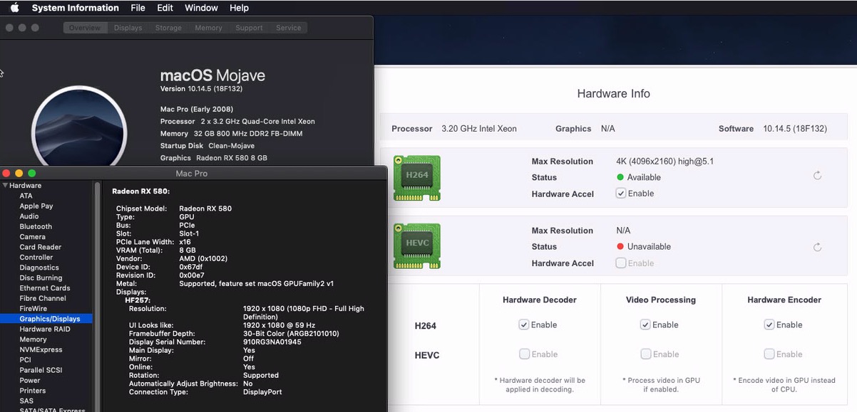

AMD RX 580 works in the 3,1 now thanks to netkas's work, just took a bit more effort to get working than we had realized. :)
I had to use the kext you mentioned to disable library validation. I tried using 'codesign' to sign the binary, which it did sign apparently correctly, however that only got me to the next fail point where it was failing to create the metal device.
I don't have 'ldid' on any of my Mac installations, therefore I attempted using codesign instead as suggested by dosdude.
The moment I loaded the kext to disable the display turned on and WindowServer stopped failing to create metal device.
Added Lilu and WhateverGreen along with appropriate nvram args for AMD hardware acceleration, VideoProc apparently can't determine the GPU hardware when it is in the 3,1...
"jellyfish-400-mbps-4k-uhd-hevc-10bit.mkv" plays properly with zero frame drops and nominal CPU usage (this is a 1.5Gb video clip that is 30 seconds long). Note that VideoProc claims no HEVC hardware decode (seems bug in the app) but it does work as without it this video isn't able to be played on a Mac Pro.
AirPlay to an AppleTV does show up now and I can get a black screen on the AppleTV but the display doesn't work and it never shows in display prefs.

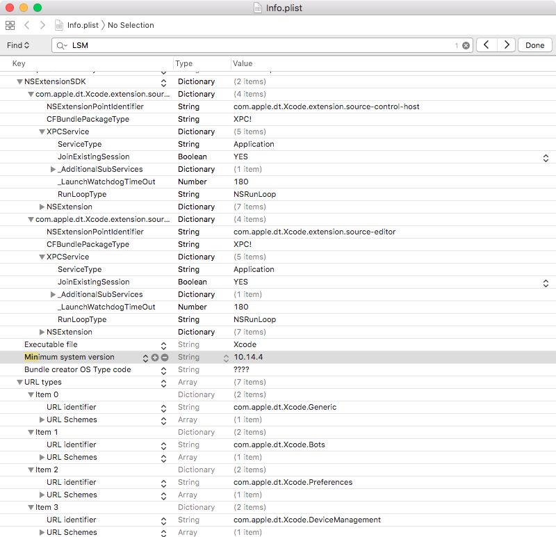

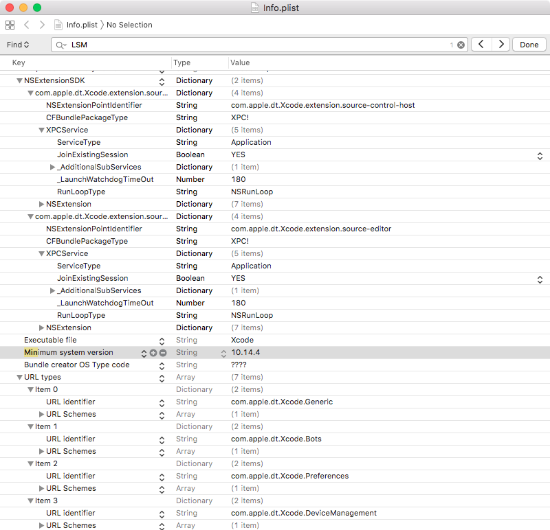

Is there any way to run Xcode 11 on 10.14.3?
I already have Xcode 11 beta "non-metal patched" from @ASentientBot on an external SSD , I noticed that in Catalina PrivateFrameworks there are some new SwiftUI.framework and maybe others related to Xcode11, so don't know, maybe editing the Xcode.app's Info.plist could be an attempt, I'll try on HighSierra 10.13.6 .
Funny: I'm editing from Xcode 10.1 the Xcode 11 Info.plist.
