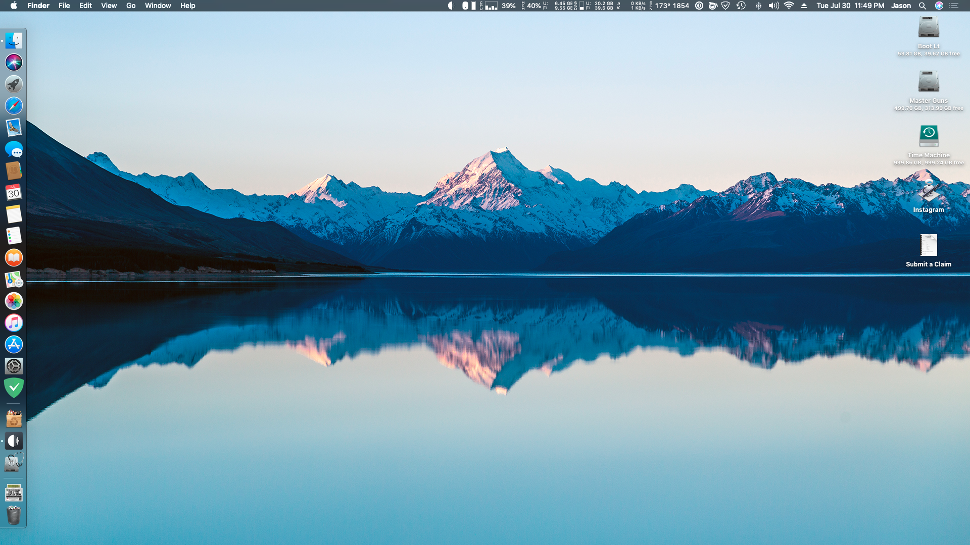

Well, a complete and total internet recovery to HIgh Sierra, and then to Mojave and I am getting my computer put back together again. If it happens again I am staying on High Sierra.
In the moment I ordered 2 larger SSDs from OWC though in case this one was dying. This machine better run forever.
Reactions: TimothyR734
Back...
