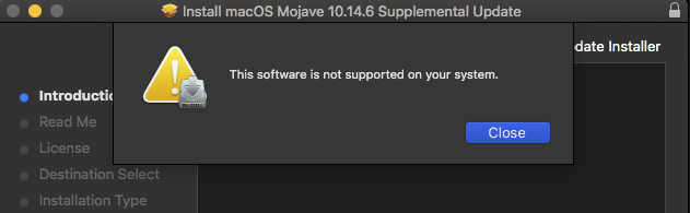

On non-APFS system we are getting this;
These are the instructions to install updates on HFS+ disks, this was posted earlier on in the forum,

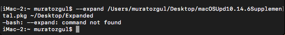

When I try this it says expand command not found

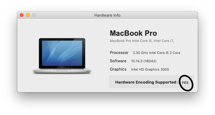

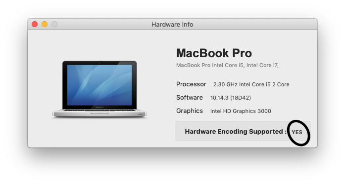

Good news for those with intel hd3000 (MacBook Pro 2011 etc.)... You have full hardware encoding until you upgrade above 10.14.3! So just stay on 10.14.3 and you won't lose. And please don't ask me anything. Search the thread and web, have a good one!... My credits to
Dosdude1
Yes, 10.14.3 (18D42) is probably the best Mojave version ever(for unsupported Macs at least). It did not break any patches after the update through System Preferences and it was running like a champ for me with only 2GB of RAM(and SSD of course).
Have another careful look at the L Caputo's post. Didn't you missed something?
read it properly again, pkgutil --expand

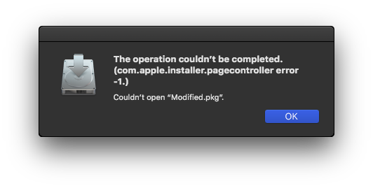

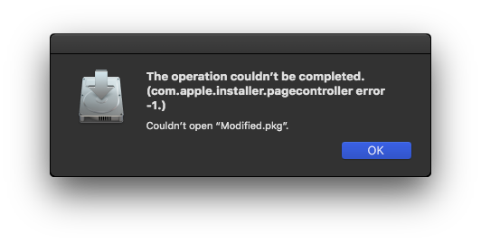

I did exactly what you said. Open Distribution file in Text Edit and added return true right place.
Than go back to Terminal and write this
pkgutil --flatten ~/Desktop/Expanded ~/Desktop/Modified.pkg
Then go to Desktop and start Modified.pkg here is the result;
Edit: I am so so sorry it is my fault. I got it now.
Reactions: TimothyR734
How long did you give it, it takes a couple of minutes for the package to be written, you have to wait until the
Terminal prompt $ appears only then will you be able to open the package.
EXACTLY don't be to be so hasty to jump on someone when you haven't fully checked your own actions.
