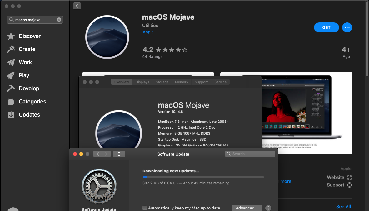

In case somebody finds it interesting. I am using my MacBook5,1 to download Install macOS Mojave App from the AppStore. Is it an old news that you don't need a supported Mac to do it, that I somehow missed?
Reactions: TimothyR734

My MacBook5,1 can download Mojave and High Sierra from the App Store but unable to download El Capitan. Isn't it ironic?

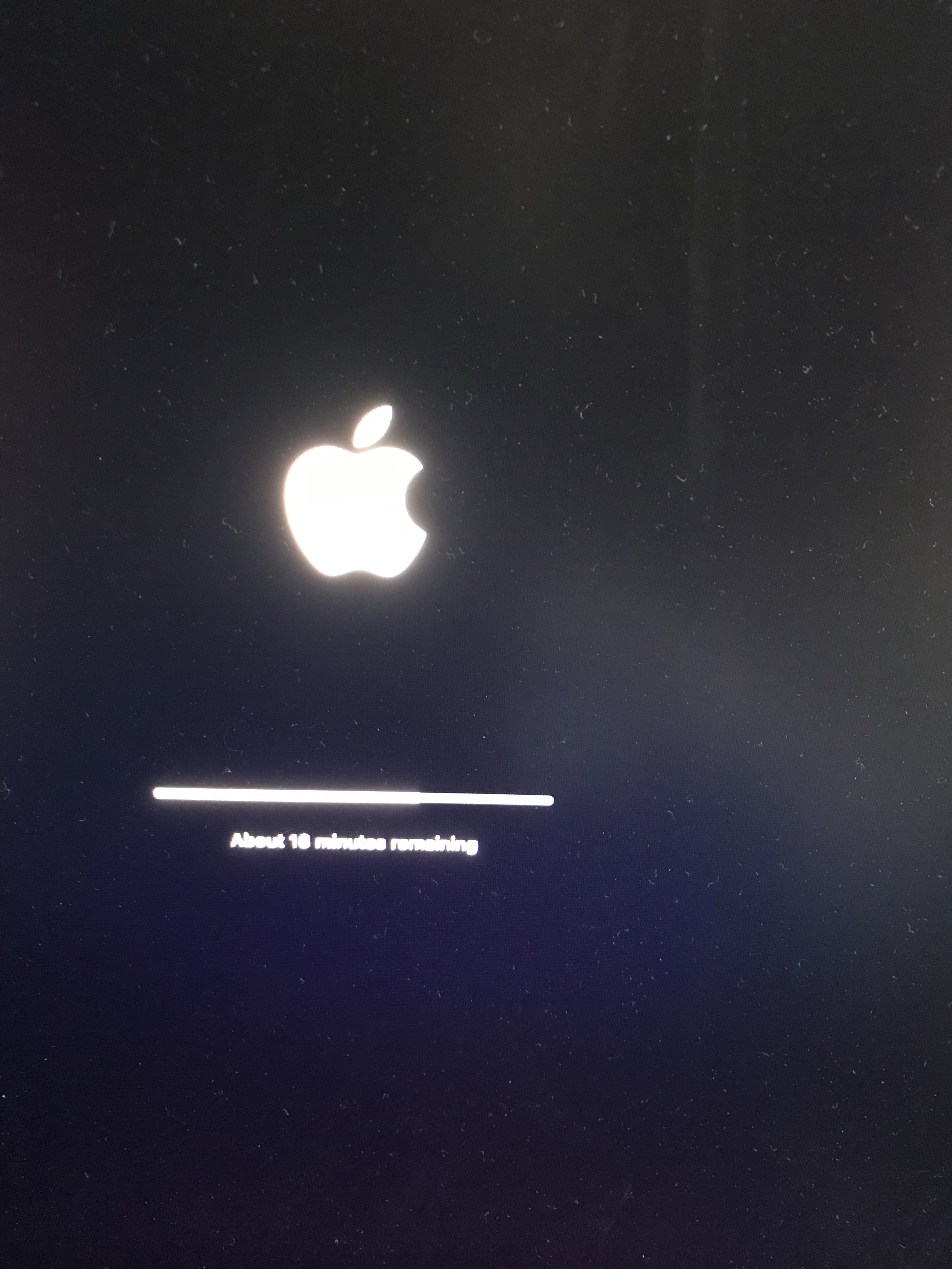

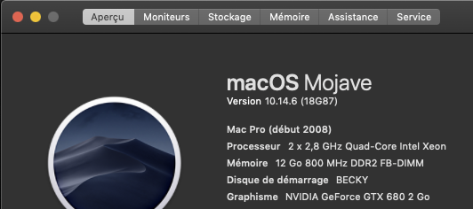

Mac Pro 3.1 here. Already had installed the 10.14.6 update before, this supplemental update was done via OTA. No post installation patches were necessary in my case, the Mac started flawlessly, but this time interestingly without the startup sound.
Exactly the same story here on my Mac Pro 3,1. Supplemental update via OTA, ten minutes work and no post install necessary. I didn't hear the starting sound either but I will reboot just to test that.........
[doublepost=1564825510][/doublepost]Startup sound is back on first reboot after the successful update.

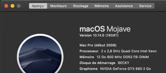

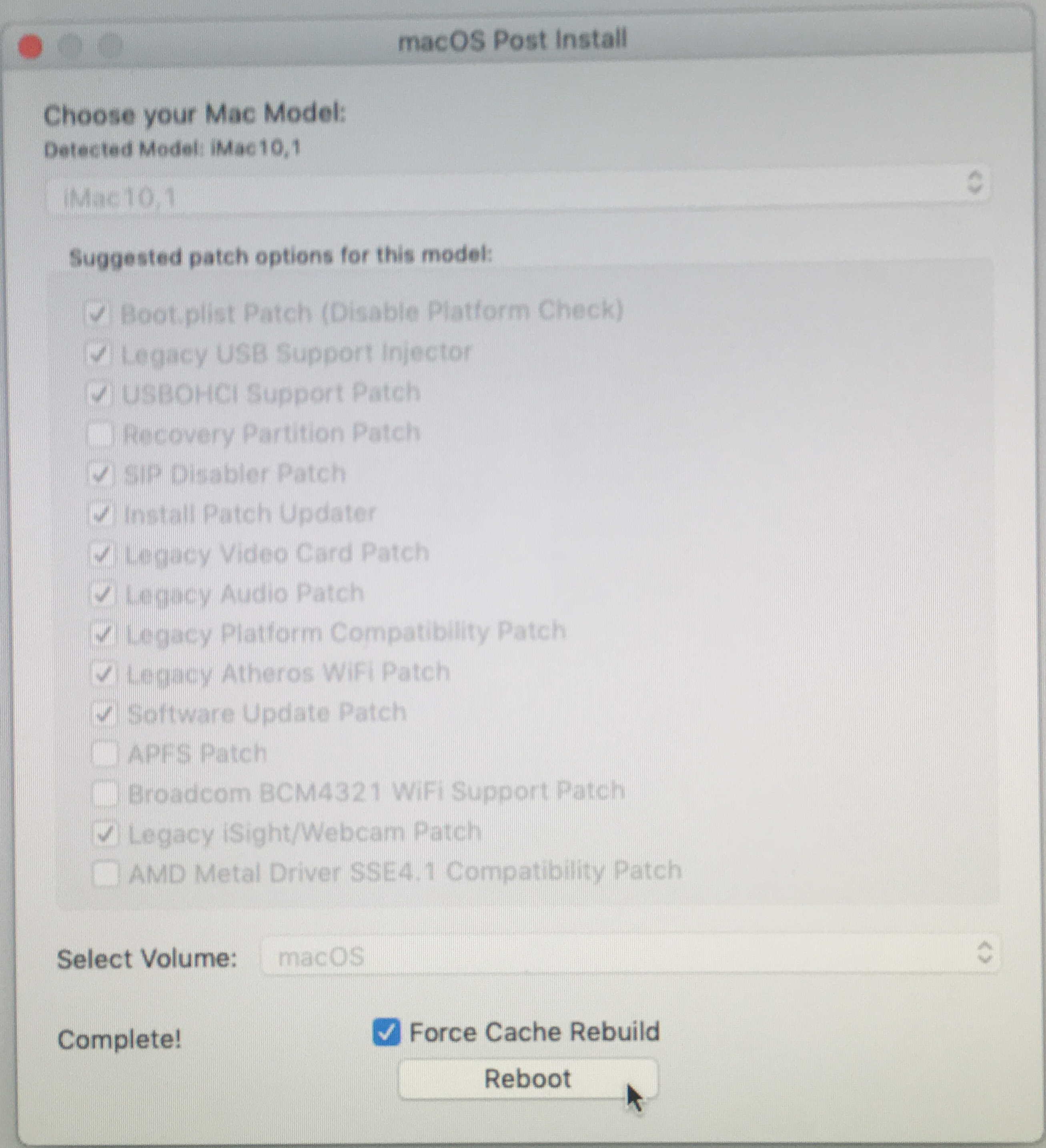

Hello everyone !
Just reporting that OTA update from 10.14.5 to 10.14.6 (18G87) with Mojave Patcher version 1.3.3 executed without troubles.
- System Preferences/Software Update: to download and start installation
- Holding Option key at restart after software update to boot from USB stick
- Apply the patches for my machine, iMac 10,1
After reboot and first login with an administrator account I was prompted to update some patches. I accepted the update and restart.
So far all seems alright, iSight is working with photoBooth and Skype.
Once again thanks to all contributors of patches and Colin for his tool. Also thanks to all brave early adopters of the latest version that gave me confidence in a smooth update.
You can download any version of macOS from the App Store. Apple provides the links on its support pages.
