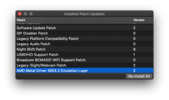

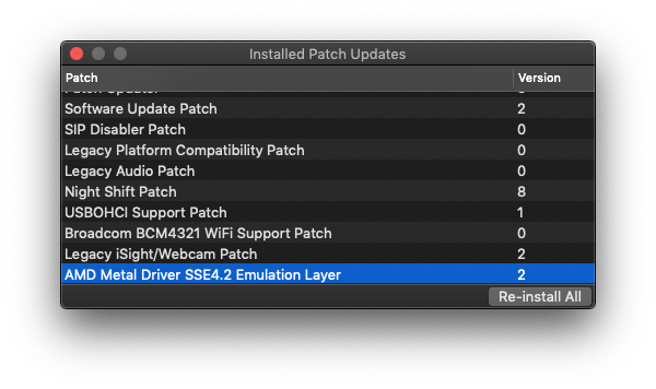

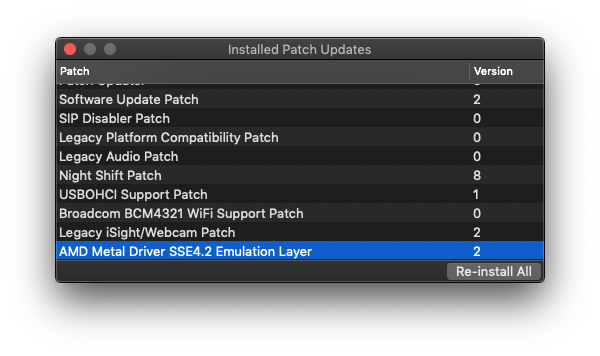

Hi all,
I've got today an update (I enclose a picture). It said is related to AMD 7XXX gpu series. Do this means that I can install one of these on my MacPro 3.1? Will I get more power than the GTX680?
Thanks in advance

Hi all,
According to the MP 1,1-5,1 GPU Compatibility List for cMP, only the 7970 is faster than the 680. That page has a note for MacPro3,1 "cMP doesn’t support SSE4.2 which is used in AMD/ATI modern GPU drivers". I don't know if that applies to the older AMD 7XXX GPUs or only to the newer AMD GPUs (RX 480, RX 580, Vega, Radeon VII, RX 5700 XT).
Read about SSE4.2 emulator at MP 1,1-5,1 MP3,1 (& others?) SSE 4.2 emulation (to enable AMD Metal driver) .
The emulator might not be needed in Catalina 10.15.4.
The AMD GPUs might not give you a boot screen. There's a page that discusses how to fix that:
MP 1,1-5,1 [HowTo] MP 3,1 Use AMD RX 580 for Mojave/Catalina and bootscreen (without flashing)

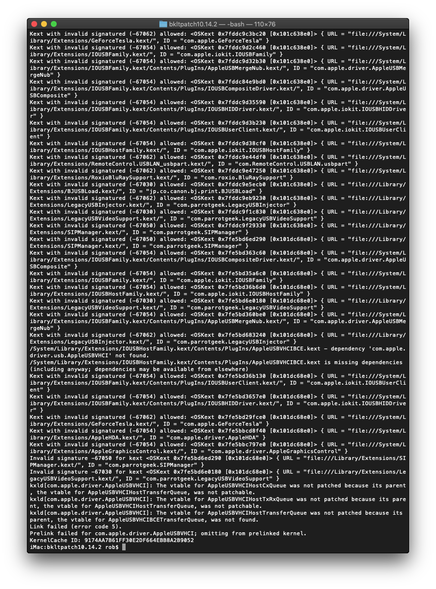

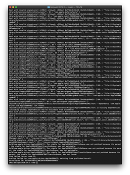

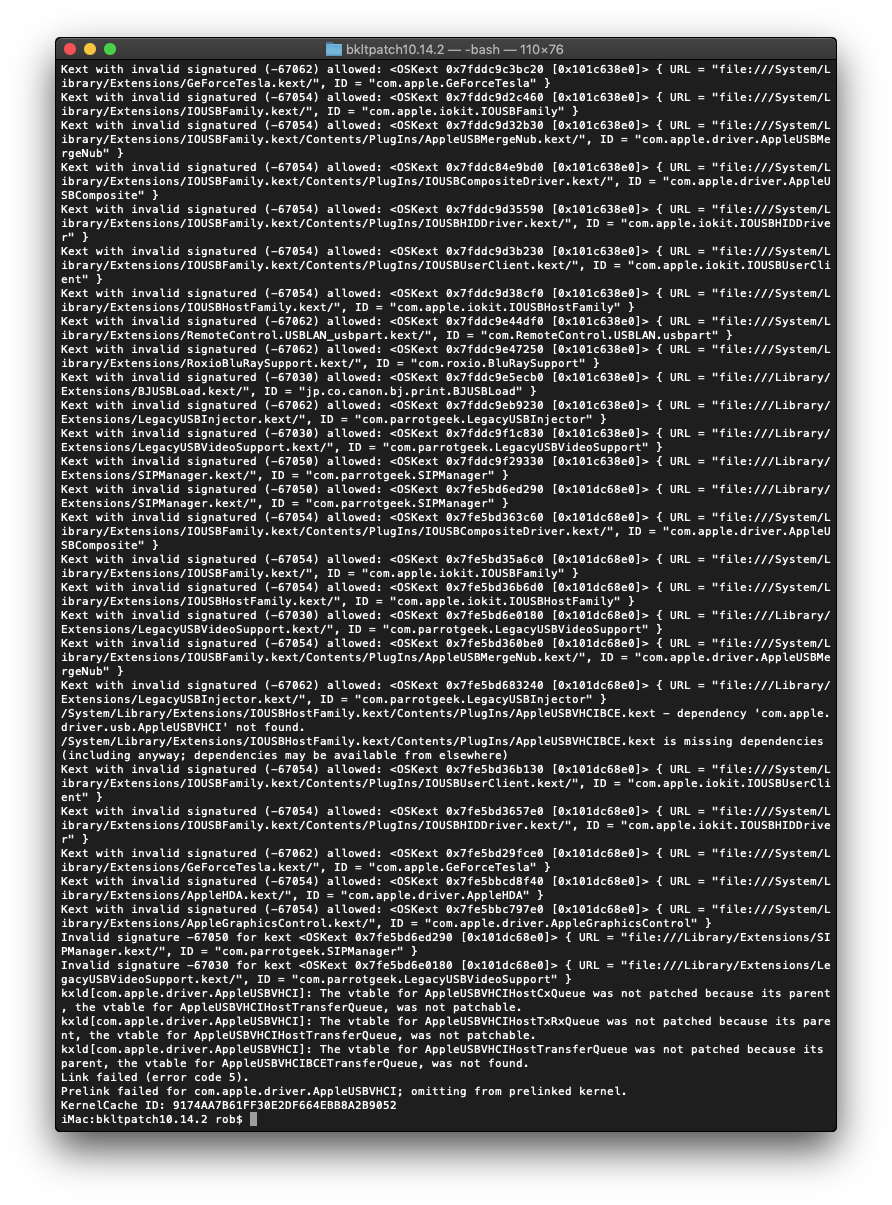

I was a little hesitant to try this but I just did this morning. I following what @dosdude1 typed in his original post and ran "./install.sh" instead of "sudo ./install.sh", does that make a difference?
I got a ton of errors running it - see attached.
After a restart brightness controls seem to be working fine. I'll have to keep an eye on any system oddity. Should I be concerned about all those errors?
No, those are not errors, just informational. They are telling you the kexts that have been modified and are being allowed anyway during your kextcache rebuild. Totally normal messages. Glad to hear the backlight is now working!
Reactions: TimothyR734 and ATC
I see. With a number of "failed" and a "Link Failed (error code 5)" etc... I assumed these were mostly errors.
I'm really glad brightness control is working again, this is much better than having a separate app to control it. Thanks again.
Thank you it works on my iMac 9,1 except I used kextutility to install the apple backlight.kext and applebacklightexpert.kext :)
