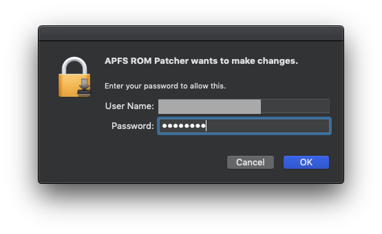

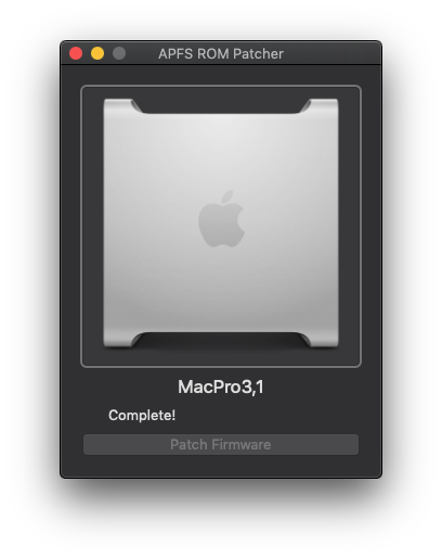

So here goes a blow by blow account of how this worked (for me)
READ THIS PANEL! After doing so I heard a long Beep! Then your machine will boot up normally...
View attachment 776079 View attachment 776080
Success!
View attachment 776082 View attachment 776083
Your backed up roms are here...
Profit!
I haven't installed APFS yet. Will do so tonight...

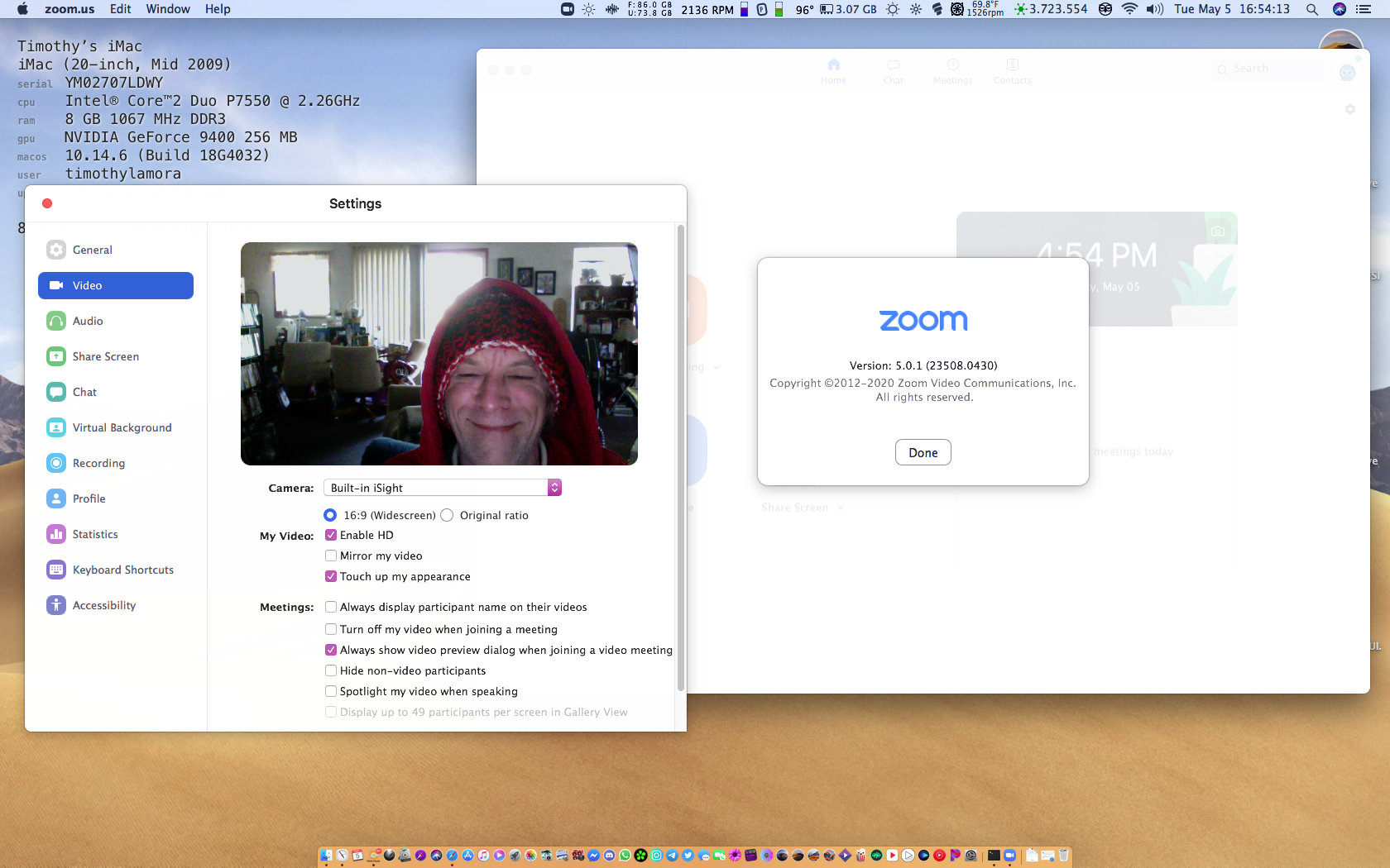

unzip this script and run it in the terminal to get Zoom 5.0 working from dosdude :)
  • zoomnonmetal.sh.zip
