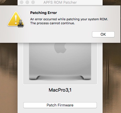

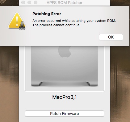

I got an Error while patching my Mac Pro 3,1's ROM with the APFS ROM Patcher Tool.
I removed all extra devices and all Harddrives except the system drive in Bay 2 and the nvidia gtx 680 gpu. I turned of SIP, in case this would be necessary.
Turned the Mac in ROM-Programming Mode, got the beep after rapidly flashing LED, started the ROM-Patcher-Tool and got the attached Error Message after dumping the actual ROM:
I can restart the Mac without Problems. I also repeated the procedure. Same result...
My current BOOT-ROM-Version is MP31.006C.B05 as recommended by Apple here.
Edit: Current OS Version OS X El Capitan (10.11.6).
EDIT2: It depends on the OS Version! At least High Sierra is necessary to get the APFS ROM Patcher working!
Any Suggestions?

Really I can´t tell you. Everything worked like a charm in my Mac Pro 3,1
Hi *******, thank you for your reply. Can you remember which hardware-configuration you used while patching and which OS you used to do it?
For my next attempt I did a PRAM-reset put in the harddrive in Bay 1, put in the default gpu (ATI Radeon 5770) and I am considering installing High Sierra first with the High Sierra-Patcher to run the APFS-ROM-Patcher in High Sierra, whereas I think this can't be the Problem. I will report my progress 😁
Try posting to a thread related to your issue or creating a new one.
I appreciate your advice. As ROM-patching is related to installing Mojave/ Catalina on an unsupported mac, and dosdude1 has written the APFS ROM Patcher Tool and is the threadstarter, I thought this is the perfect place for my question. Maybe I should write him an email, but I hoped that anybody here ran in the same problem with the same mac and found a solution...

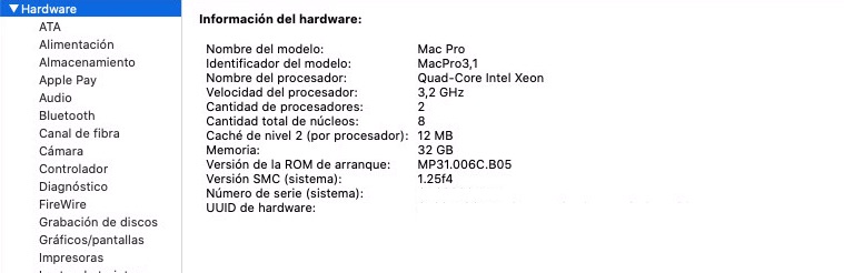

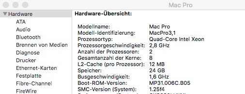

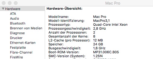

Ok. I'll try it in High Sierra or Mojave. And do you have the same Boot-ROM-Version and SMC-Version as me? You'll find it in System Report (ALT-Click on the Apple-Sign-> System Information)
I ran the patch on my MP 3,1 without issue but note that the process is risky and can damage your machine if you have the wrong chipset. The error message might be a safety net included to stop such damage when possible unless you are sure you are on the required Intel Chipset.

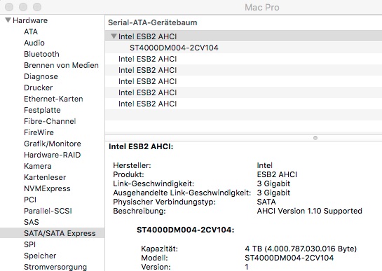

Can You also check your Boot-ROM-Version and SMC-Version, if it's similar to mine. I'm sure, if got the required Intel Chipset:
Can you also check, if it's the same at your MP 3,1.
Thank you.
Reactions: TimothyR734
Can you also check
SMC and Boot ROM are reporting the same as yours and your ChipSet is same Intel one I have, so it should work.
I believe I was already on Mojave (HiSierra at least) when I applied the ROM Patch. Not sure whether OS makes a difference.

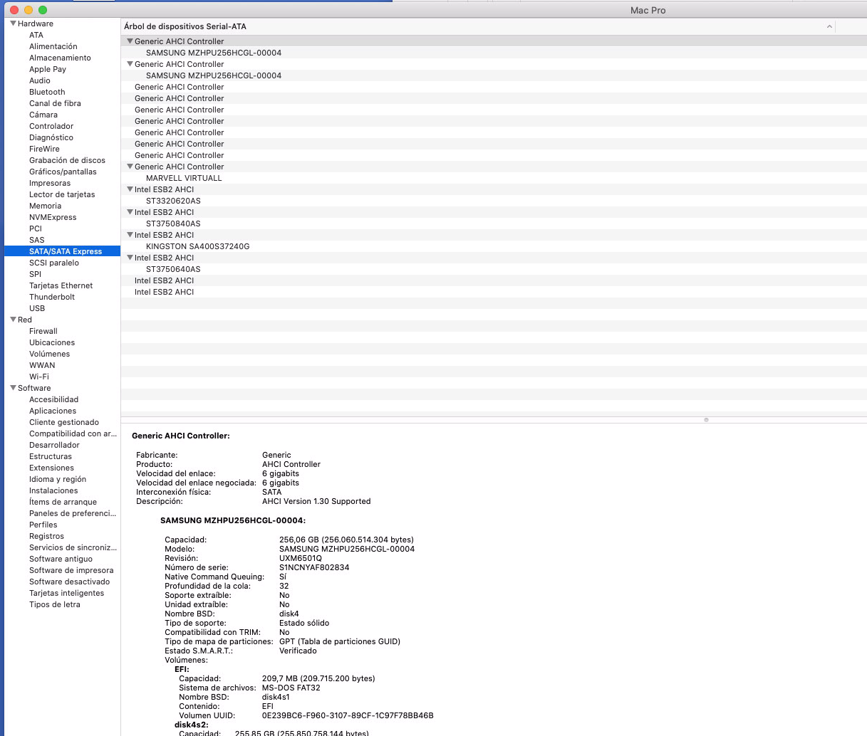

Thank you.
Sure.

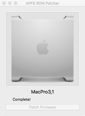

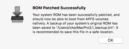

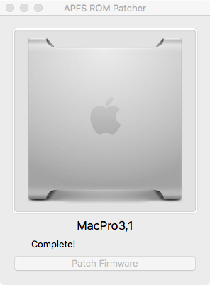

I solved the Problem. It depends on the OS. I installed High Sierra, started the APFS ROM Patcher in Firmware Programming Mode and had success:
After shutting down I put in my Sonnet Tempo SATA3 PCIe Controller with the El Capitan system volume on it, the gtx 680 gpu. Everything worked well.
Then I installed Mojave. After rebooting it repeatedly bootet the drive on the sonnet tempo as default also when I choose the EFI-Partition on the APFS Drive with the Mojave Installation. After passing the APFS custom booting method installed by the post-install tool it restarted the El Capitan volume on the sonnet tempo adapter. But after holding ALT during the boot process and choosing the MOJAVE APFS Volume directly it booted natively into MOJAVE. I'm actually writing from a natively booted MOJAVE installation on an APFS Volume.
The only issue was related to bluetooth. The installer volume didn't recognize my magic mouse after rebooting it for the post-install routine. I had to find my old usb apple mouse to get it running. Then I had to reconnect the magic mouse in the bluetooth settings on the fresh MOJAVE installation and it worked again.

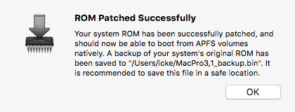

View attachment 965063View attachment 965061
Nice!
