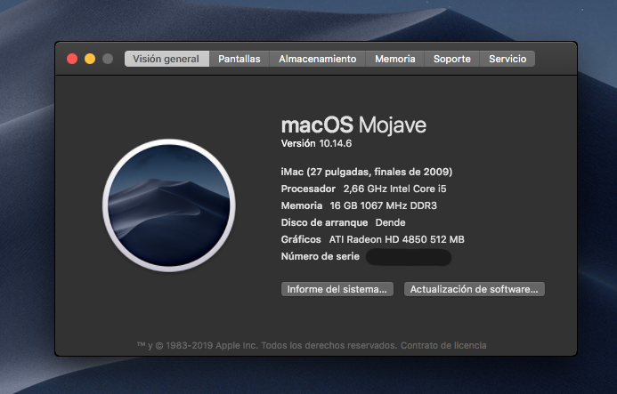

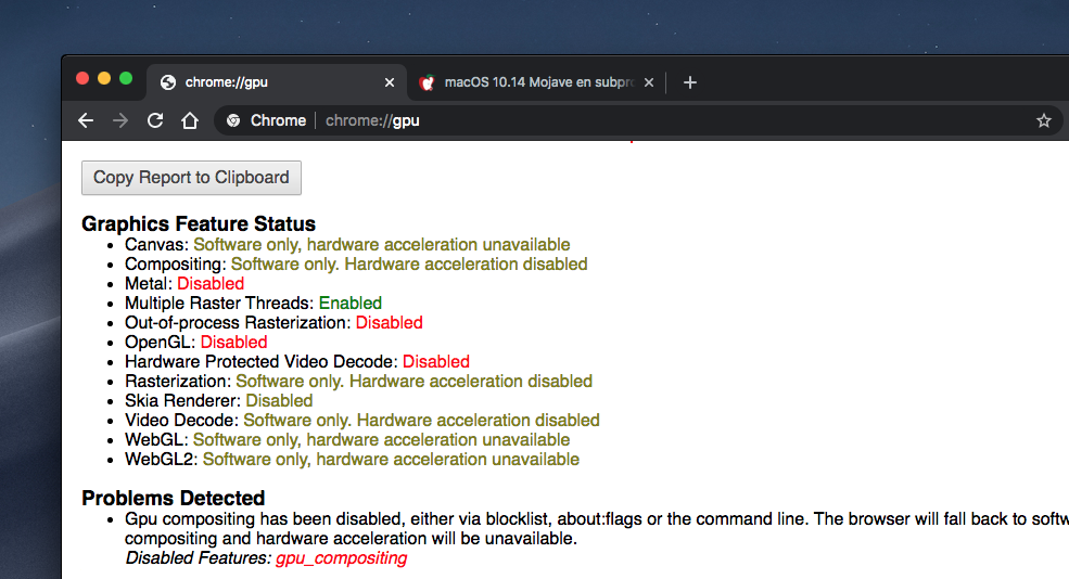

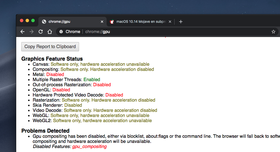

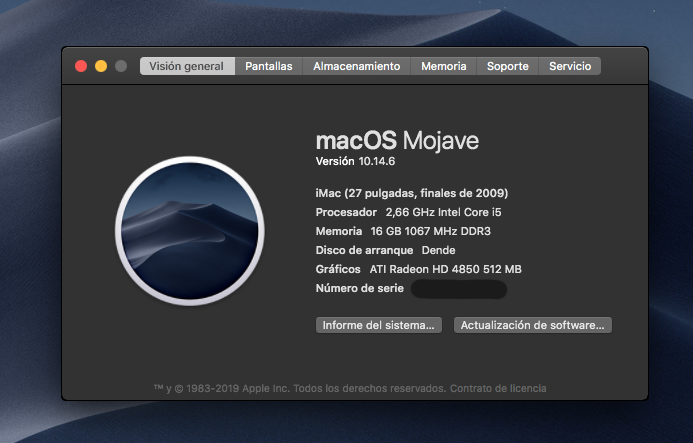

Hi, I own an i5 2009 imac with Mojave installed. It really works very well. Thank you ;)
But I've seen a problem and I don't know if it could be fixed:
The other day, I tried Google Stadia on Chrome and it was unplayable. The mouse was hopping. With smaller machines it didn't happen to me.
I did some research and saw that Chrome doesn't have GPU acceleration. I enclose capture.
Chrome: // gpu
I understand that since my mac does not support Metal, it is emulated via software, right?
Is there a solution to this? Other than changing the graphics card. Any patch? Updating Catalina?
Thanks a lot!!

Hello! It is not a problem of the OS itself. Google Chrome has a blacklist of GPU's, that may be unstable when using hardware acceleration. On all of those GPU's acceleration is disabled. To enable it anyway, you can go to chrome://flags and enable "Override software rendering list" (#ignore-gpu-blocklist). It will activate Chrome's hardware acceleration on blacklisted GPU's. Keep in mind, that you may suffer some graphical glitches, so if Chrome will become really glitchy, you should disable this flag.

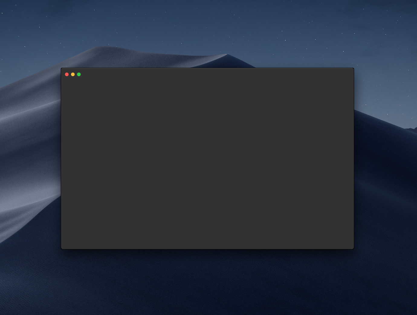

Thanks @NickP0is0n, I tried what you tell me but Chrome is not able to render any screen :(
I think I'll stay that way until I can buy a new mac.
If someone tests what you say and cannot go back to the chrome screen to disable this, they should do it with the console, run chrome by putting --no-experiments

Catalina runs sufficient with the HD4850, METAL mandates a different GPU.

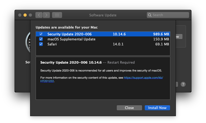

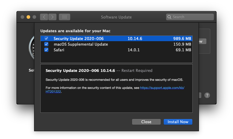

K two: >>The absolute most hassle-free method to apply these Supplemental and Security Updates is to install them with SilentKnight, here - https://eclecticlightdotcom.files.wordpress.com/2020/06/silentknight18.zip Then re-install the required patches from the re-booted USB patcher.
Does this mean SilentKnight will be able to directly install a standalone SecUpd without needing to modify the distribution file, or will it only be able to install what is already available from SU on an APFS formatted volume, as per the usual caveats? Maybe some clarification on what you mean by "hassle-free?"
Reactions: K two

I use it since a while, but there is absolutely no way to install security updates, you can only force update XProtect , Gatekeeper, MRT and TCC. Could you explain how you are processing ?
I just installed MacOS Security Update 2020-007 on my 17" Early 2008 MacBookPro4,1 then rebooted from my Mohave Patcher USB drive and installed the Mojave Patcher post-install AND bkltpatch10.14.2 patches without any issues.
Painless once again. :cool:
