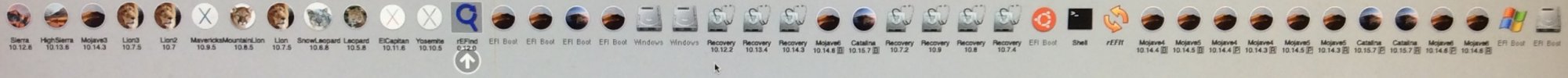

I use the Driver####, DriverOrder method (instead of the rom patch) to load the apfs.efi driver before the Startup Manager on my MacPro3,1.
My Startup Manager has 3 items per APFS macOS (Mojave4, Mojave5, Mojave6, Catalina): System "EFI Boot" (\System\Library\CoreServices\boot.efi), Preboot 🄿 (\_system_uuid_\System\Library\CoreServices\boot.efi), and Recovery 🅁 (\_system_uuid_\boot.efi). Preboot is the one that gets the default .disk_label (I override all the .disk_labels manually with my own .disk_label). Recovery appears only if you bless it manually. The fourth is my custom booter 🄱 using a copy of the dosdude APFS patch (EFI Shell, apfs.efi driver, and startup.nsh script) copied to a separate HFS+ partition. I can boot Catalina with the System, Preboot, or Booter items.
The picture shows three more "EFI Boot" options. One is from Ubuntu boot loader in an EFI partition (\EFI\BOOT\BOOTX64.EFI). The other two are from my Windows 7 and Windows 10 partitions (\EFI\Boot\bootx64.efi). They appear because I also loaded the ntfs.efi driver for this picture (I would not actually try to boot Windows with the EFI loader because it won't work or it would cause problems - so normally I do not load the ntfs.efi driver). You can add a volume icon to any of these but adding a .disk_label does not remove the "EFI Boot". I think "EFI Boot" can only be replaced on volumes that can be blessed (HFS+ and some APFS volumes). Newer Macs may use .disk_label on partitions that cannot be blessed (such as FAT partitions on my Mac mini 2018).
The Recovery (one Recovery per macOS), Shell, and rEFIt items are blessed HFS+ partitions.
A Windows item appears for any disk that has boot code in the MBR. I have two such disks with multiple Windows partitions per disk. Booting one of these items causes the CSM to be loaded (BIOS booting instead of EFI booting), then the MBR boot code is executed which executes the PBR boot code of the partition that is marked as active in the MBR.

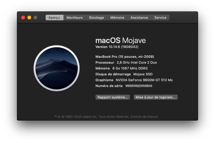

Hi all,
Successfully installed SecUpd2020-006Mojave (18G6042) on MBP5,3.
Here is the download link on Apple servers:
This time, no need to modify the distribution file (it is not present in the .pkg)
In addition, installing this update does not break appleGVA, softwareupdate.framework, HIToolbox and the Siri waveform continues to work (for those who had modified Siri.app and SiriUI.framework)
The only requirement after installing this update is to reboot on USB Key and re-patch with Dosdude1 Patcher with cache rebuild.

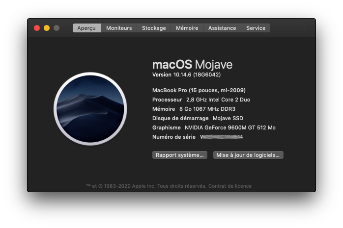

Hi all,

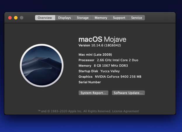

How is the performance on Mojave? My MBP mid 2009 does not handle Catalina very well. It handled El Capitan much better.
Catalina is slightly more nimble than Mojave on this Mini3,1. YMMV
32bit, HFS+ and Firewire booting remain intact in Mojave, however. Some trade-offs to consider? If updating beyond Mojave, APFS is the only option.
