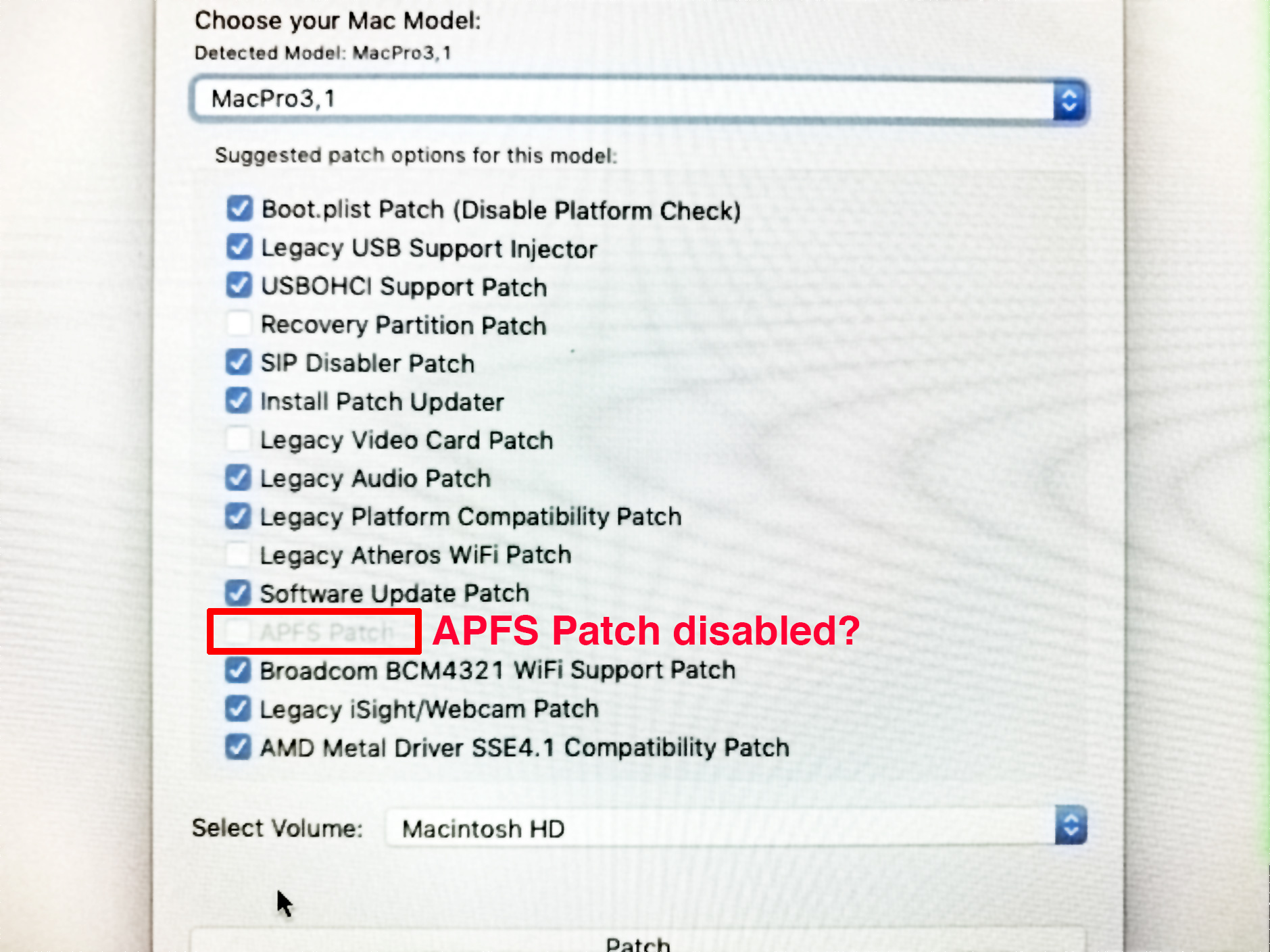

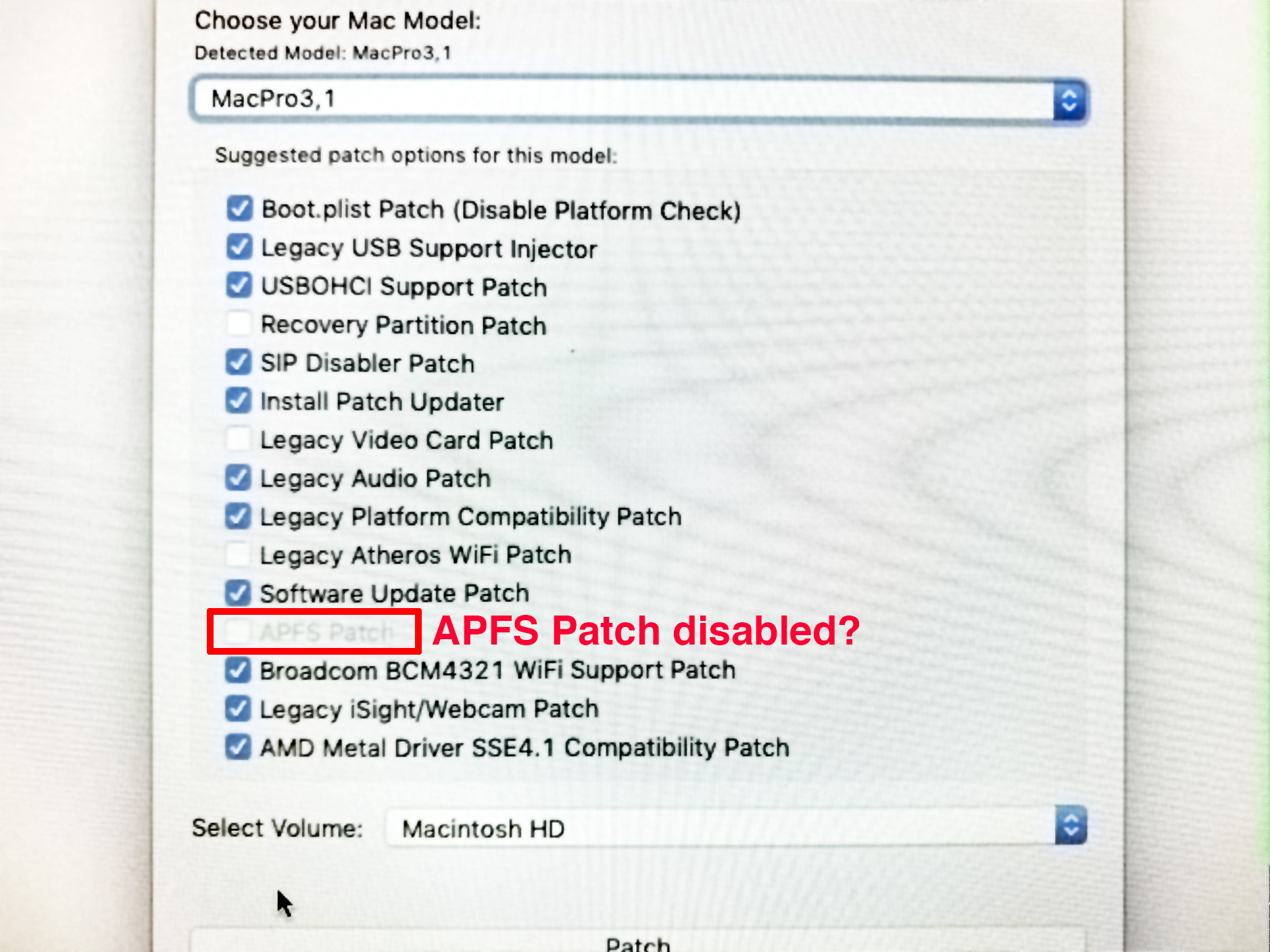

I already have DD patcher v.1.3.7 installed, but the APFS patch was never installed (I was never prompted to install it so I didn't even know it was included). Does it only get installed if the drive has already been converted to AFPS? I installed Mojave Patcher on my MacPro 3,1 which previously was running El Capitan, so the the boot drive was still HFS+. Are you saying that I need to convert the drive to APFS first and then reinstall the MojavePatcher and things should work automatically without doing the ROM patcher? I feel like the documentation could be improved on this step.
Thanks in advance!
Boot back into the v.1.3.7 patcher and under the install patches option, the bottom option, within those selections is APFS Patch. I've never installed the patch after-the-fact but it should work. You'll know it stuck if booting back into Mojave and a scrolling screen of characters appears.
Weird. I did what you suggested, but APFS Patch is greyed out for me. Any ideas?

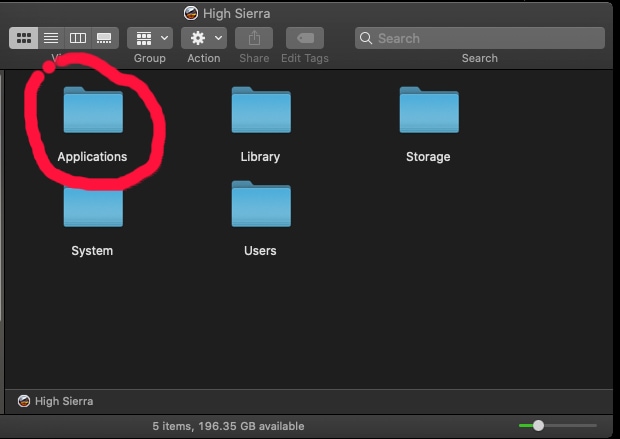

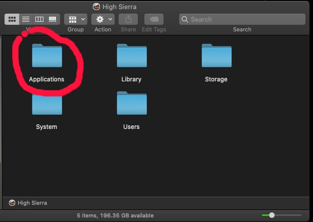

You can't find this? The Utilities ƒ is in there.
K two
macrumors 68020
Dec 6, 2018
2,314
3,187
North America
I only have a Utilities folder in there, but not a Utilities f. The patcher updater in my Utilities folder is the one for High Sierra, which is the OS my Mini is currently running.
ƒ is shorthand for folder. You found it. Run the v.1.3.7 patcher from there. The macOS installer can remain in the D/L ƒ. ?
Is Macintosh HD the volume that contains Mojave?
Instead of the APFS Patch, try the Driver#### method to load the APFS driver.

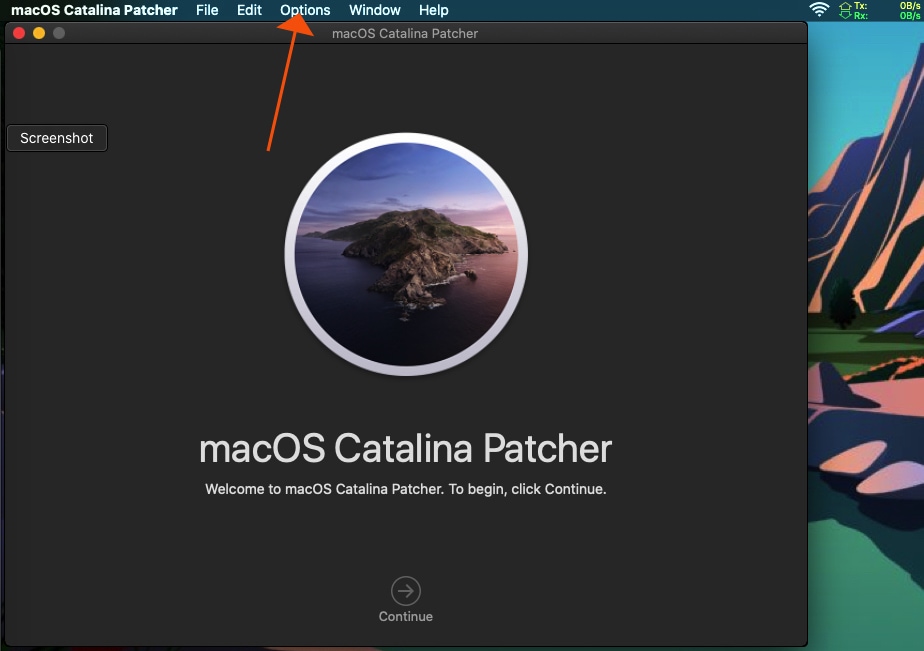

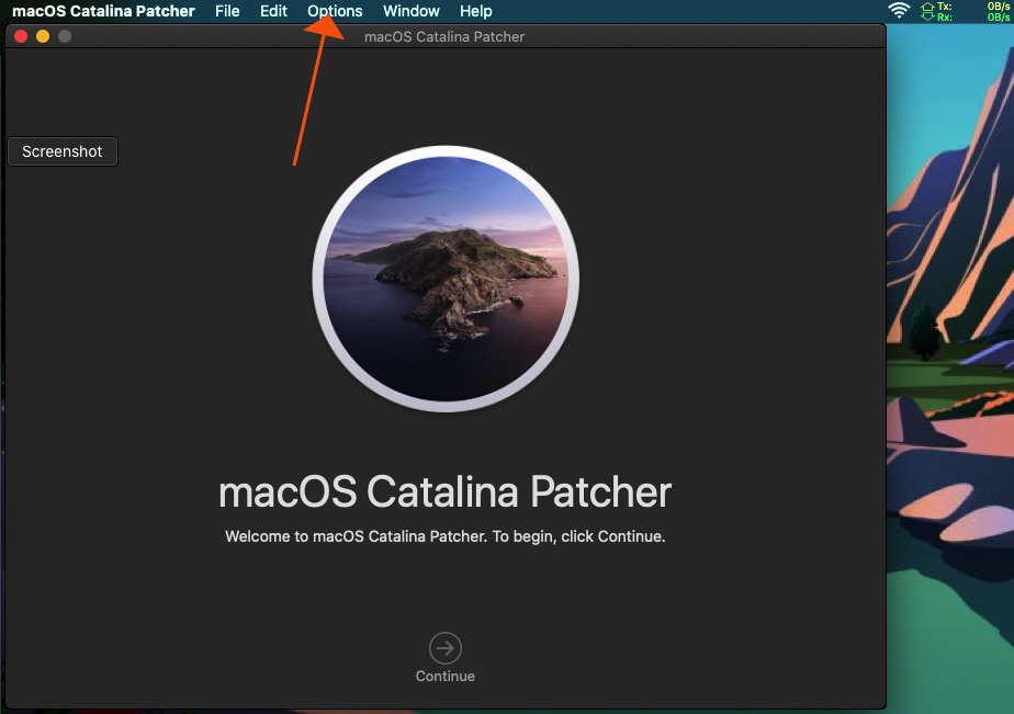

Under Options was Disable APFS Booter checked? If so, the APFS Patch will not be installed. View attachment 1720024
I'm using Mojave Patcher, not Cataline Patcher. There is no Options menu under Mojave Patcher, just "Utilities Launcher". When I click "continue" under the MacOS window, there are the following menu items:
"macOS Installer | File | Edit | Utilities | Window"
Under the Utilities menu, there is no "Disable APFS Booter" item.
¯\_(ツ)_/¯
Reactions: K two
Yes, Macintosh HD is the volume that contains the patched Mojave. I quickly looked over that thread you linked to and unfortunately it went way over my head. I'll try to read it over again when I'm not half-asleep to see if some of it sinks in ;) Thanks.
