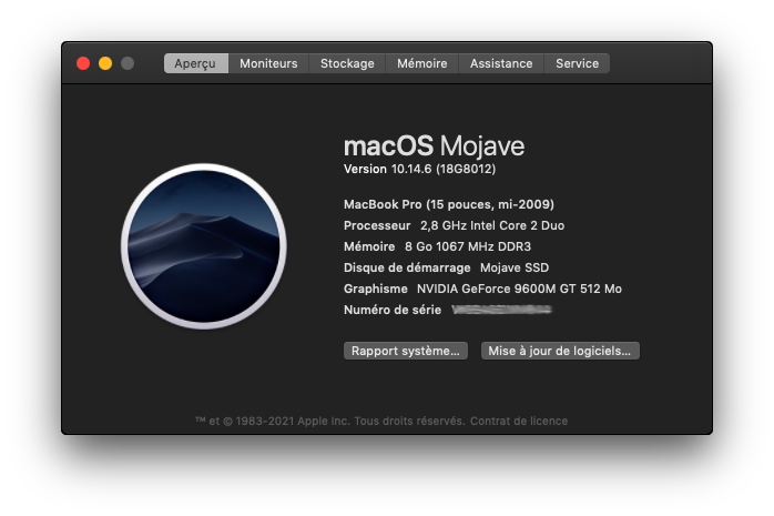

Successfully installed SecUpd2021-001Mojave (18G8012) on MBP5,3.

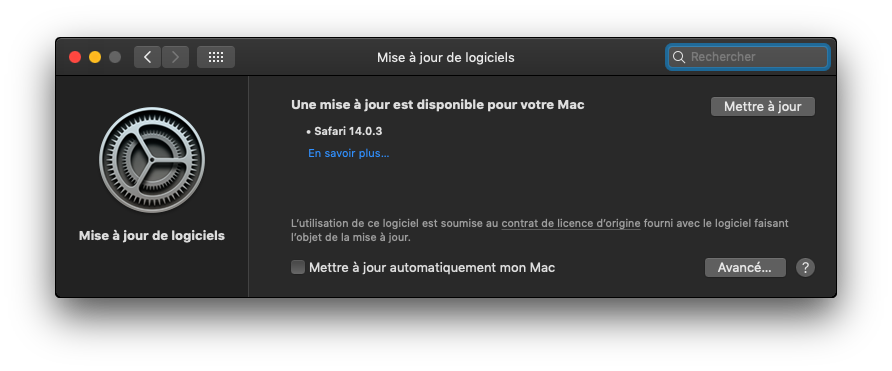

After, installing this update, needed reboot on USB Key and re-patch with Dosdude1 Patcher with cache rebuild and reinstall appleGVA.framework, softwareupdate.framework, HIToolbox, Siri.app and SiriUI.framework (for Siri waveform)
As for the other times, downgrading SoftwareUpdate.framework does not prevent receiving updates (like the one for Safari 14.0.3 for example, see screenshot below) but will prevent the proposal of major updates (Catalina and Big Sur) with the combined use of:

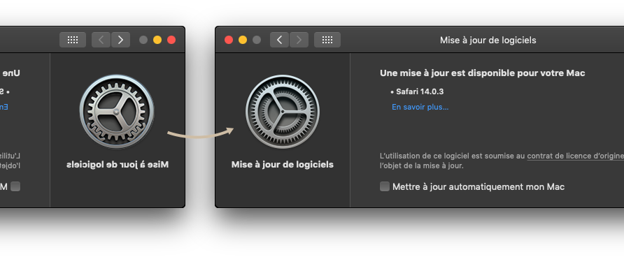

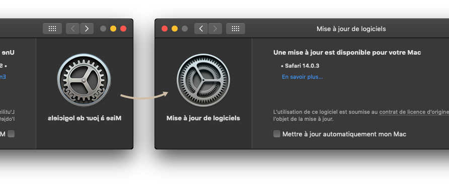

Hi @macinfo
System Preferences icon is PrefApp.icns file located in /System/Applications/System Preferences.app/Contents/Resources/
But for SoftwareUpdate it's in /S/L/SoftwareUpdate.prefpane
There are 2 files to replace ( SoftwareUpdate.icns and SoftwareUpdatePreferencePaneIcon.tiff ) in /System/Library/PreferencePanes/SoftwareUpdate.prefpane/Contents/Resources/
I extracted SoftwareUpdate.icns from Big Sur but I had to create SoftwareUpdatePreferencePaneIcon.tiff because it contains 2 formats (80 × 80 pixels 144 pixels/inch and 40 × 40 pixels 72 pixels/inch)
I enclose a SoftwareUpdate.icns.zip archive containing the 2 files for SoftwareUpdate.prefpane, and another PrefApp.icns.zip archive containing the icon for System Preferences.app
After replacing these files you have to correct the permissions with Terminal:

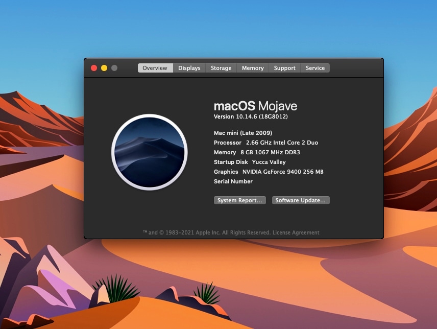

So far, Build 18G8012 performs w/o issues. Very stable on Mini3,1 and iMac10,2. If APFS can update w/SilentKnight.
