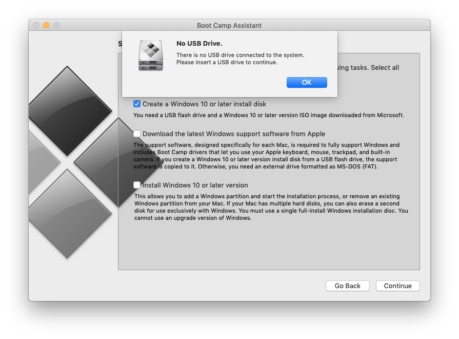

Early 2011 MBP (8,1) running Mojave 10.14.6 trying to install Windows via Boot Camp and keep getting this error. I have tried several USB drive and they all show up fine on the desktop and I can open them, it's just that Boot Camp doesn't see them. Am I doing something wrong?
