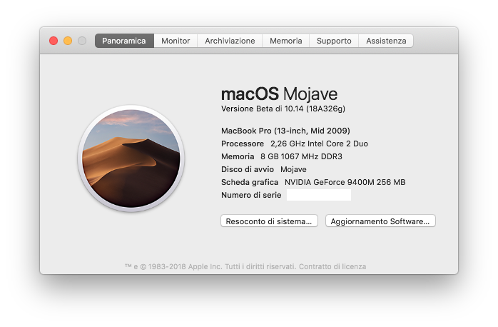

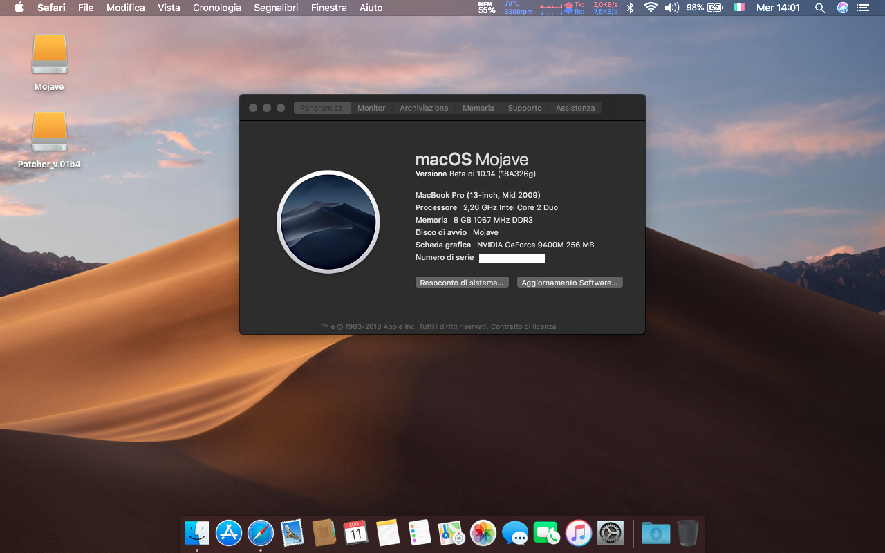

On the mac book pro 13 (mid 2009) everything OK .... good graphics acceleration.
thank you .......
I do not know it seems to me that there is some variation on the background colors ..... at the "normal" screen level, in black having no references I think they are so .......
