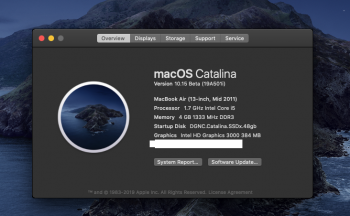

Successfully updated to the latest dev beta 3 using @dosdude1's macOS Catalina Patcher 1.0b6
Steps followed:
  • Before update, I installed DeveloperBetaAccess Utility thinking OTA SoftwareUpdate will work since the new version is a dev beta. I guess my assumption was wrong.
  • So I used @dosdude1's patcher to download the latest beta version.
  • Re-created my external USB again using the above tool to patch the just downloaded version.
  • Booted to the USB and did a reinstall Mac OS.
  • Rebooted to the USB again and ran the post install patches that were applicable.
  • Rebooted to the SSD partition where beta 3 was installed and patched.
Working well, at least so far so good.
Thanks again to @dosdude1 and others who contributed.
