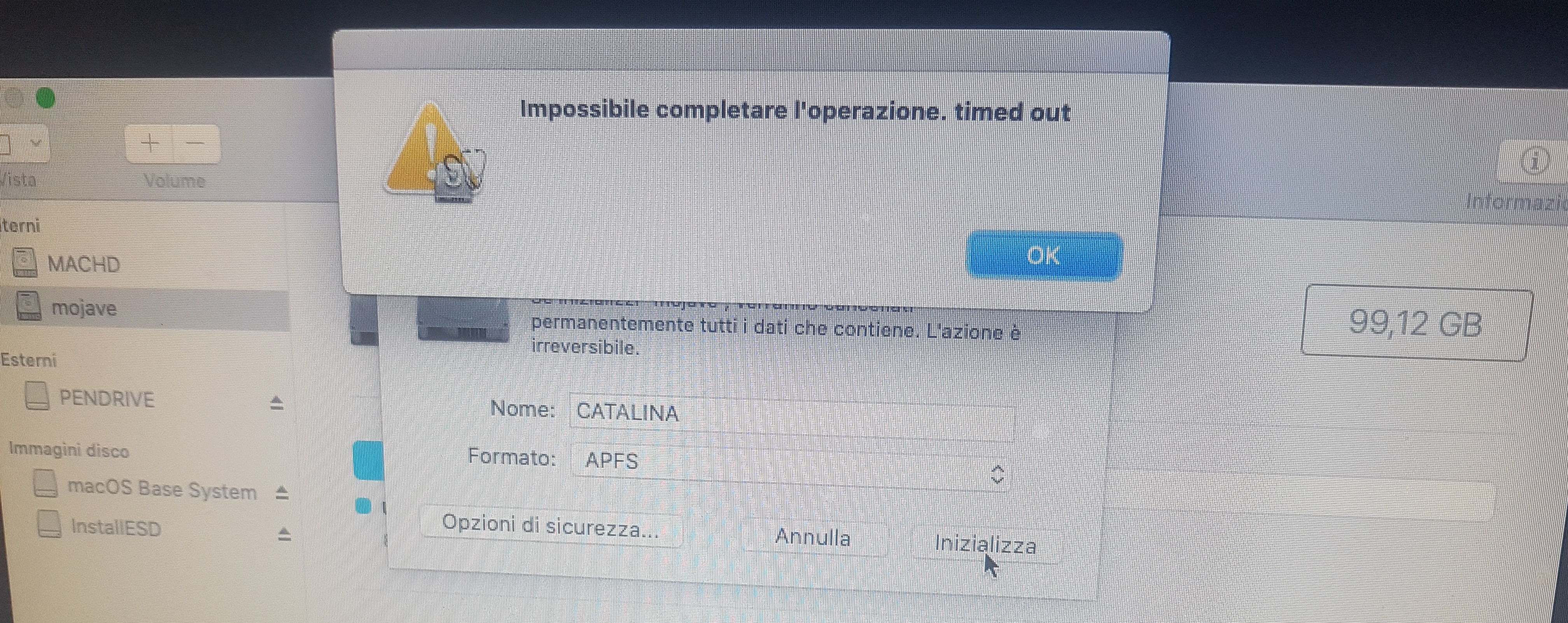

when I try to use disk utility from inside the bootable usb to format in APFS the partition it keeps display a warning telling me that is "impossible to complete the operation,time out" (sorry for the bad translation, it's in Italian)

If you are trying to erase a Mojave HFS+ volume in APFS, then you can also install Catalina directly over an HFS+ formatted, since that's only the stage1 installer (macOS Install Data) that can use an HFS+ as temporary installer target, then the stage2 installer at 99% will convert automatically your HFS+ in APFS, adding the APFS Data partition too.

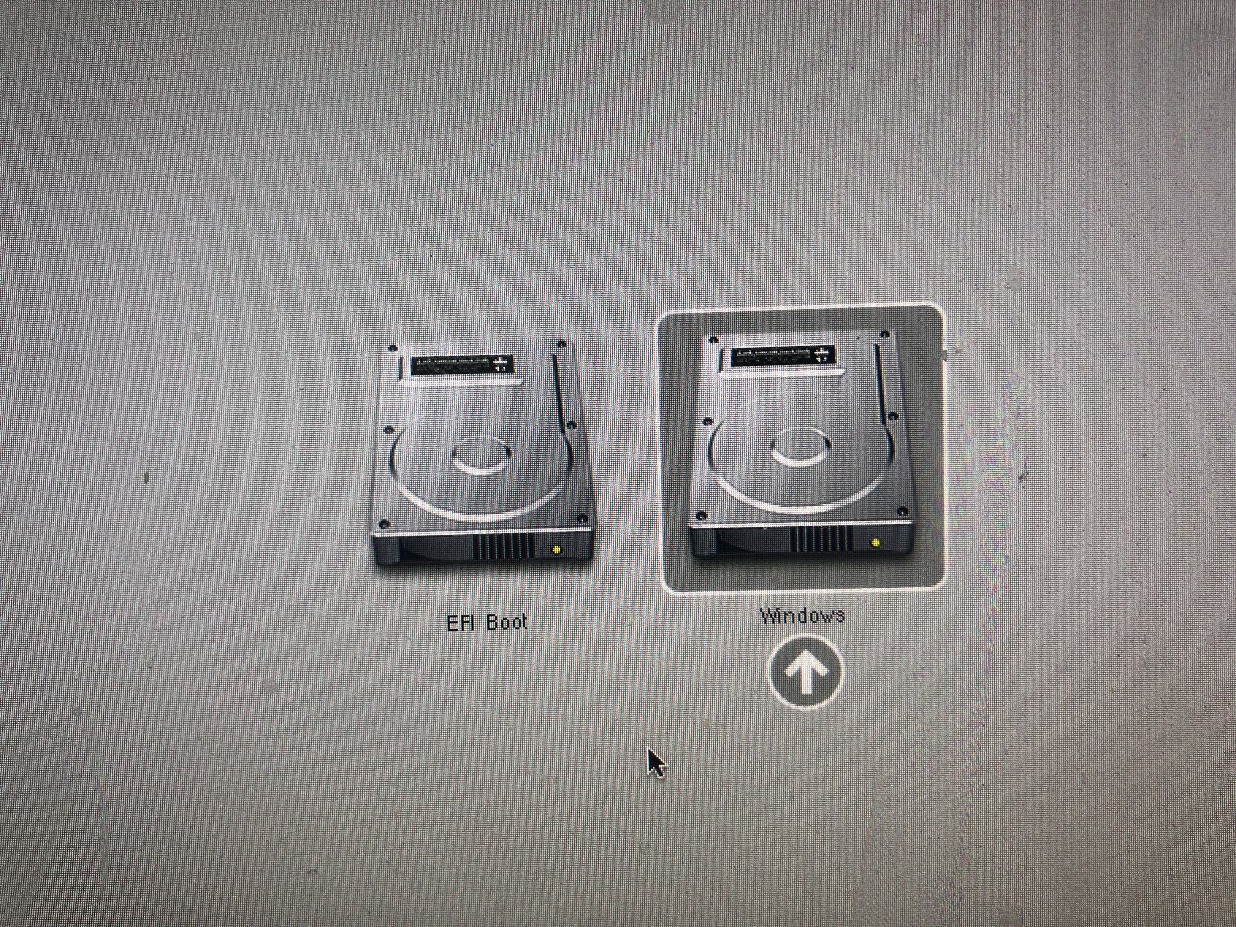

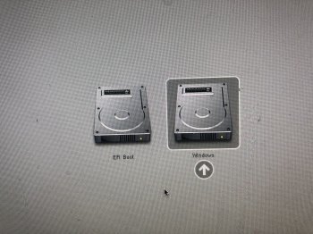

Just one thing, in case it is of interest. When I applied the APFS Rom Patcher in my mac Pro 3.1, and moved my HFS Mojave Hard drive to APFS, I don´t get a buch of EFI partitions when boot pressing Alt. Just one EFI parition. When selected, boots Mojave APFS perfectly.
if I undertand correctly it doing so take me back to the first problem which dosdude responded, i tried to install on hfs+ but the installer stops right at the middle of the bar with 3 minutes left, it never continue, so it never convert the partition in apfs, the problem is that in my main partition i have el capitan due to my imac 8,1 last supported macos release, so i cannot use the utility disk from there beacuse it doesn't have the apfs option.
Oh right, to format in APFS you need at least Sierra 10.12.6 or better HighSierra installed .
You may just have to do a clean install on a second partition or drive.
Simply copying a HFS volume onto a APFS volume won't create the normal APFS boot partitions. You should see...

The fact that you don't have an icon under the actual volume name for the APFS volume for the APFS ROM patched MacPro 3,1's option boot selector is a huge red flag.

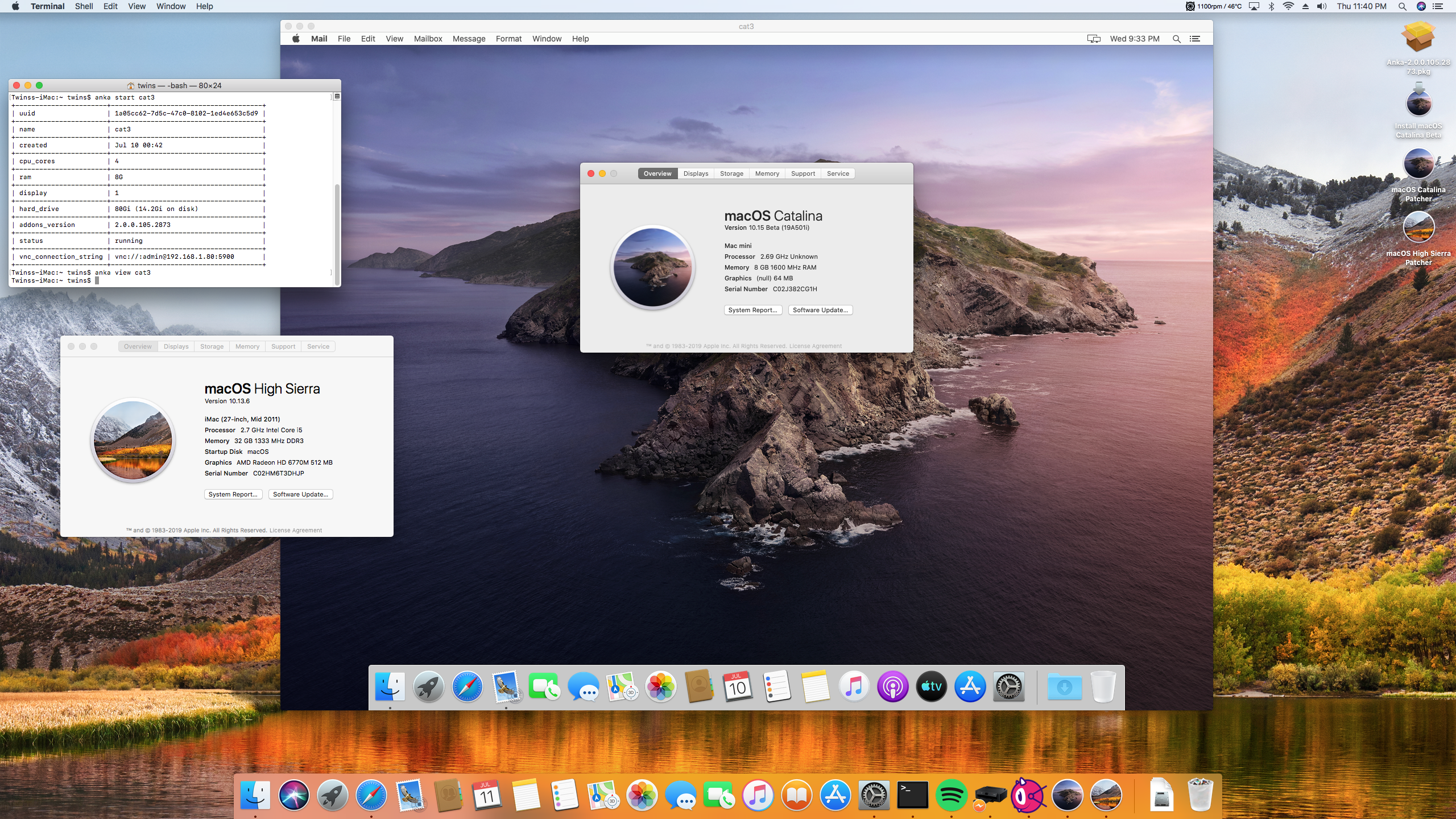

I've been messing around with Catalina on my iMac 2011 where my host is High Sierra and my client VM is Catalina Beta 3.
One of it's best features is live resolution where it also snaps however you scale the window or go full screen. The vm is very responsive even when on a Hard Drive instead of an SSD.
I beefed up my 27" iMac 12,1 to 32GB so I could handle any type I through at it. Anka Build does not support Metal yet and my correct host doesn't even have Metal right now (though I am thinking about getting a Thunderbolt eGPU), but Anka is super responsive. Anka has a 30 day trial, if anyone would like another way to use Catalina or test other macOS, I highly recommend it.
