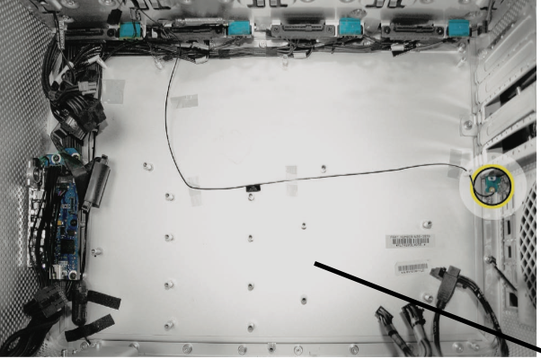

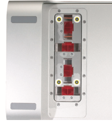

The front panel antenna assembly looks interesting. It is hard to tell from that photograph if the small metallic modules above the mounting points are the actual antennas. If so, it kinda looks like the antenna assembly has a fourth unused antenna, no?

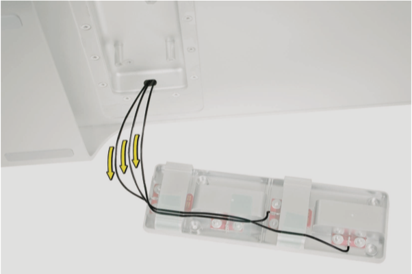

Here is the other side of the antenna board. Looks to have 4 elements with 3 connected.
Interesting. Looks like it's on the underside.
Makes sense to only have 3 because that is all that's used.
Have you've tried connecting remaining one?
No, I have used the standard connections. 3 for wifi and the rear antenna board for BT. Not heard of anyone using the possible 4 antenna towards the front.
The replacement iMac WiFi & BT card has 4 antenna hook ups. 3 WiFi, 1 BT.
[doublepost=1562855751][/doublepost]
The mp3.1 has the 3 Wi-Fi aerials under the plastic panel at the front of the machine. Look underneath. It appears not to really matter the order these are connected. The BT aerial is at the rear of the Mac near the fan outlet. This connects to J3 on the BCM94360CD.
USB power for the BT part is supplied through the mini pcie connector on the mp3.1. For the 4.1/5.1 the USB power connector needs to be made from the adapter to the connector on the main board.
This card works well under both Mojave and Catalina in a mp3.1. Much better than the original where the BT was always a bit flaky. Wifi presently connected at 1053 Mbps so pretty good.

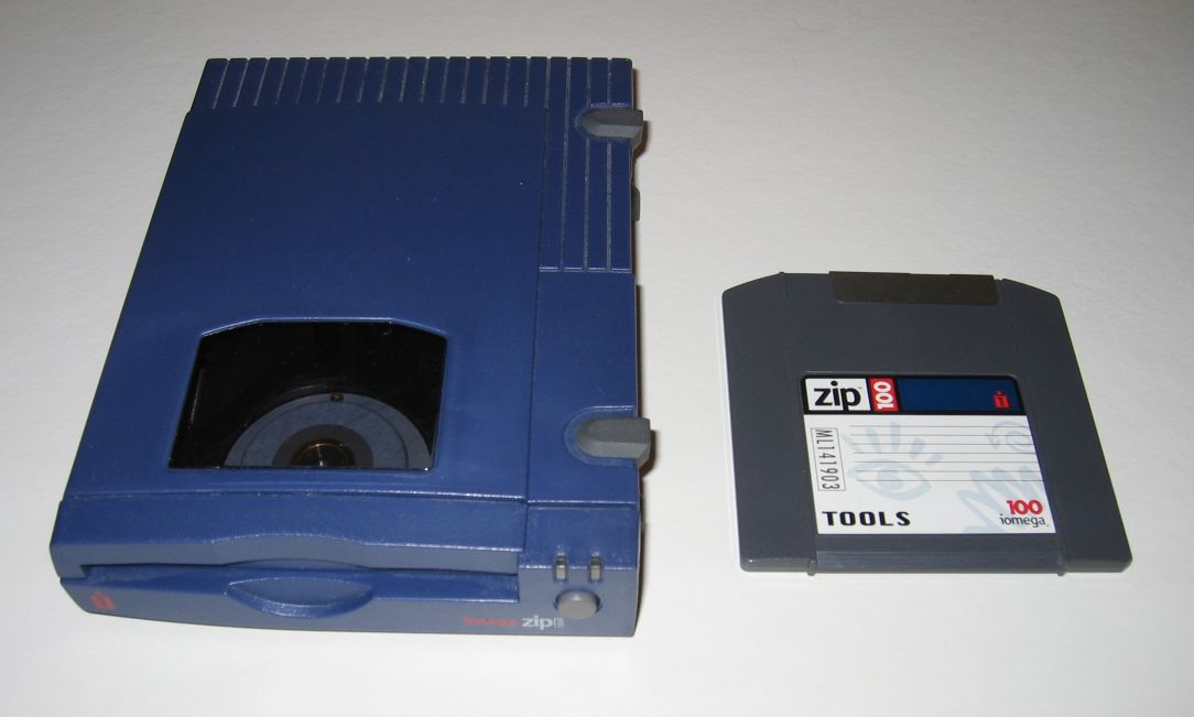

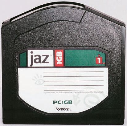

I guess you mean Iomega ZIP- and JAZ-disks.
ZIP disks were in 100, 250 and 750MB
JAZ were in 1 and 2 GB
Still have them in my Amiga A4000T ;)
Yup those are the ones. :)
