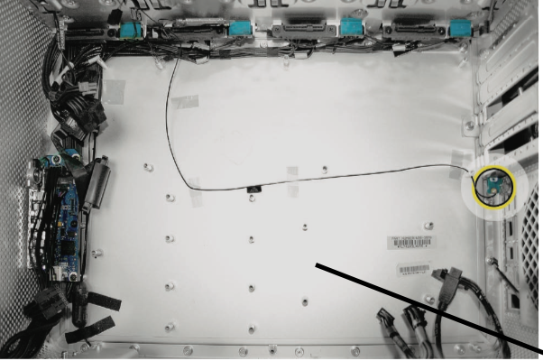

The antennas seem to be located differently since some cMP 1,1 have a poor Bluetooth performance which can be fixed by switching the antenna cables. Maybe they mislabeled some batches during production, I don’t know.

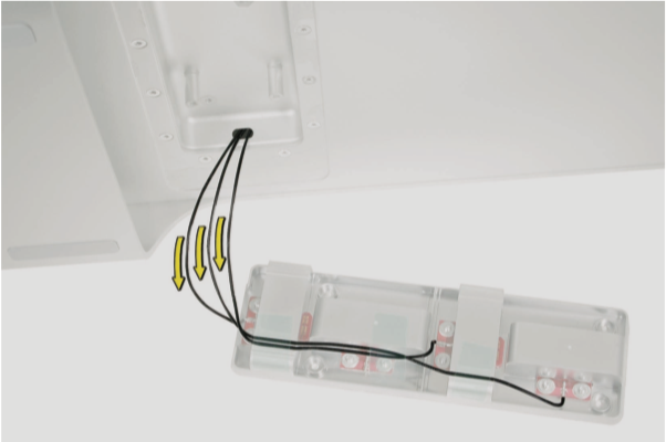

The mp3.1 has the 3 Wi-Fi aerials under the plastic panel at the front of the machine. Look underneath. It appears not to really matter the order these are connected. The BT aerial is at the rear of the Mac near the fan outlet. This connects to J3 on the BCM94360CD.
USB power for the BT part is supplied through the mini pcie connector on the mp3.1. For the 4.1/5.1 the USB power connector needs to be made from the adapter to the connector on the main board.
This card works well under both Mojave and Catalina in a mp3.1. Much better than the original where the BT was always a bit flaky. Wifi presently connected at 1053 Mbps so pretty good.
The front panel antenna assembly looks interesting. It is hard to tell from that photograph if the small metallic modules above the mounting points are the actual antennas. If so, it kinda looks like the antenna assembly has a fourth unused antenna, no?
