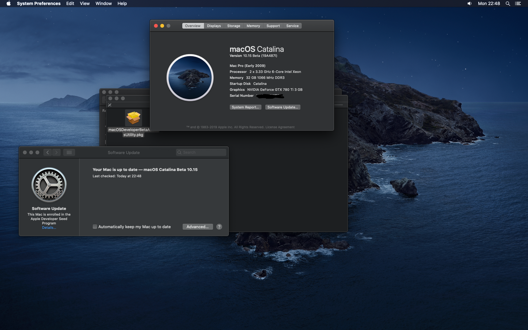

Is it necessary to re-create an updated installer to update to beta 3?
Software update is saying I'm on the latest release - I'm not. It's still on beta 2. I'd just prefer not to take the 3 hours of downloading\creating and installing over the slow way if I can help it.

It still says I'm up to date.
I've had this happen on officially supported macs on official releases too. Has anyone else been able to upgrade in this matter?

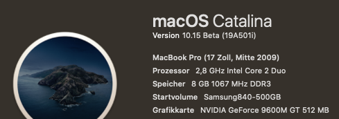

Successful installation on my MBP5,2 (MBP5,2 17" 2.8GHz mid 2009, 8GB, APFS ROM patch applied).
Cloned with CCC the very stable 10.14.5 from my internal SSD to an SSD on USB (Samsung 840 500GB).
Used dosdude's Catalina patcher 1.0b7 to download latest Catalina (10.15.0b3, version 15.0.17) and prepare a USB installer with it. Used this to install Catalina on the external SSD.
Running with the 9600 GPU all the time.
Success with no extra manual steps other than rebooting twice (to the installer on the external SSD to let it complete its work, then to Catalina on the external SSD). All user data, settings etc in place!
Amazing how easy that was for me average user. I'm very grateful to dosdude and all contributors.
(as reported elsewhere in this thread Photos keeps crashing with an illegal instruction, after having converted the existing photos library. This is about the only thing which keeps me from using Catalina more regularly for now. But no KPs, no other problems observed in the first 24h of running).

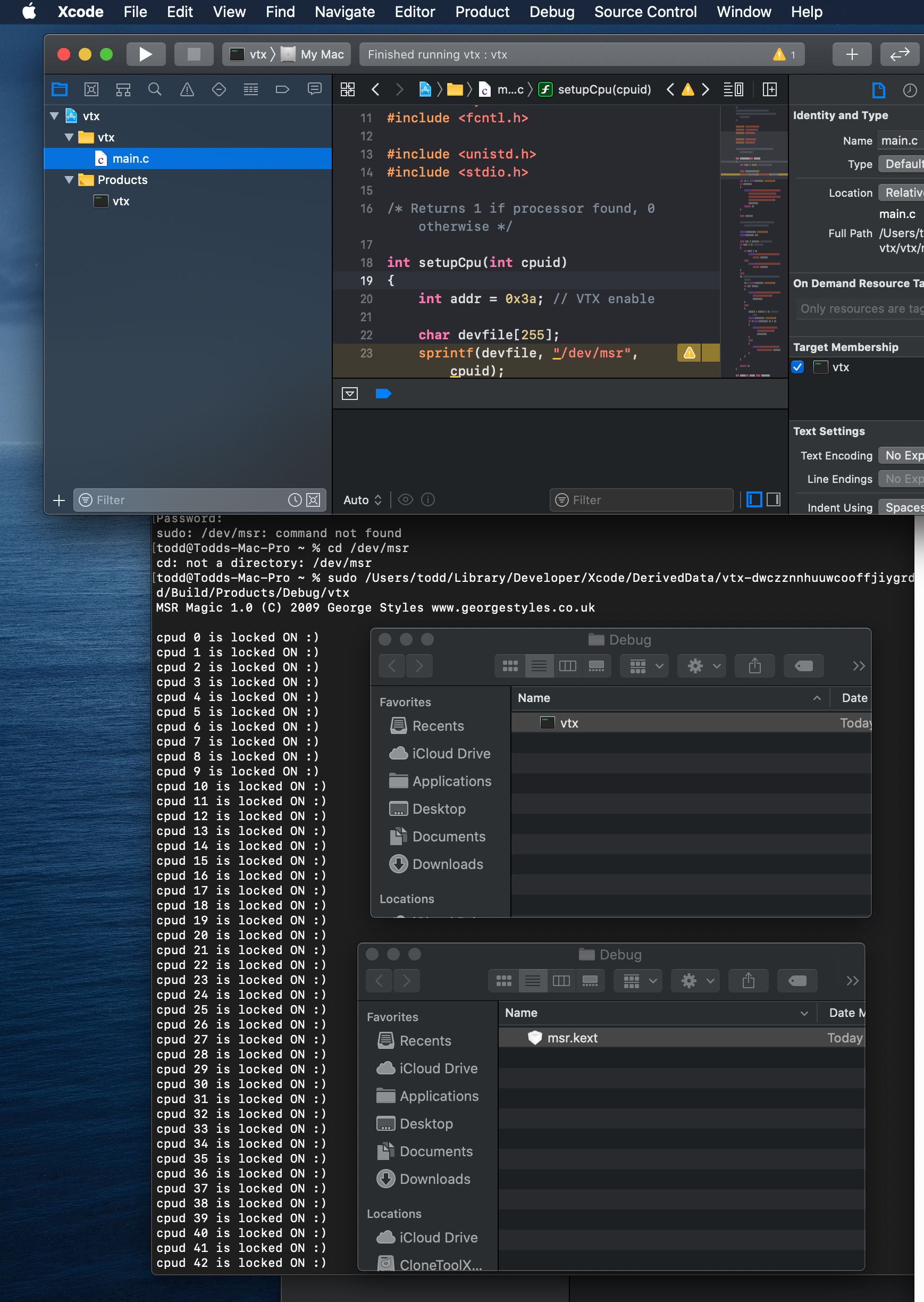

VT-x is enabled by default on any Mac with a CPU that supports it.
According to 3 sources that I read. Apple turned it off in the Mac Pro 2008's EFI. Apple released an EFI Firmware update for the 2008 that is supposed to fix it. I don't think I can install it because of the APFS FW update.
I was able to get MSR Magic to compile on Mac. I also found a msr.kext that can be loaded manually.
I had to make a slight modification to the msr device path in MSR Magic, recompiled and ran it.
It's saying it locked ON.

It's very possible they turned off, for example on PCs often VT-x is disabled by default in BIOS/UEFI , but VT-x is easily accessible and less locked than EFI Mac.

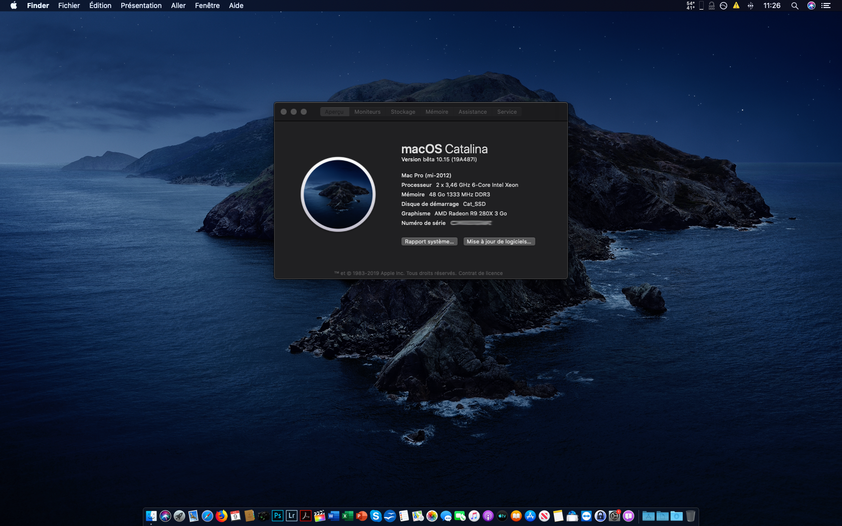

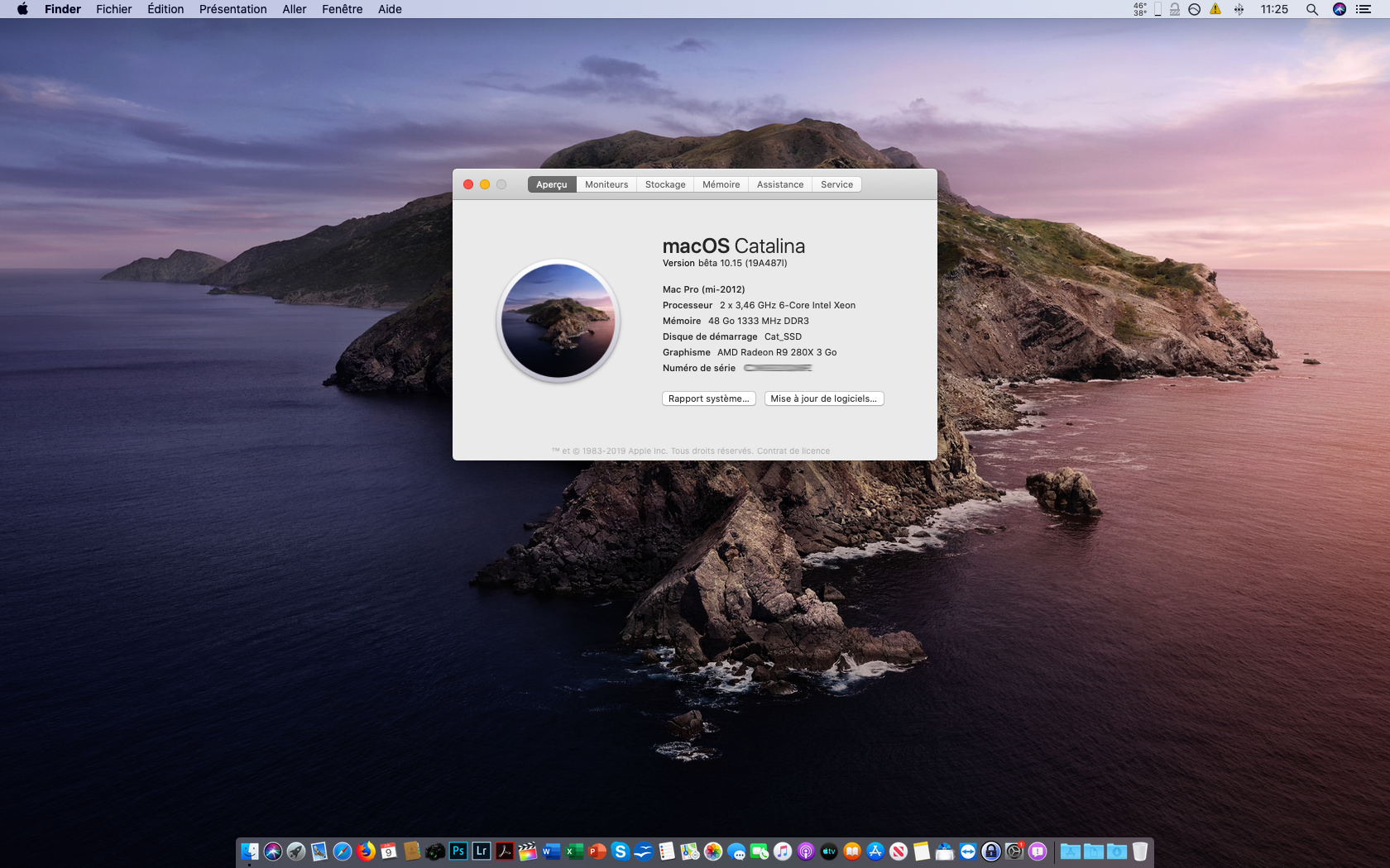

Hi everybody
I finally found a little time to install Catalina on MP5,1 (yes I finally exchanged my old MP2,1 by a 5,1).
I started by formatting APFS a SSD Samsung SM951 NVMe 256GB
I then cloned my Mojave NVMe System SSD
I installed Catalina 19A487l with a USB stick prepared by @dosdude1 Patchcher v1.0b6
After 25 minutes Catalina booted like a charm and without any patches, I have sound, Wifi, Bluetooth, Map.app do not crash, I do not Drift screensaver (but I think it's normal because I I thought I read that he appeared with DP3)
After more than 2 hours of tests of all kinds it does not seem bad to me apart from the many bugs
Of course Lilu.kext integrating Innie.kext (for Mojave) does not work anymore and my 2 SSD NVMe are no longer seen as internal but as an external disk ... So I'll have to wait a bit
The linux article on the 2008's says Apple picked the forth option. I can't confirm if it is turning on the Mac. I did see the msr.kext load. And the MSR Magic seemed to have run. I did some checks but could not confirm VT-x is enabled. However Snow Leopard seemed to run really good.
I may bite the bullet and install Ubuntu linux and test out QEMU more thoroughly. Foxlet has a pretty good guide; may have a better time turning on VT-x there. This is just something I started toying with. My CPU may be too old. On the 3,1 I can get VMware Fusion 8 to run and does a pretty good job. I wish I could install Apple's 2008 Firmware fix, but it's not a deal break as you mentioned. Parallels which is ok (too slow for me). If anything, I learned how to load a kext manually after boot up. Compile a linux C app on MacOS X. And I know which of my assets can run things like QEMU and Anka Build. Also have 12 portions on my Mac to test CloneToolX out natively.
View attachment 847358[/QUOTiE]
That part usually needs to be patched on an unsupported Mac. Plus if you can download them there, it won’t let you unless there is a patch for it as it will say something like no updates available or this update is not for your Mac.
Since these are beta’s probably best to do a clean install and then migrate your data volume over. I don’t get too locked into any dev build and stay as agile as I can until it hits GM and then do updates sparingly.
