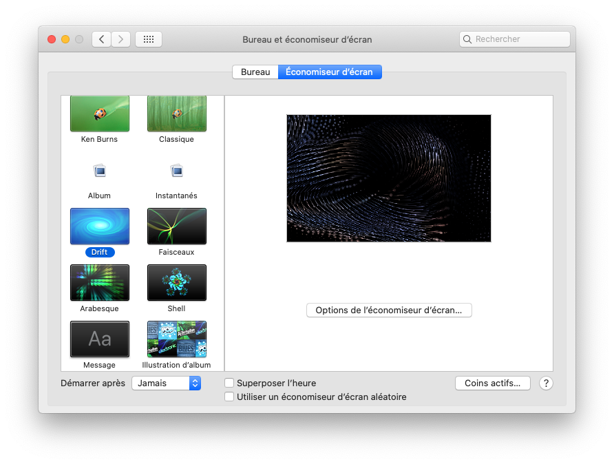

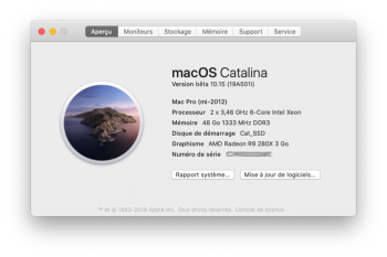

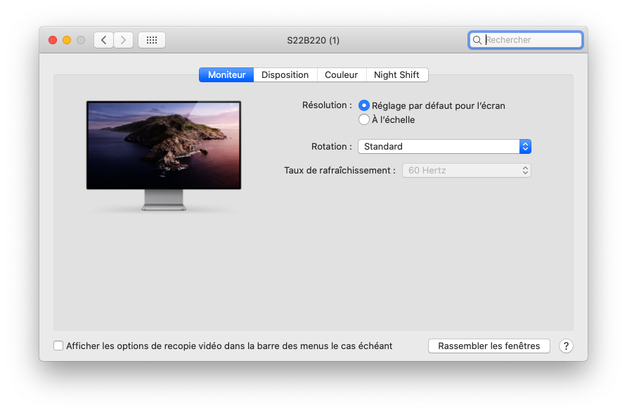

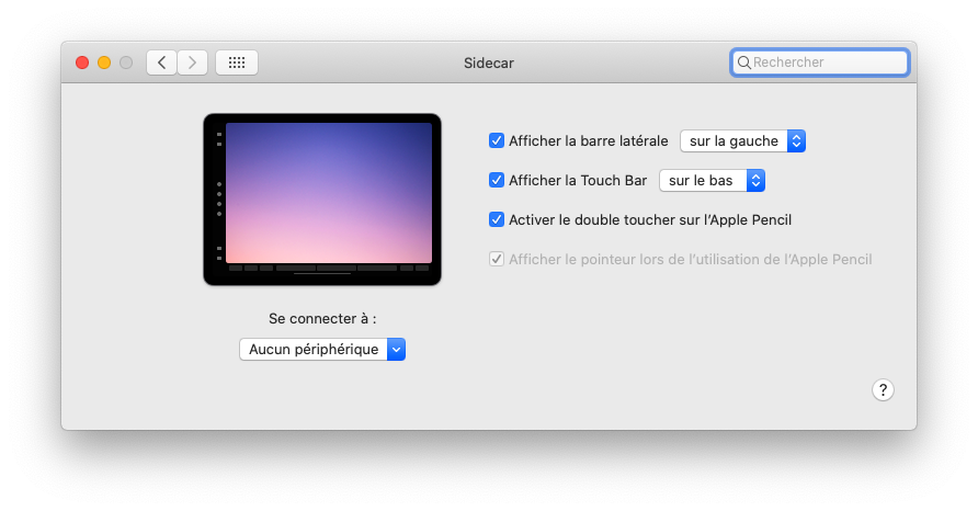

Hi everybody

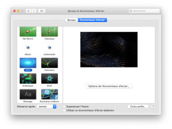

Following my post #2820 I updated beta2 to beta3 19A501i with @dosdude1 patch v1.0b7 and still without any patches everything seems to work fine. I have Sidecar (I have no device under iOS 13 to test ...), Drift Screensaver works and I got the tab NightShift by replacing "CoreBrightness.framework"
Capture d’écran 2019-07-09 à 18.48.00.png Capture d’écran 2019-07-09 à 17.25.49.png Capture d’écran 2019-07-09 à 18.54.02.png Capture d’écran 2019-07-09 à 17.55.55.png

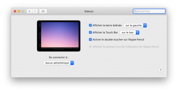

Hi everybody
View attachment 847438 View attachment 847439 View attachment 847440 View attachment 847441
Installed the latest Catalina beta on an iMac8,1 as mentioned on page 113.
Installed IoS 13 beta on an iPad Pro (9.7 inch).
Installation went without problems and the systems can connect.
The iPad keeps complaining about a bad connection and brings the message "The session will resume automatically when the connection improves."

Whoa, cool. That's sidecar working on a non-Metal GPU then, right? Or do you mean that the bad connection message appears always?

Graphics card is ATI Radeon HD 2600 Pro 256 MB, which is definitely non-Metal. Restarted the iMac and iPad, but the bad connection message still appeared. I suspect a local problem, such as a poor quality Lighting cable, but don't really know.

Aw, darn. I thought it was just an occasional thing that popped up.
It's quite likely that "bad connection" is just what the software displays when it really means "can't create a Metal device/talk to the iPad at all", sadly. Sidecar probably relies on new features in CoreDisplay/SkyLight which won't work on non-Metal systems with my sketchy acceleration patch. That's why I was so surprised when I thought you had it mostly working.
We need a better acceleration solution. Both for this, accessibility features, Photos, Siri, graphical glitches and just general stability. My wrappers were never intended to be the final answer.

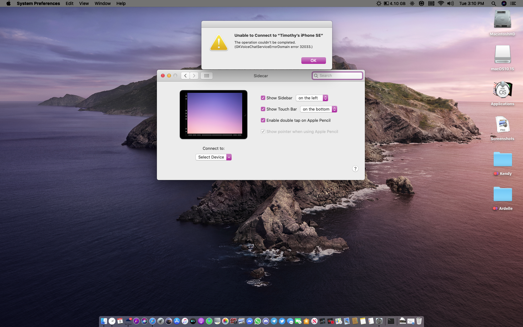

This is what it says when I connect my iPhone SE to my iMac then the screen on my iPhone SE goes black
