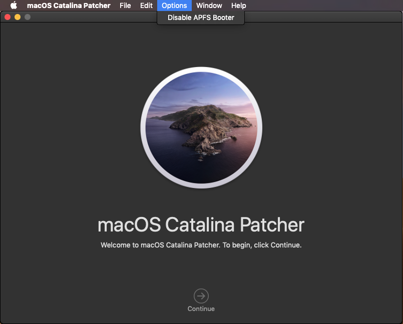

Just released another update to Catalina Patcher. This version now includes an option to prevent automatic installation of the software APFS booter, and fixes an issue where the kextcache may not get rebuilt when post-install patches are applied automatically.
