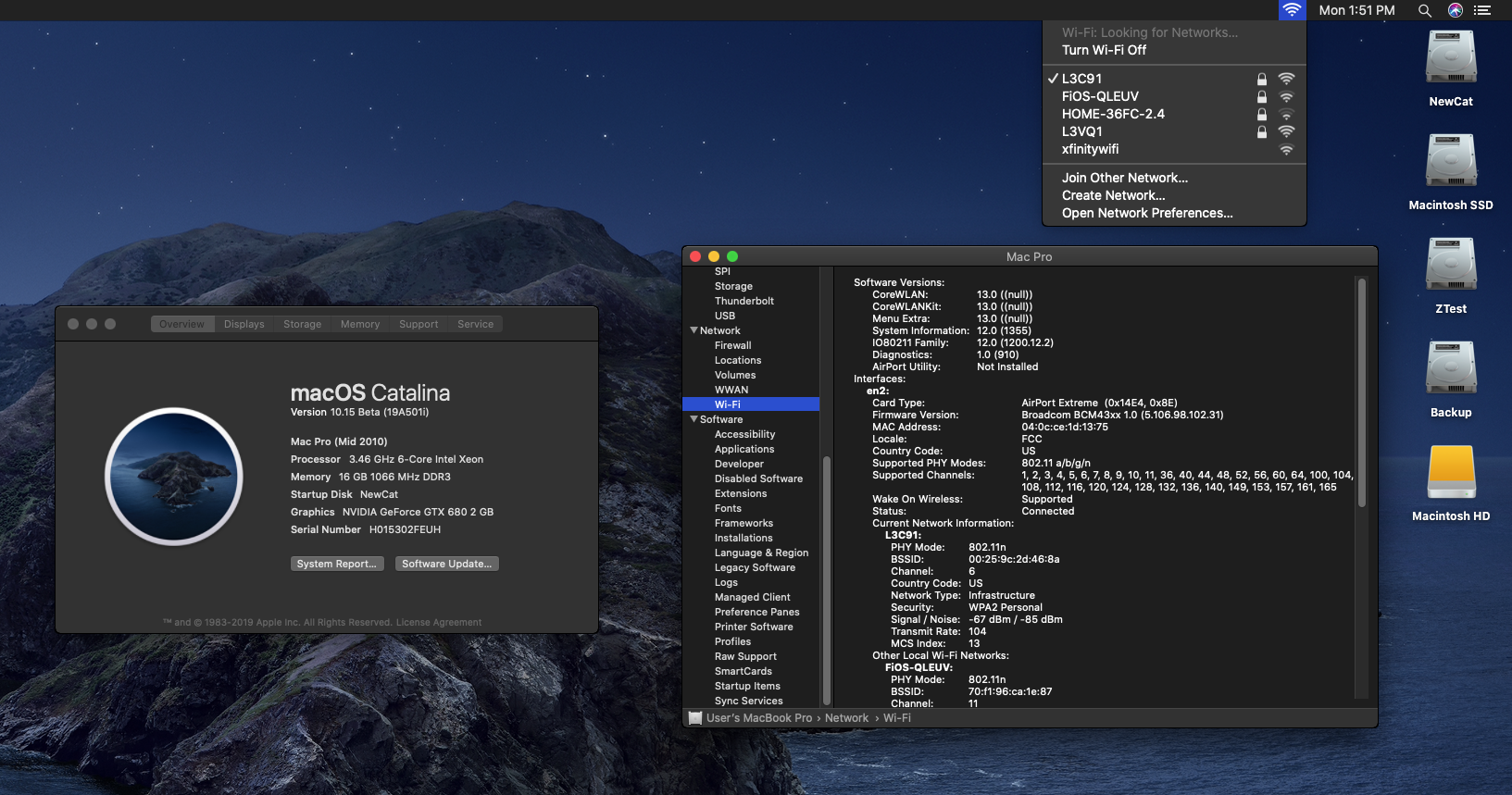

What WiFi card is it? Check under WiFi in System Profiler when running Mojave.
Card Type: AirPort Extreme (0x14E4, 0x8E)
Firmware Version: Broadcom BCM43xx 1.0 (5.106.98.102.31)
MAC Address: 44:d8:84:6d:c8:64
Locale: ETSI
Country Code: GB
Supported PHY Modes: 802.11 a/b/g/n
Supported Channels: 1, 2, 3, 4, 5, 6, 7, 8, 9, 10, 11, 12, 13, 36, 40, 44, 48, 52, 56, 60, 64, 100, 104, 108, 112, 116, 120, 124, 128, 132, 136, 140
Wake On Wireless: Supported
AirDrop: Supported
Status: Connected

I just tried it myself on my MacPro5,1 with the exact same card, and it worked just fine with the Legacy WiFi Patch applied. Maybe try re-installing that patch using Patch Updater, and see if that helps.

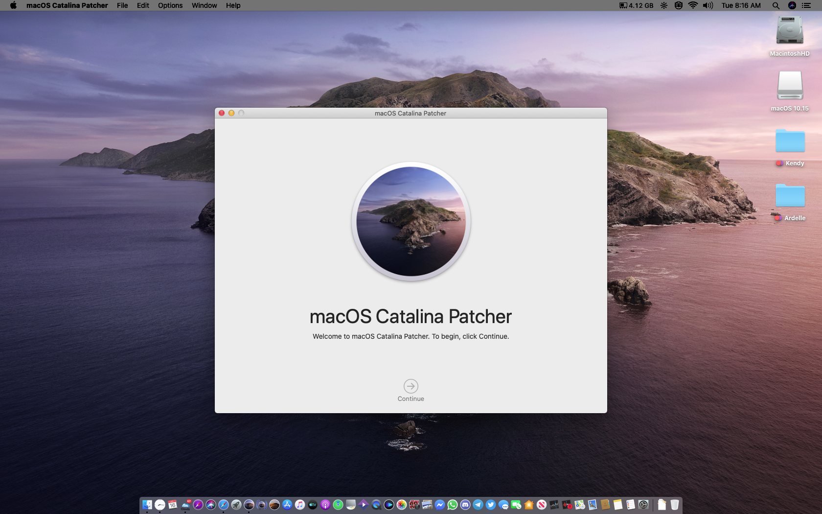

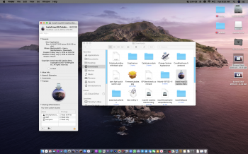

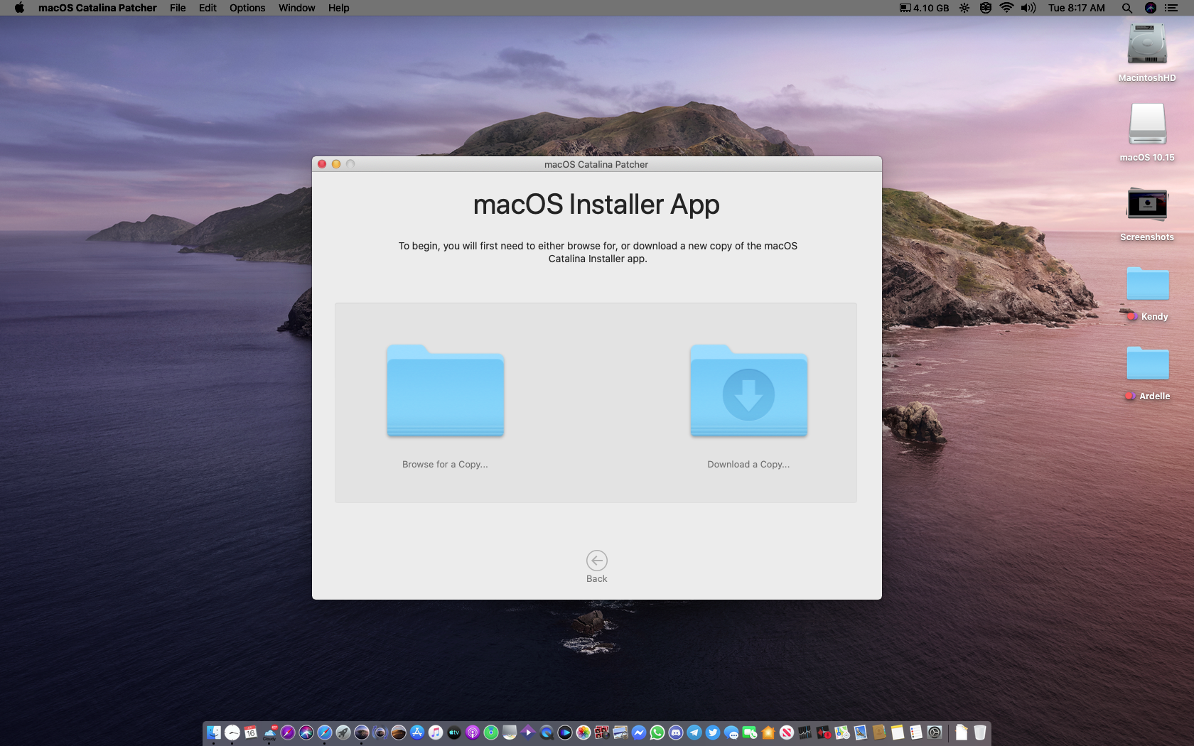

Did that Timothy but still showing 19A487m instead of 19A501i
what Cat patcher version are you using they should be downloading the latest Cat dev beta when you download Cat is downloads to your download folder keep it there if you move it to your Application folder then upgrade then upgrade it erases it from the applications folder and when you download a copy the best way to check if it is current right click on the install macOS Catalina beta get info then it should say 15.0.17 but make sure you erase your usb to macOS extended journaled
