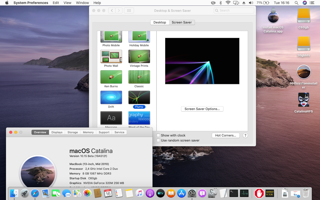

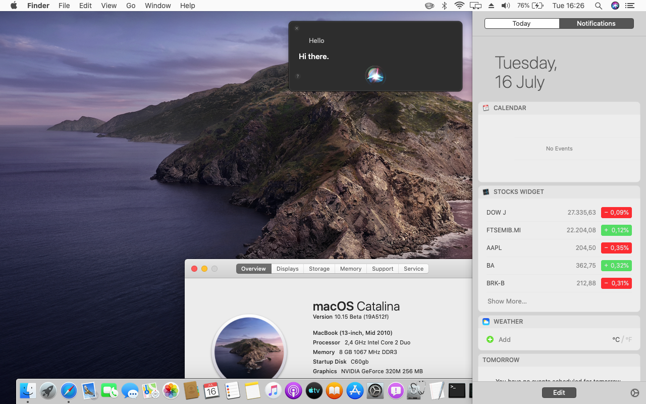

@ASentientBot FYI, from Catalina beta 4 on Macbook7,1 (and similar machines) apart a new required non-metal fix (your Skylight wrapper), all the other stuffs are confirmed to work as before.
Siri appears to work without any patches, also I am not using the HIDFamily fix.
Probably you already knew, but using the stock Catalina beta4 CoreDisplay and SkyLight the Appearance "Auto" day/night works fine.

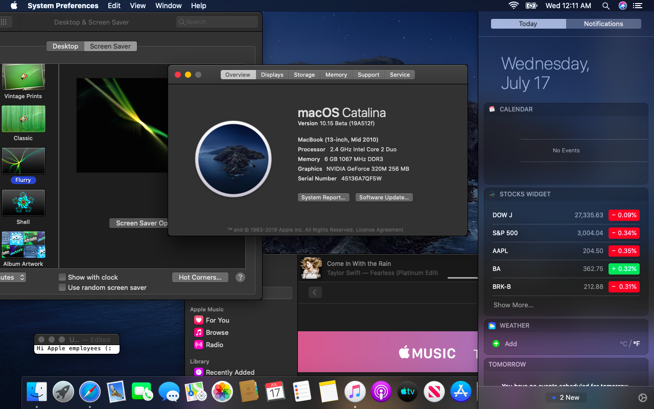

Acceleration achieved on DP4 with two NOPs to SkyLightOriginal: I saw loginwindow crashes, found "assertion failed" messages in DiagnosticReports, and... uh... ummm... patched out the assertions... Hey, it works!
As usual, I'll edit in details in a moment once I get over my excitement.
Edit: Alright, here you go:
There are no new symbols in either SkyLight or CoreDisplay. However, the function SLSReenableUpdateTokenWithSeed was bombing with "Assertion failed: (wid != 0)" and "Assertion failed: (sid != 0)". So I just NOP'd the places where it jumps to those messages:
Code:
0x787c6
0x787cf
This is, of course, incredibly dumb, but one thing that lends some credence to my solution is that the new function looks mostly unchanged (from a quick skim), but it does not have those assertions anymore. So, it is possible that a value of zero for those IDs is no longer indicative of a problem. It's also quite possible that I'm just masking the real issue...
If anybody who actually understands assembler wants to take a quick poke around (looking at you, @pkouame and @testheit) and confirm or refute my suspicion (and maybe find a better solution), that would be great :)
Latest wrapped frameworks are attached as always. (The only change since my Dock/login fixes is the SkyLightOriginal modification, but I'll put the full frameworks here for convenience.)

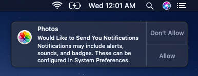

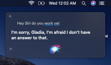

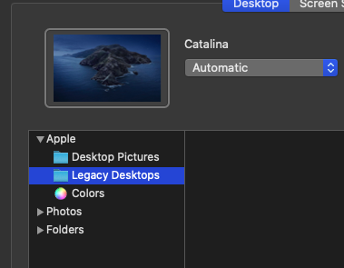

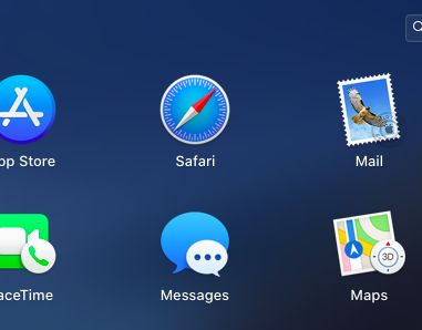

As for changes in DP4, a quick list of things I've seen so far:
- The IOHIDFamily patches don't seem to be necessary anymore. I'll edit to confirm this after a couple more timeout-free reboots, though. Edit: seems stable. @dosdude1 and @0403979, you may want to update your patchers.
- There are now notifications confirming whether you want to allow an app to notify you (I think this is new?)

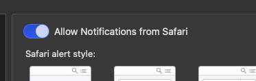

Edit: There are also new toggle switches for this in System Preferences:

- Apple seemingly followed my lead (as with Xcode!) and fixed the Siri crash by disabling the "flames view" on non-Metal systems:

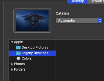

- There's an empty "Legacy Desktops" folder in System Preferences. No idea what it does. Maybe it's for those who installed over a previous OS?

- Edit: One more change I've noticed -- last edit, I swear... Our old friend Safari is back in Launchpad! (I'm very happy about this one.)
