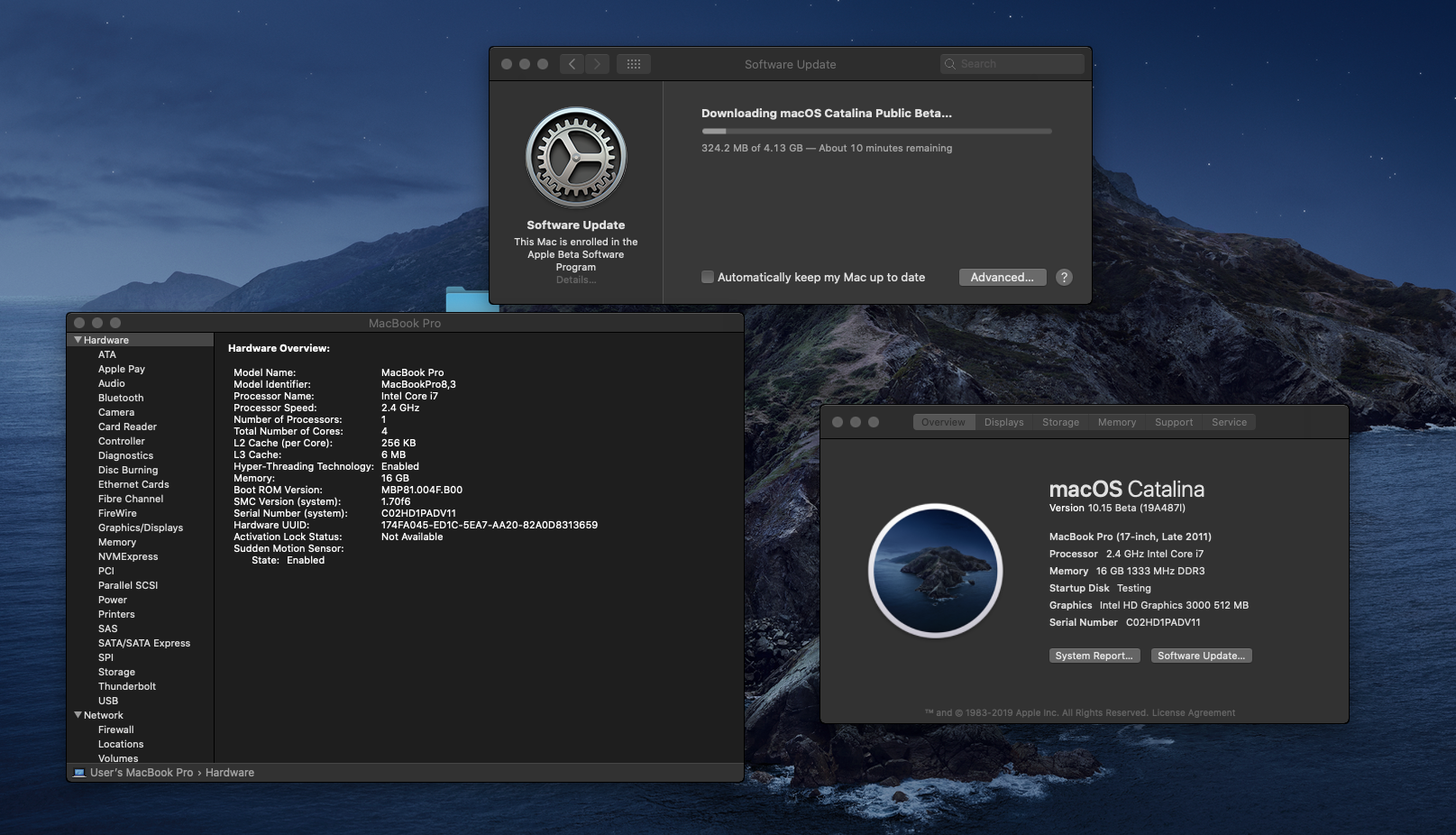

Slightly modified @Czo's SUVMMFaker.dylib implementation, and look at that, system updates are WORKING under Catalina on an unsupported system! Needless to say, I'll be pushing this update out via Patch Updater after some further testing.
