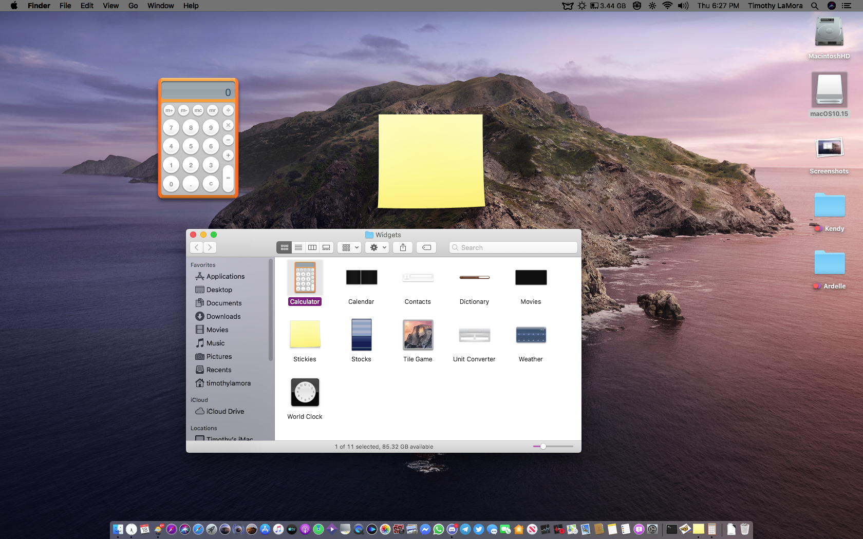

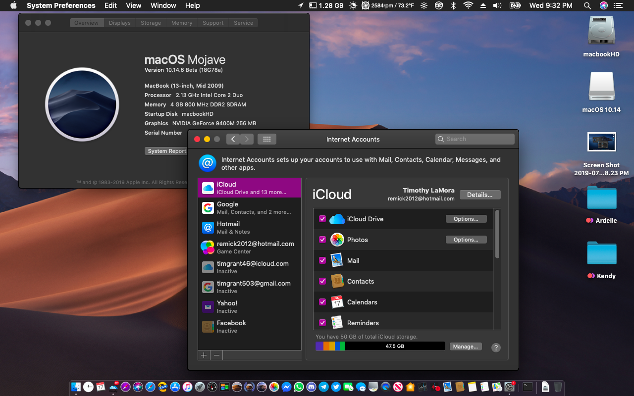

This is one thing I notice from Photo's on Mojave and Catalina the options is missing but when you click option on Mojave it unchecked the photo's box so that is broken

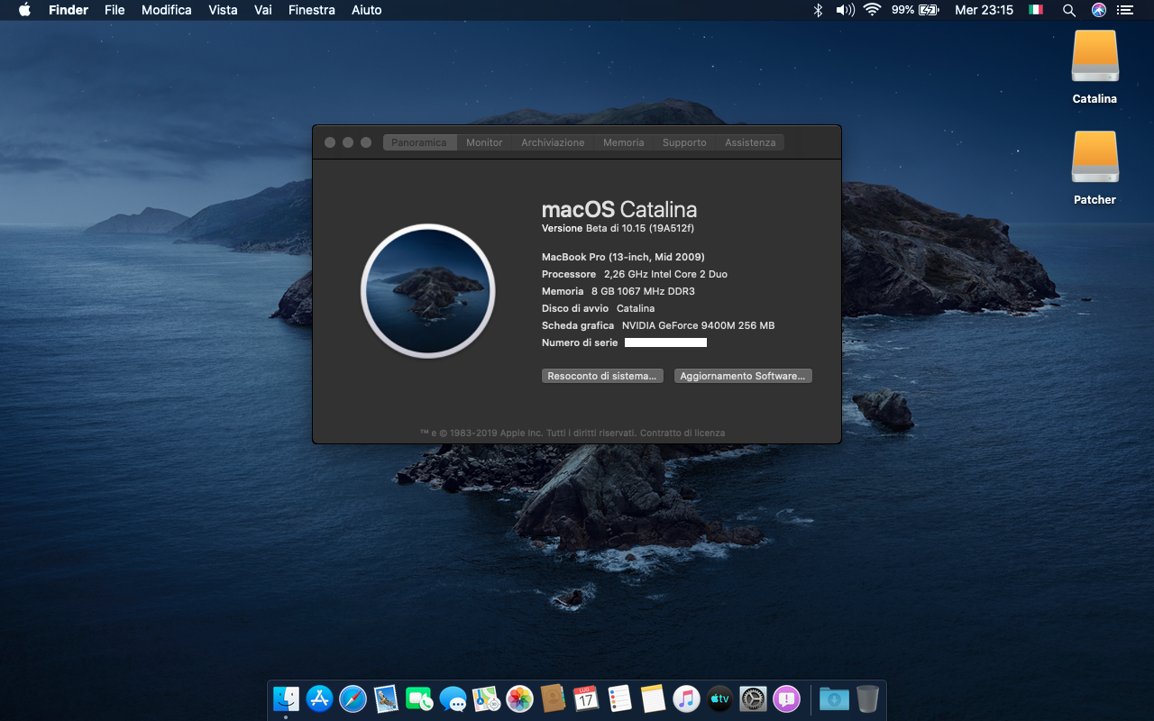

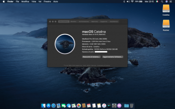

Hello from Poland ........
I have a problem during the installation I can't understand what happens......
on MacBook Pro 13"(mid2009).......
in short, just to say ......
I create on a HDD a partition in HSF to boot with the patch of dosdude1 1.0b11 and a second partition for the s.o "Catalina Beta 4" also this partition in HSF ....... no problem ......
Start the Patch and proceed with the installation, and at 4min. from the term it stops and I am forced to cancel the procedure .......
I still proceed with the "Post install Patchers" getting an error ...... normal the procedure has not been completed ........
Restart the mac "ALT" button to view the HDDs and surprise an external HDD called "EFI Boot" appears in APSF ..Boh !!
Starting "EFI Boot" and magically part of the installation which is completed correctly, at the end restart the "Post Install Patchers" and oplà the Catalina s.o is installed .......
The same thing happened to someone or something like that .......
some idea or explanation ...
maybe I'm wrong something in the procedure .....
Thanks for your suggestions.....

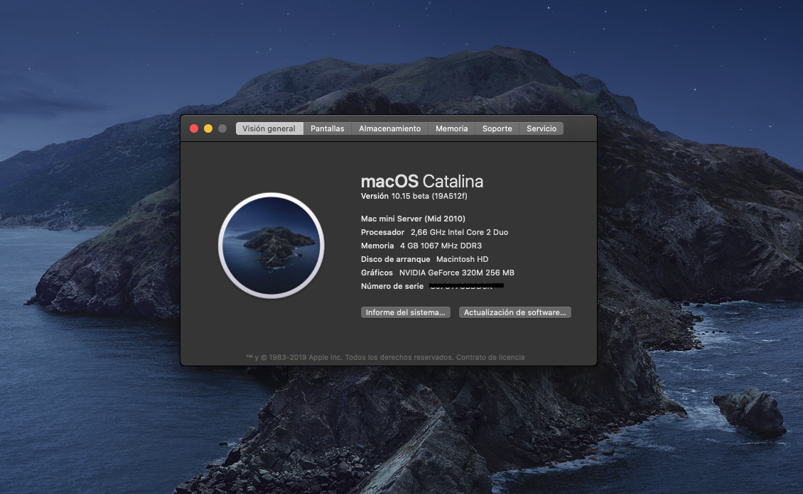

Just installed on MacMini Server mid 2010.
During install I needed to restart, it was at less than a minute to finish, but never ends. After restart it finished the install. Then again it got stuck after creating the user and start session. Again a restart solved it. As installed Screen sharing and Remote connections are on.
All hardware is recognized, Photos and Maps crash.
I attach the full System report generated just after install.
The "macOS installer" is made by two stages:
stage1 installer: takes on average 10 minutes to complete and will create a temporary folder "macOS Install Data" in your chosen "target HFS partition" (not sure why apple re-copy all the installer content on the internal hdd, probably to make installing process faster from internal disk), after the stage1 installer completes you can also unplug your "macOS USB Installer", at next auto-reboot the stage2 will continue also without it (I often do so)
stage2 installer: takes on average 35 minutes to complete and it will auto-convert the "target HFS partition" in APFS , then un-package all the "macOS Install Data" content over the internal hdd (or external hdd) overwriting the system files
Using OTA "Software Update" there is no stage1 installer, but only stage2 .
I'd say that the last 5 minutes of the stage2 installer are about cleaning/rebuilding caches, that's why (probably) even if someone force a power-off at that point, at next reboot caches will be refreshed and system will work.

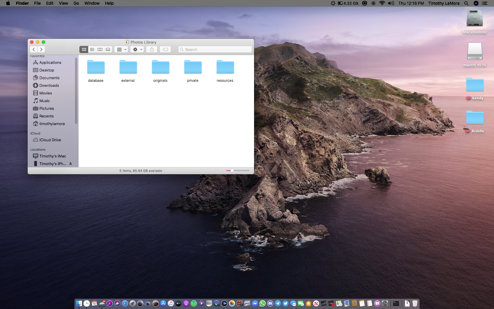

I found a way to access the photo's in the photo app maybe some of you know this go to your pictures folder right click on photos library -show package content your pictures are in the originals folder I put a copy in the iCloud but to see the pictures they will open up in the preview app :)
