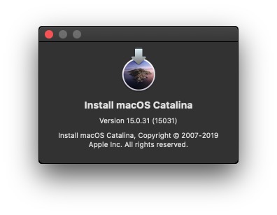

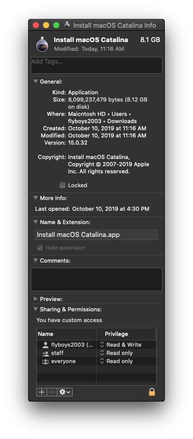

I think the issue some people are mentioning about the incorrect installer version is just an Apple mistake. The "Get Info" in Finder shows 15.0.32 but the "About" within the installer app still shows 15.0.31, Apple probably just forgot to update the text

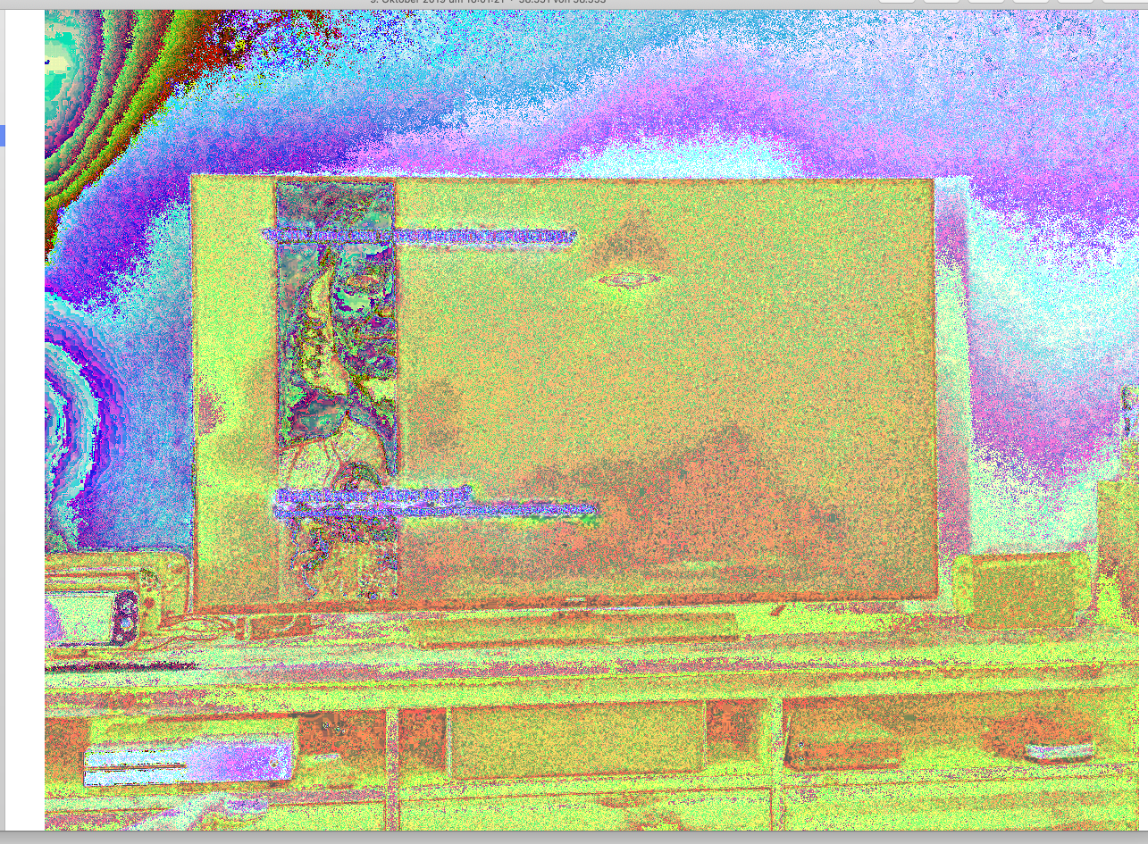

Hi @All,
i'm successfully using dosdude's patcher on my iMac 8,1 and my MacBook 5,1 since the sierra-patch tool.
Some days ago i updated my mojave installs to catalina (19A583). Everything went fine, except for one problem (which i didn't find anything about in this whole thread :-/ ):
on my iMac (ATI Radeon HD 2600), if i doubleclick a photo in photos so it becomes larger, it shortly shows correct, but then immediately turns into this mess (see attachment)
It happens to every photo, regardeless of its resolution/filesize. I even created a new photos-library, imported only one photo and the problem still persists.
Has anybody experienced the same/similar problems and has some hint for me what i could try? (my MacBook doesn't have this problem)
thanks!
bulli_t2

Hi @All,
thanks!
bulli_t2
The following posts show this problem #4659 and #4661. Unfortunately, we have not made any progress with finding a solution. Rather strangely, it seems that the pictures can be printed correctly.
Reactions: bulli_t2
Hi,
thank you so much for your information!! I was able to circumvent the problem with the "ResXtreme" app :)
Now the photos open and are shown as expected.
bulli_t2
