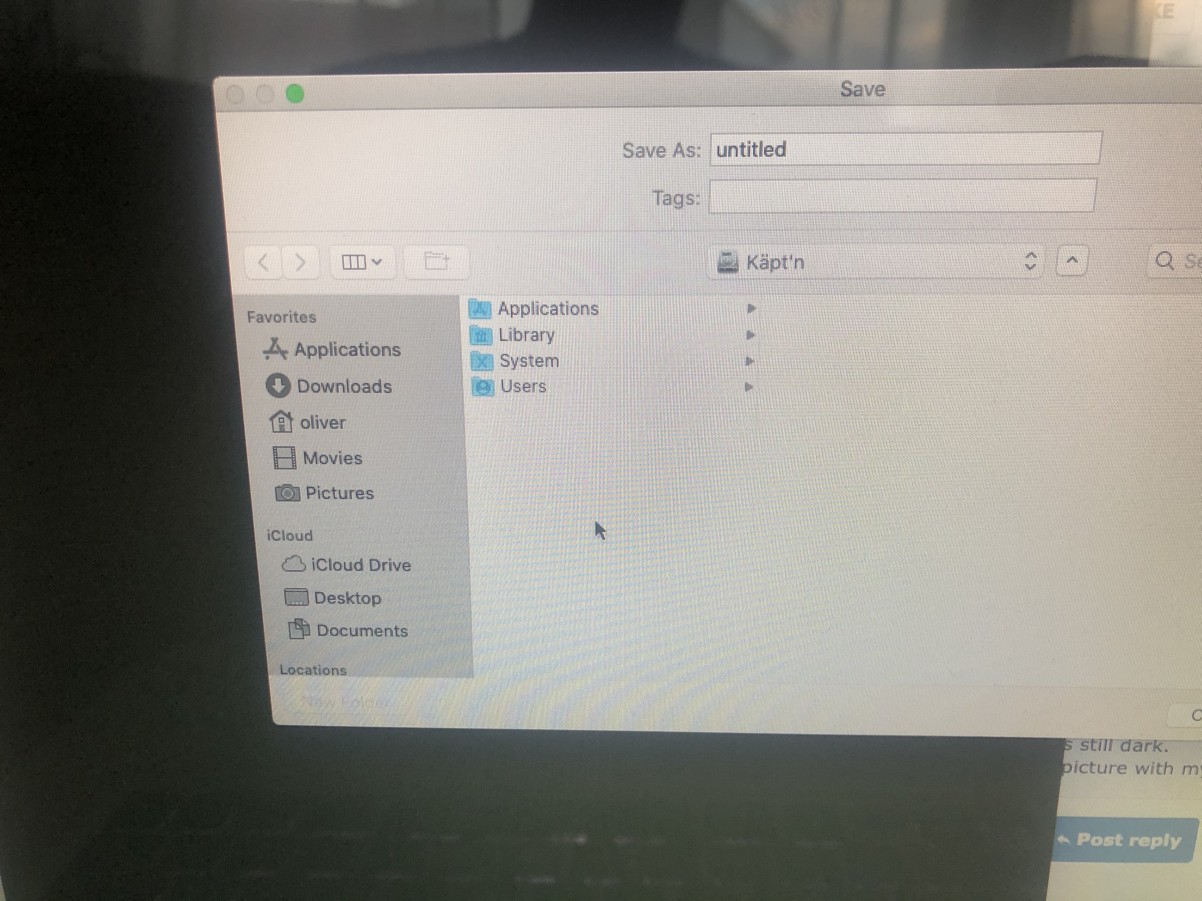

just installed Cat on my MBP2010 yesterday. Today the BlueSky Patch: everything worked perfectly fine.
Only one thing... I have Sublime Text installed and here (only here, didn't find another app), there is still a small light mode glitch: the navigation bar in the "Save As" windows is still dark.
As another funny fact: when making a screenshot, it looks fine. So I took a picture with my phone :) IMG_4082.jpeg
As another funny fact: when making a screenshot, it looks fine. So I took a picture with my phone :)View attachment 868331
Pretty sure that's just because you have a dark window behind it...
