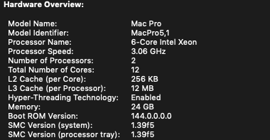

My MacPro5,1 had 141.0.0.0 boot ROM. I tried several ways to have it upgraded to 144.0.0.0.0 but the only one that worked for me was to first do a clean install of High Sierra (I used dosdudes's High Sierra Patcher to get the full High Sierra Installer) and then upgrade from HJigh Sierra to Mojave 10.14.6. This time it required me to upgrade the ROM. I didn't need to do the Mohave Install after that.
But my more pressing concern was that I am getting the same error as talkenrain and I thought upgrading the ROM would solve it, it did not. I'll post with more details.

I suggest upgrading the firmware to 144 first. Ask for help in that forum:
Reactions: TimothyR734
I guess you didn’t see my attachment. I did that and my mp5,1 now has the 144.0.0.0.0 boot ROM.

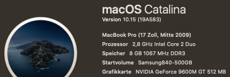

Catalina 10.15.0 release (build 19A583, installer 15.0.32) running well on my MBP5,2 17", mid 2009.
First cloned the internal SSD Mojave 10.14.6 to a frehsly APFS formatted external SSD (Samsung 840 EVO). Installed Catalina over it with dosdude's patcher 1.1.7 via USB installer. Also installed Nightshift with the patch updater. Checked again stability and performance like with the betas. Then swapped SSDs - Catalina is now on SATA as production system! TRIM support is on. Mojave SSD kept in reserve to be connected to USB just in case.
Everything behaves very stable. Prepared a lengthy Keynote presentation today: the MBP will travel with me to a physics+computing workshop in Kathmandu, and I'm confident it will not cause any problems. Yet I'll take the USB installer with me, and the Mojave SSD, and a screwdriver.
What a pleasure. Thanks Dosdude, ASentientBot and all contributors!
Running with the 9600M GT, dark mode, reduced transparency to reduce the work for the graphics. The machine is a bit slower than with Mojave it seems, which may be due to photoanalysisd and CalendarAgent activity in the background.
(MBP5,2 17" mid 2009, 2.8GHz T9600, 8GB, APFS ROM patch applied, Samsung SSD 840 EVO with APFS, Catalina 10.15.0.)
