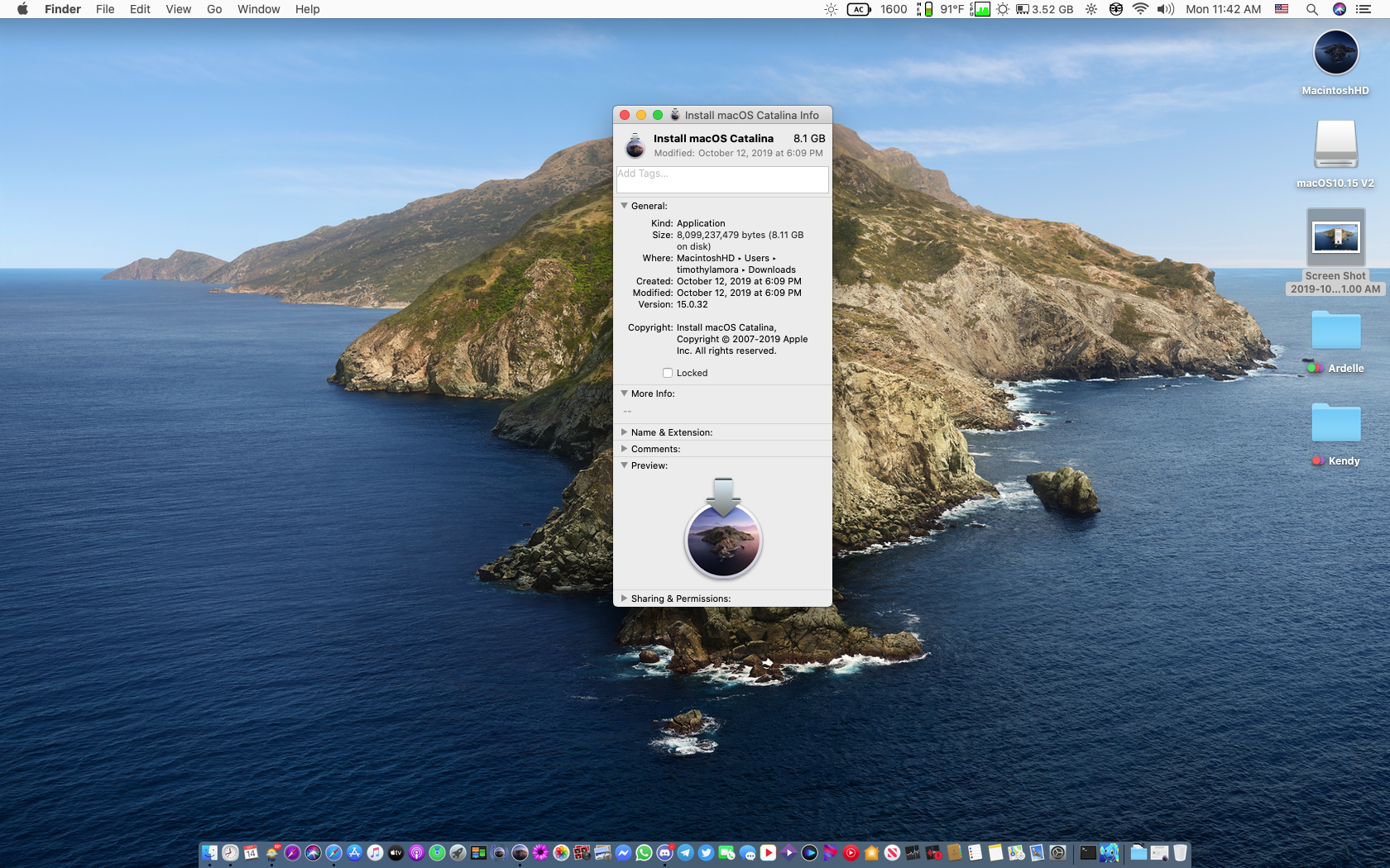

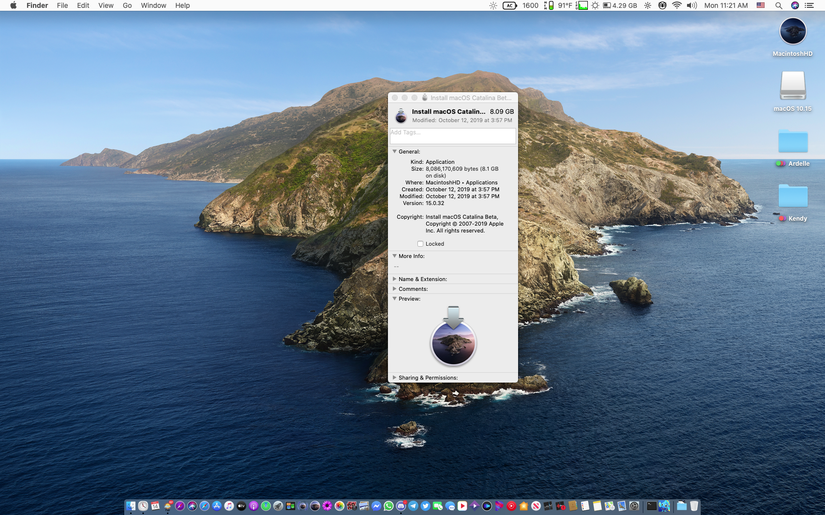

15.0.32 was the beta GM Candidate and release. I am looking for the next version.
Reactions: TimothyR734
I ended up switching from the dev beta to the public beta and tried download macOS Catalina from the macOS downloader this time it downloaded Cat versions 15.0.32 where on the dev profile it downloaded Cat version 15.0.31
[automerge]1571078886[/automerge]
This is the one I downloaded from 1.1.7 of the Catalina Patcher now notice the difference between both of them the first screenshot says install macOS Catalina Beta downloaded from the macOS downloader and this screenshot it says install macOS Catalina from the macOS Catalina Patcher it could be possible Apple forgot to change the version number like the did from the GM to full public release and notice the size of each
[automerge]1571078915[/automerge]

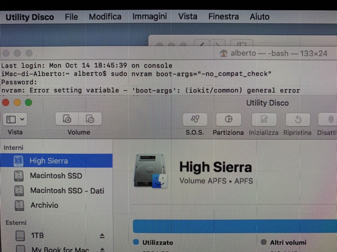

If you need to disable SIP without a bootscreen, try this from your iMac HighSierra (assuming that is an HFS+ installation), open HighSierra Terminal and type:
sudo nvram boot-args="-no_compat_check"
(this should also allow to boot Catalina without patches)
Then from your HighSierra, open System Preferences - Startup Disk - pick your HighSierra Volume label, and let system reboot, right after the "power-on chime" hold CMD+R for 20 seconds, then wait at least 5 minutes, after that timeframe you should land on the official HighSierra Recovery and from there disable SIP with recovery terminal: csrutil disable
Hs is in APFS.....so was MOJAVE....
Terminal said: error setting variable....
You're right, since also HighSierra is in APFS you should set that nvram value from a Recovery Environment, then try this, open System Preferences - Startup Disk - select your HighSierra label
System reboot, after "power-on chime" hold and keep holding CMD+R for about 15-20 seconds, then wait (without bootscreen) at least 5 minutes, it should lead to the HighSierra APFS Recovery (that is supported for your iMac 2011), from there open a terminal and type:
csrutil disable
Nothing.....after 10 minutes the screen is still black.....

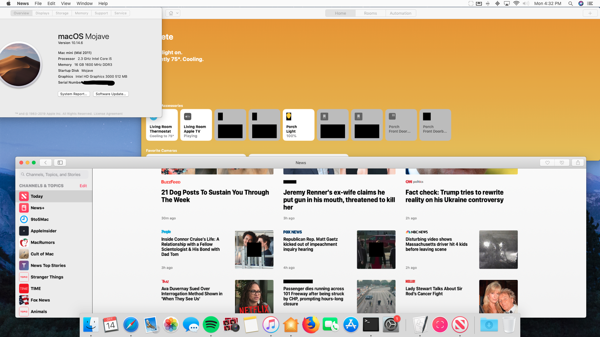

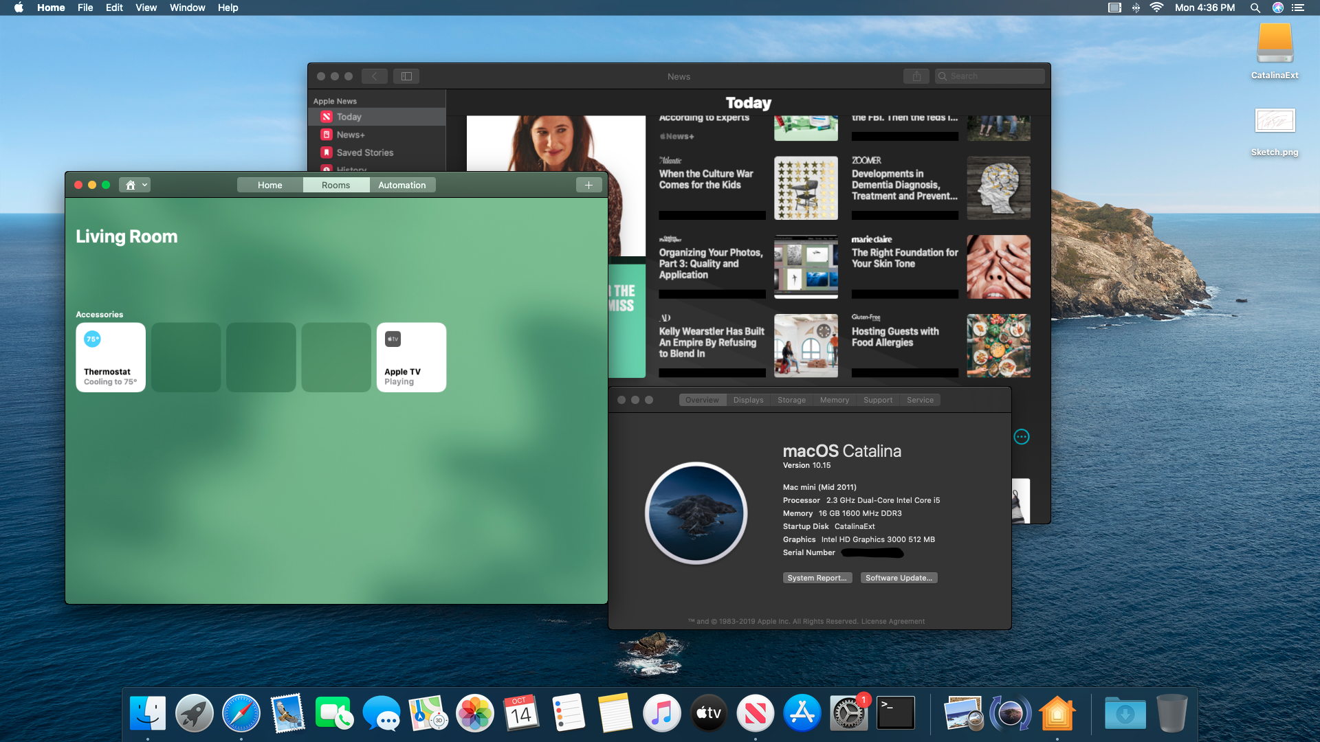

Does anyone have issues with the home app ? On Catalina no switches show, they are all blank.
Microsoft Word, highlighting has some major graphical glitches, any workaround would be great.
im having same problem with the home app, similar issue in mojave. Also effects news app for me. I remember it working correctly briefly during Mojave beta days but stop working again once final release. IAC1B3101-1463-4876-842A-33DA1B7D1DE9.png73E3CE69-37D5-4522-896E-8BA78C780F12.png
Recovery usually takes around 3-5 minutes to boot, so in your case it doesn't worked, you can press power button and keep it 10-15 second until iMac power-off, then power-on to reach again HighSierra. You need a recovery environment to set nvram and disable SIP from an APFS container, can't do it with "sudo" and without a bootscreen it's not simple to guess from where you are booting.
edit:
seems your swapped non-EFI GPU K2000m Nvidia Kepler (they share the same driver with K5000) even if Metal supported those GPUs have some known issues with OSX Installer (or OSX recovery).
But if you read here: https://forums.macrumors.com/threads/mp5-1-what-you-have-to-do-to-upgrade-to-mojave-bootrom-upgrade-instructions-thread.2142418
"Quadro K5000 you can't do a USB clean install with it at the moment. The USB installer don't detect that the GPU is a Metal supported card and don't continue the install, it's a bug with Nvidia Kepler GPUs."

im having same problem with the home app, similar issue in mojave. Also effects news app for me. I remember it working correctly briefly during Mojave beta days but stop working again once final release. IView attachment 869523View attachment 869524
its gotta be possible. We would appreciate any help. @dosdude1 @ASentientBot @TimothyR734 @0403979
go to the macOS Mojave for Unsupported Macs forum try post 15432 I believe page 614
I installed the version of Catalina that I downloaded from the macOS Downloader and it installed the GM thank goodness I have the Catalina Final patcher:)

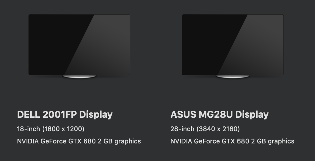

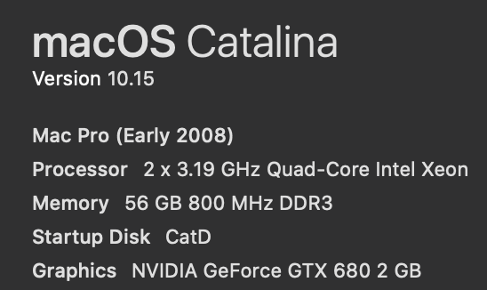

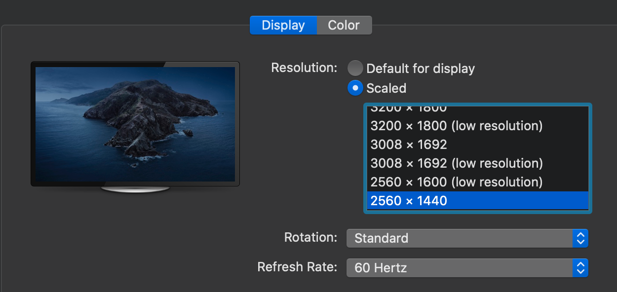

I was able to hack my system literally and got the DisplayPort to function.
This is not recommended, but I have some follow up stuff that may be of interest to whoever wants to create a patch.
Using Clover and Clover Configurator, selecting only a SMBIOS profile of Mac Pro 3,1 profile for my system and only changing the Board ID to the Mac 10,1 board ID of 'Mac-F2268CC8', and using the Clover boot loader, I was able to get DisplayPort to function on a Mac Pro 3,1 with an Nvidia GTX 680 Card with 4K@60Hz on the Display Port just like it did on the the early betas.

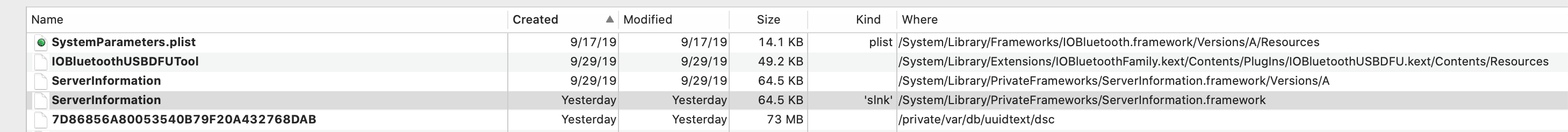

Now I did a search high and low for that 27" iMac 2009 board ID F2268CC8 and it is present in 4 files:
IOBluetoothUSBDFUTool
IOBluetooth.framework/.../SystemParameters.plist
.../PrivateFrameworks/ServerInformation.framework/ServerInformation
/private/var/db/uuidtext/dsc/7D86856A80053540B79F20A432768DAB <!-- that # may vary
I don't know if this matters but the Mac Pro 3,1 board ID is not in the two IOBluetooth files.
Now I have not tried swapping out that data from my working Catalina Beta or tried doing any hex editing yet. It spent a good bit of time all day yesterday just swapping out .kext files to no avail.
I did see an osX86 user have the same issue and he chose a Mac Pro 6,1 profile. That just KPs my system.
Again, using Clover is not recommended and once there is a proper patch, I will discontinue using it. I think for troubleshooting purposes, it does show that the DisplayPort can still be made active on Cat 10.15 GM and this does not appear to be a Video driver issue at all. I don't even think it is actually an AppleSMBIOS or System.kext issue either as I originally had thought. Just that Apple probably removed DisplayPort access on certain configurations.
Hope this information is helpful and that someone finds a fix so Clover or another bootloader does not have to be used. Attached are some screenshots of my findings.
Also several iMac profiles do not allow the DisplayPort to be used either, so this issue could be fixed by Apple, but also they may only fix it with certain board types. We shall see what .1 and .2 bring.
If no one tackles this, I may run a few more tests next weekend. I am hoping we can collaborate on this problem as I know there are better patchers on here than me.
Only caveat to swapping on a board ID is Apple may deprecate another board ID in the future. We all might be on borrowed time, but so far I am just glad to have 4k@60Hz back and can start building my 10.15 system out.
View attachment 869296View attachment 869297View attachment 869298View attachment 869299View attachment 869300
What system is this on? You could just edit the needed kext to get it working without having to use clover.
