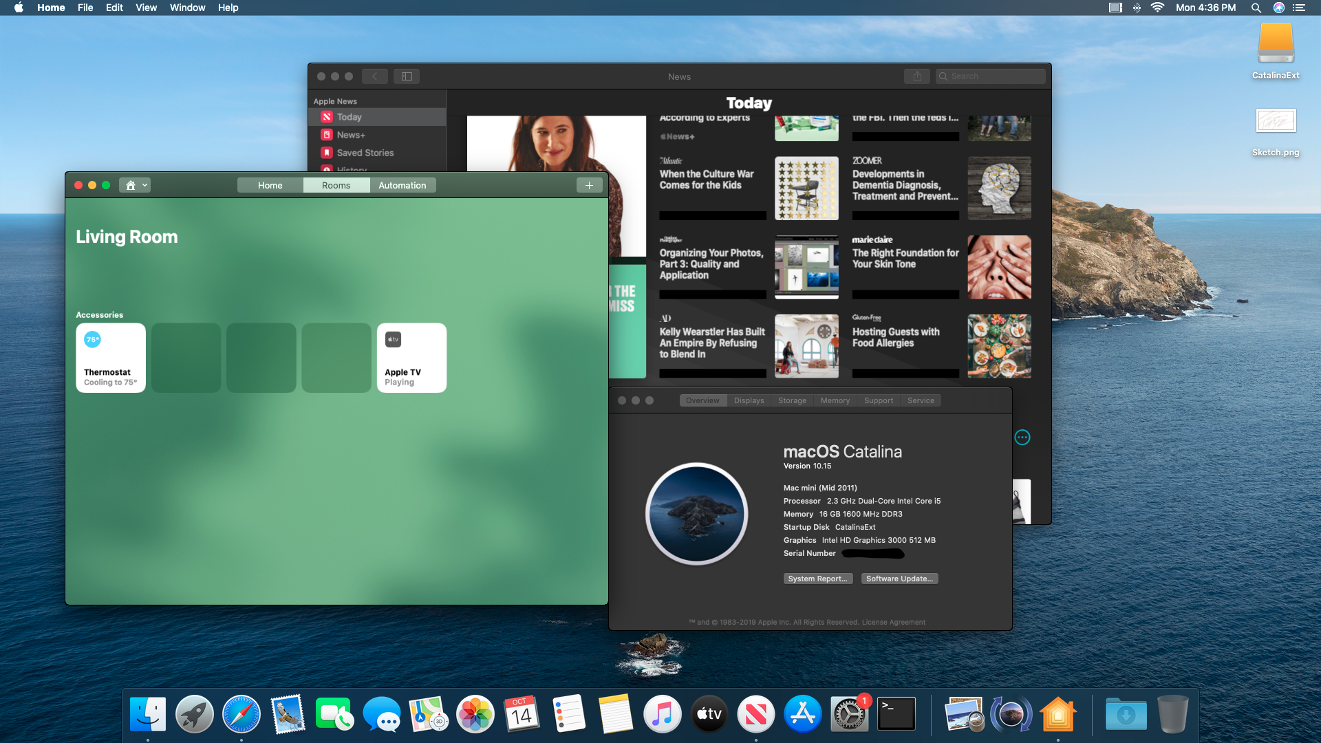

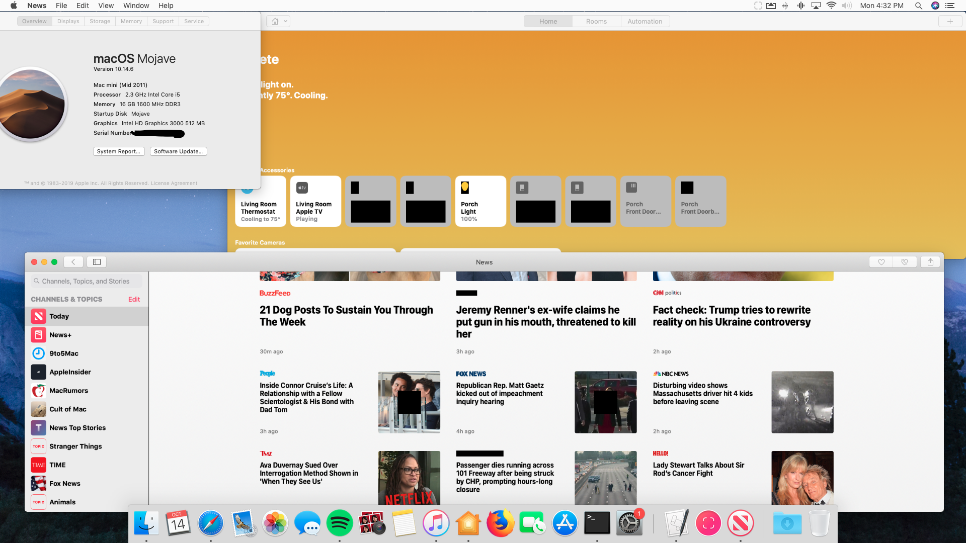

im having same problem with the home app, similar issue in mojave. Also effects news app for me. I remember it working correctly briefly during Mojave beta days but stop working again once final release. IView attachment 869523View attachment 869524
its gotta be possible. We would appreciate any help. @dosdude1 @ASentientBot @TimothyR734 @0403979
I'm not seeing this issue with either Word or News. (I'm not able to test Home.)
Not sure what is going on with your system. Does toggling "reduce transparency" help? This is very strange.
