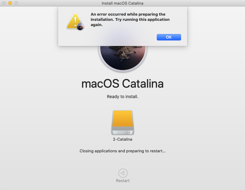

HELP, installation on MBP 13"Late 2011 went on until 4 minutes remaining then throws me "Error occurred while preparing the installation. Try running this application again."
Anyone can help?

It appears that the new 15.0.33 full installer is incompatible with the 1.1.7 Catalina Patcher. The installersetupd appears to crash when the patched installer is setting up the installation. Of course this was my first usb installer created under Catalina rather than Mojave so I am assuming that isn't the problem.

Do you have firewall off? I had that problem and was firewall blocking.

I've installed patched Catalina literally a hundred times and have never had this problem. The only difference is that I am using a untested full installer and creating the patched installer under Catalina rather than Mojave. Currently recreating the patched full installer for 15.0.32 under Catalina to verify that isn't the issue.

Is that likely the caused of this issue of mine?

Yes. "Error occurred while preparing the installation. Try running this application again." is exactly the error I see. I am tempted to retry it with a copy of the 15.0.33 full installer downloaded from a supported machine but doubt I'll get a different result.
Thanks for confirming. I'm restoring backups for my mac. Wonder if I can try look for an older catalina image and run the installer again to see if that works.

I always keep the previous one around until I've confirmed that the new one works.
Update: Confirmed that a patched installer from 15.0.32 built under Catalina with Catalina Patcher 1.1.7 works normally.

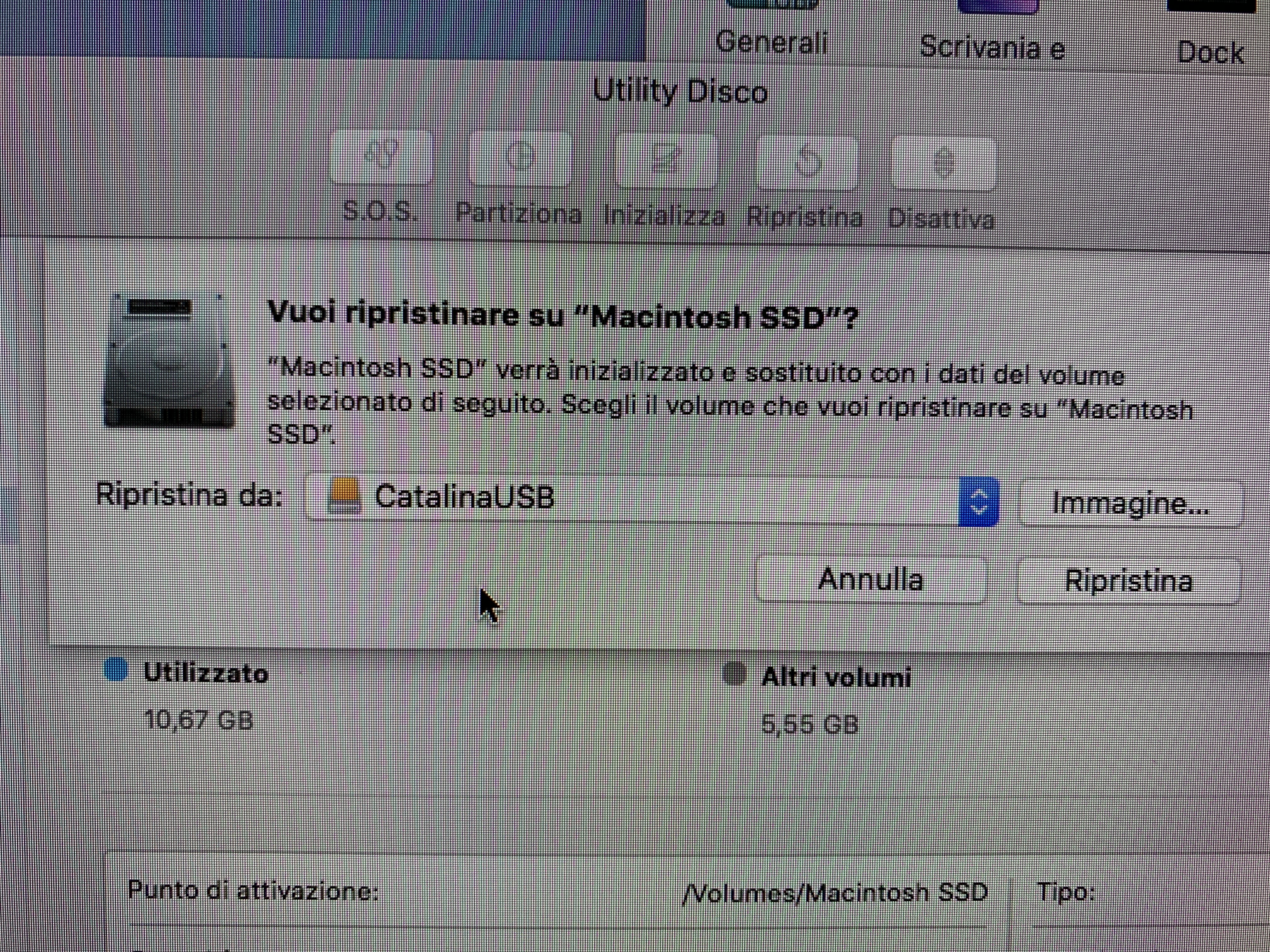

ehm..... restore option?
Nope.....HS is in APFS container....error during restore option....
I’m trying CCC from Catalina.....but I have doubts.....
Tried CCC from HS results in error.... boot land to black screen and then shut down automatically.
Also ordered from Amazon Thunderbolt/Fireware adaptor.....last option.....until reswap the video card 2 times🤬
Edit:
Order Amazon CANCELLED !!!!
The cloning option with CCC was successfully accomplished!!!!!
THE IMAC boots from its internal SSD !!!
Now I’ m restoring from time capsule....
See you tomorrow to final cheers!

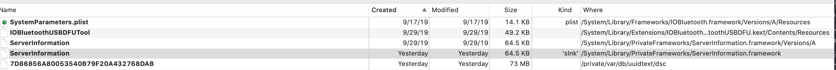

What I am doing is editing the board # to enable the Display Port which broke in the GM and a some betas before it.
I tracked down where the iMac 10,1 27 2009 board ID is, and it is in 4 files and they are not all kexts. I know I can probably put my board ID there and remove where my board ID is listed elsewhere, but I am in the middle production work and don't have the luxury right now. I'm doing work for some pretty big clients and I can't miss a deadline. I spent the entire weekend searching for a good fix and finally settled on Clover for now and then a did a file search where the IDs I am looking for are located, but stopped there.

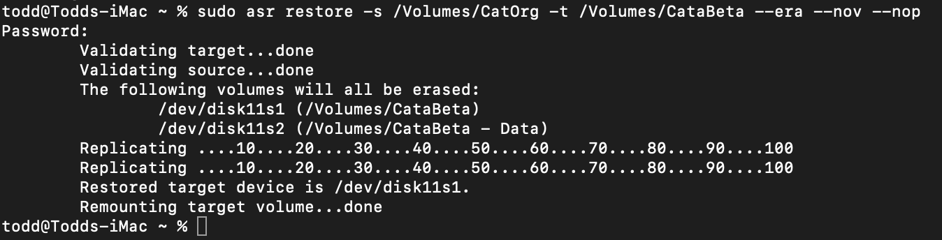

Installing Sup. Update to a USB SSD and will clone using Apple Software Restore.

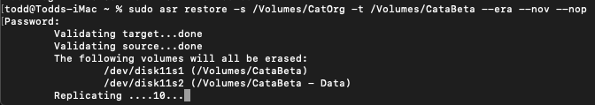

Here is the CLI command that I use
sudo asr restore -s /Volumes/SourceMac -t /Volumes/TargetMac --erase --noverify

All you should have to do is figure out which kext are for that graphics and edit the frame buffer or use a previous kext from a beta that it worked on to get it working again. in the long run it would be better to do that instead of using Clover
It is not a graphics driver issue. I have stated this a few times on the Discord and here. I know the files that are affected and have posted them for those who are interested. I would swap out the IDs necessary, but I am busy working two programming jobs at the moment and have very little time for tinkering. I spent last weekend checking out all the Graphics drivers, Kexts. most are identical to a working beta and I have swapped out those drivers and nothing changed. There are 3 areas affected: 2 BlueTooth files, 1 very large 73 MB SQLite Database file on the User's Data partition and one Private Framework. I have given enough info for anyone else to carry on the torch.
Clover works fine by the way. One reason I haven't bothered.
What the real deal is Apple remove whatever configures DisplayPort on serveral models including many iMacs. Many users are using to turn on ScreenRecording for their Drivers and that has something to do with it. But the drivers themselves are fine and not all drivers are showing up in the ScreenRecording area.
My workaround is to use a board ID that still has DisplayPort turned on but still allows my Mac to boot without a KP. I found 2 so far.

btw, it looks like the required inversion process has been removed in ASR on 10.15 GM and Sup Update.
[automerge]1571193827[/automerge]
Goodbye to Beta partition. Cloning Supplemental Update partition. :)
DisplayPort is still broken.
