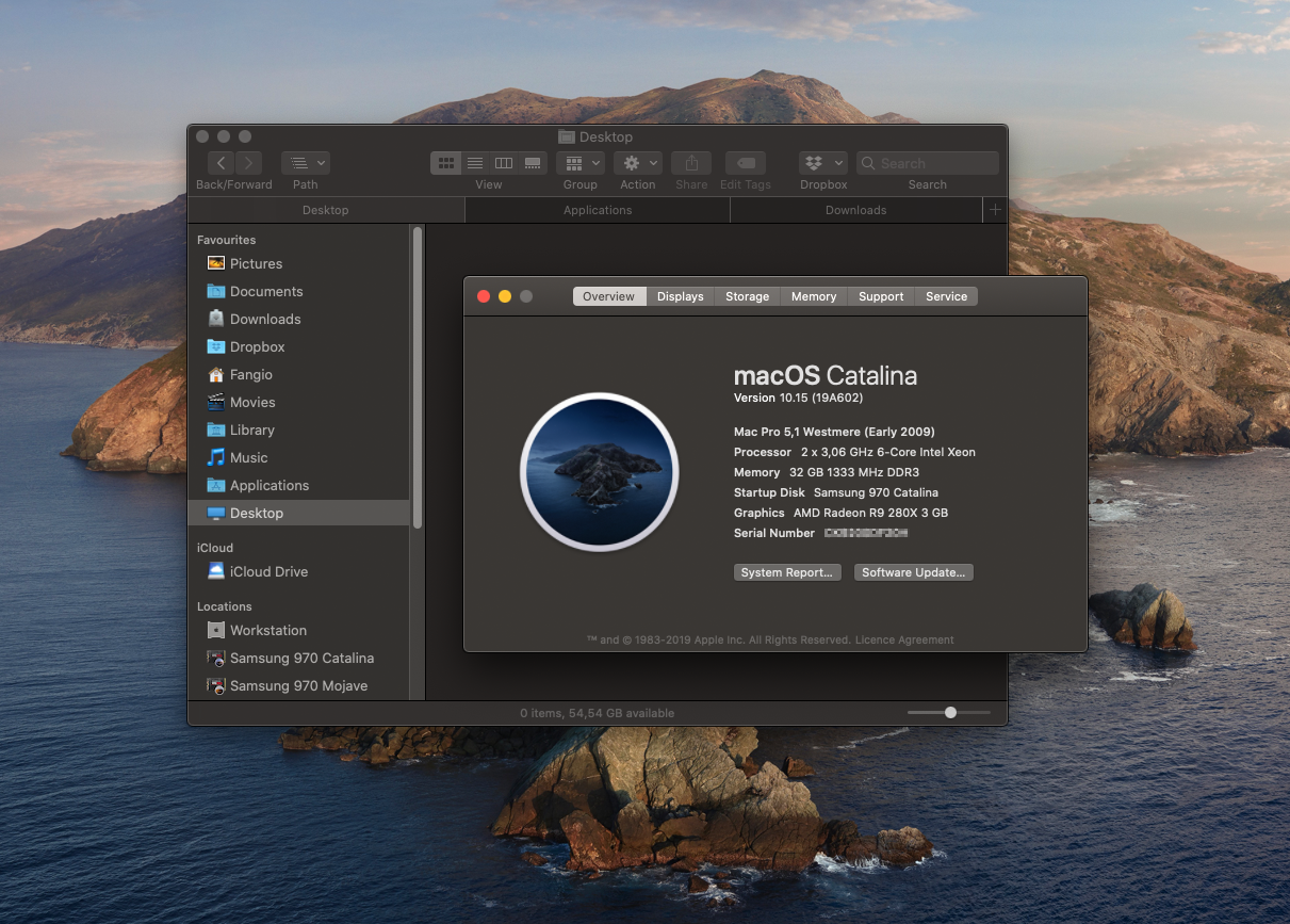

No issues here on the Mac Pro using Patcher 1.1.9 and the 15.0.33 Installer including the Supplemental Update. Used my MBP to download from the App Store and 'Installed to this Machine' over the first public release.
