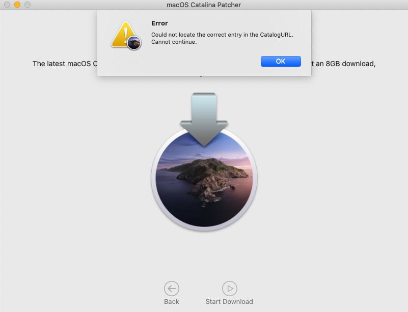

I have a MacPro 5,1 with the original release installed (19A583, released 10/7/19). I downloaded Catalina Patcher 1.1.9. I tried to use it to download the new Catalina installer with the supplemental update...
However, I get this....
This is not the beta, this is the new "release" version, which is the full version of the installer that get you what you would have if you have a supported machine and applied the supplemental update. To be sure that the installer was okay, I used it to install into a VMWare Fusion virtual machine and all is good there (which virtualizes a supported machine).

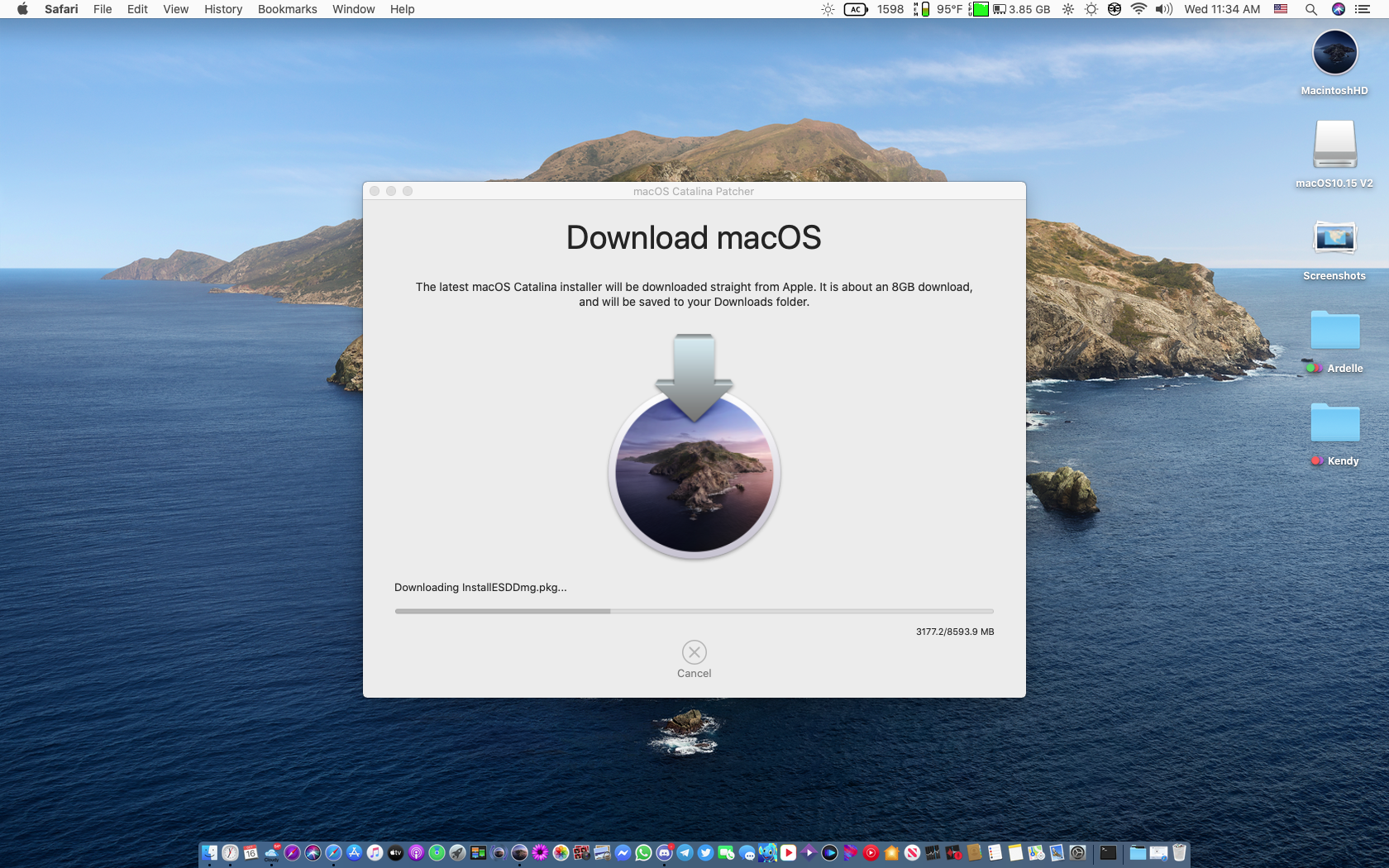

I used patcher 1.1.8 to download the supplemental update and now using 1.1.9 and its downloading you might try deleting the Catalina Patcher and re download it then try again
I have a MacPro 5,1 with the original release installed (19A583, released 10/7/19). I downloaded Catalina Patcher 1.1.9, used it to download the new Catalina installer (intsaller version 15.0.33) and then attempted the "Install to this machine" option that has always worked flawlessly on this machine. It went through the initial install process and rebooted but rather than installing the new version, it just booted back into the untouched, previous version. I then created a USB installer and rebooted to that. The installer would not even attempt to install to that volume, so I used an external drive, formatted as APFS and this install terminated with an "This operation can't be completed. Permission denied".
Am I alone in this or is this something specific to my system? Any suggestions would be welcomed!

How about the nvram no compat check argument? I always keep this active.
Success!! Setting the nvram no compat check variable did the trick and I am now running 19A602 on my MacPro 5,1. Thanks very much for that!
This is kind of interesting as I had set that many moons ago and have installed a lot of Developer betas, the GM and the release version on this machine (just last week) without having redone that. Something must have reset the nvram recently, maybe the installation of the new video card yesterday.
Anyway, good to have it resolved and thanks to all for the support and suggestions.
