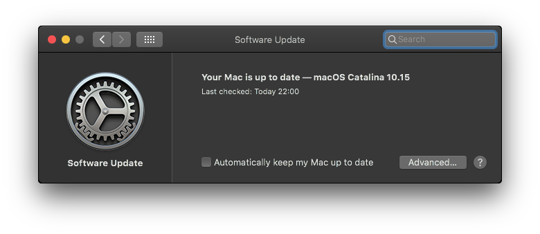

Supplemental Update released should we do anything special while update?
BTW Software Update didn't find anything.
How to update it?

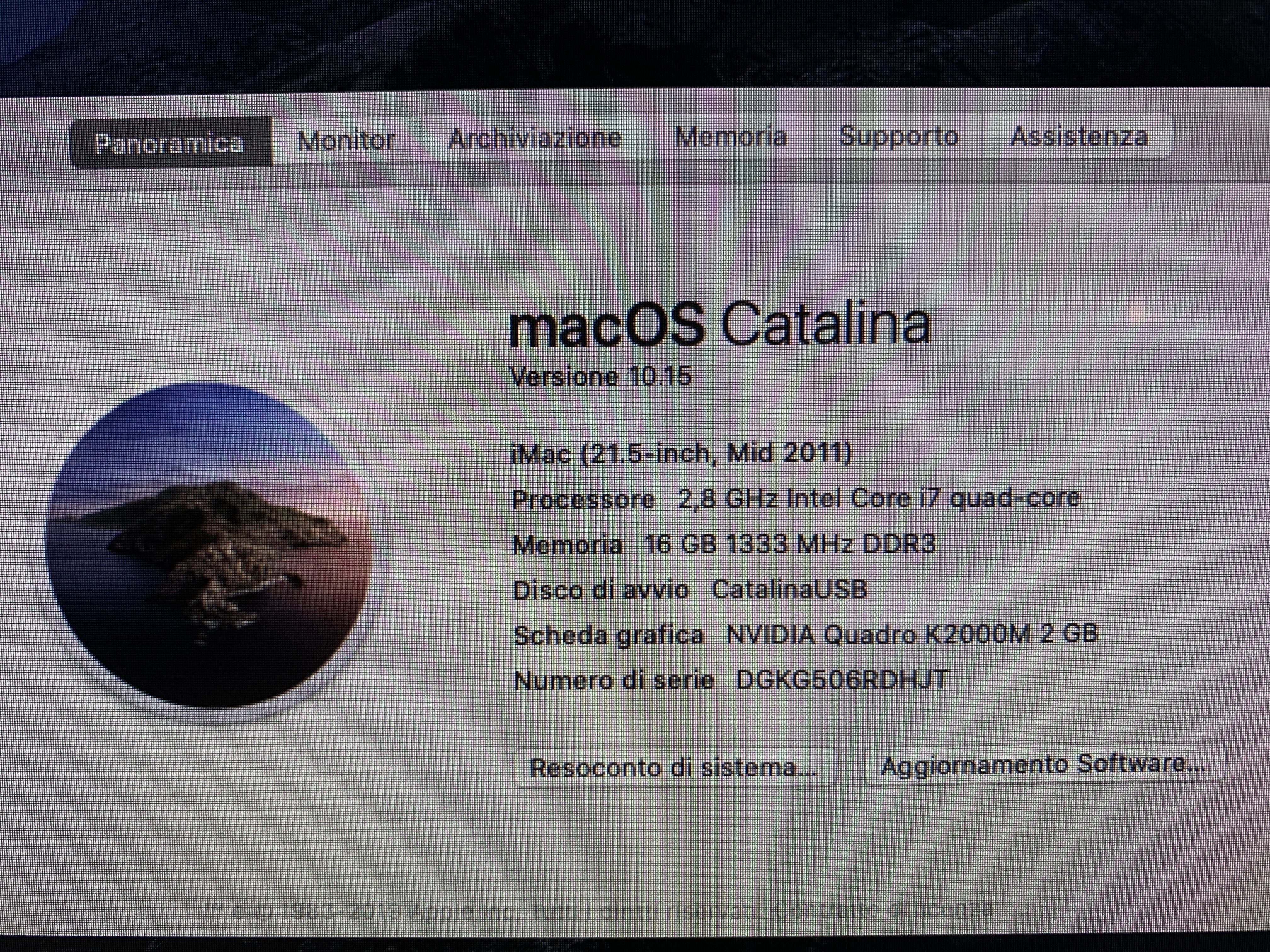

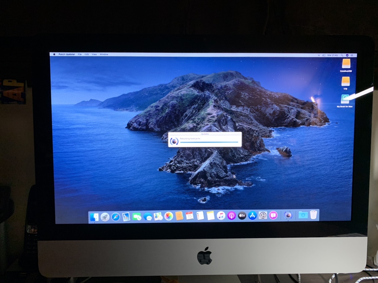

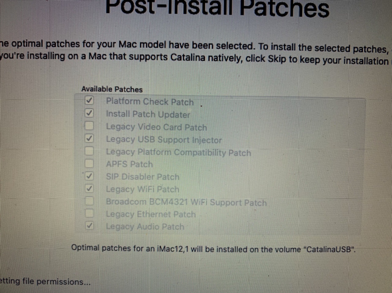

That's the point, from the Air you should do a clean Catalina installation with the post-install patches for your iMac 2011 except the "Video Patch" you have to uncheck it, you don't need it for a Kepler Metal GPU.
On the Air you could even make a Catalina patched installation on an external USB hdd, and then test it on iMac 2011, if works you clone that to the internal iMac disk from HighSierra.
Ok first step: installed Catalina on USB disk from MacBook Air running Catalina with dosdude patcher (I’ve had to disable SIP)...... but no possibility to run post install patches. The external usb boots correctly on MacBook Air.
Now I’m creating a usb stick with Catalina Installer from dosdude.
Next step: boot the MacBook Air from the stick....and then apply from it the post install patches on the USB HDD for my iMac 12,1 WITHOUT video card patch.
Last step: try to boot my iMac.....from usb hdd patched.....finger crossed🤞
Stay tuned....

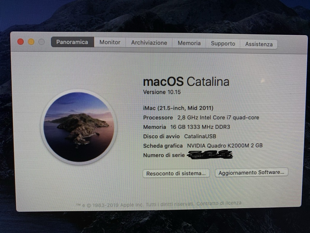

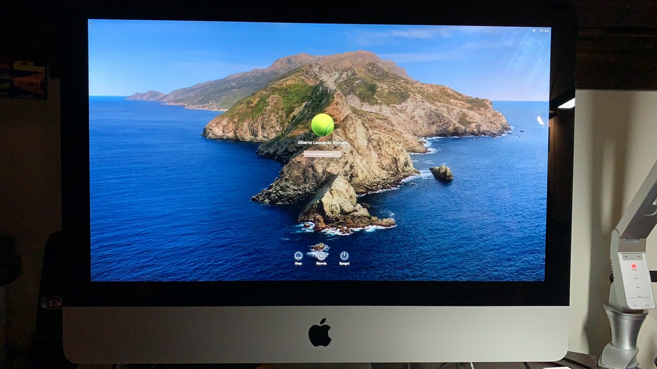

Stay tuned....
Eureka!!!
First little step.....the usb hdd boots my iMac 21,5 with the K2000M video card.
Next step is to clone the usb hdd onto the internal SSD
Any suggestion?
CARBONCOPYCLONER?

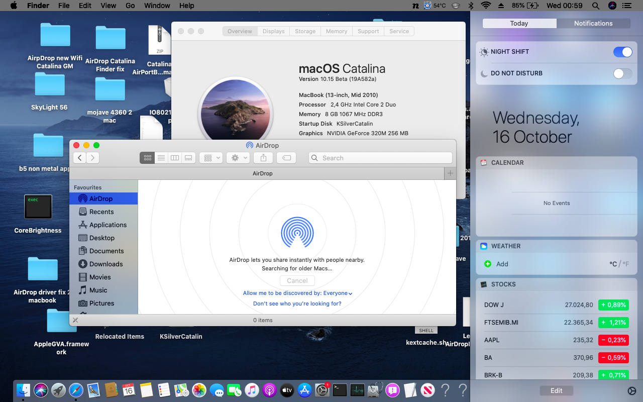

Any one get airdrop working. Not working on my MacBook Air 4,2
I made some kind of patch that should work but only on 2010 and 2011 machines (maybe 2009 too), what's the output of these terminal commands on your Catalina:
ioreg -l | grep "board-id" | awk -F\" '{print $4}'
ioreg -r -n ARPT | grep IOName
system_profiler -detailLevel mini | grep "Card Type"
Mine are:
Mac-F22C89C8
"IOName" = "pci14e4,4353"
Card Type: AirPort Extreme (0x14E4, 0x93)
The attached patch for enabling AirDrop on Catalina is only for MacBook7,1 and MacBookPro6,2
edit
I made an AirDrop patch (using a previous stock Catalina IO80211Family.kext) for MacBook Air 4,2 and JusVan reported that works correctly
