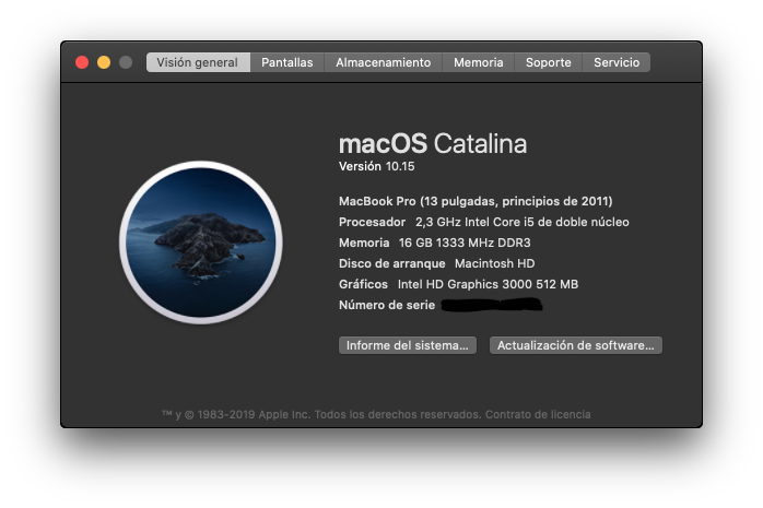

Hi Everybody, first of all thank's to @dosdude1 and the rest of the contributors for creating this patch.
In other hand, right now i'm running the 10.15 on my MacbookPro 8,1 and i've noted when i'm trying to talk to Siri, the only way that i have to ask something is just typing, i remember when i was on mojave with Dosdude Patch i was able to talk with it, so my question is, is this error/bug/fail normal or i'm the only one with this issue and offcourse, if i'm the only guy with this kind of issue what do you recomend to try... i was thinking to try installing the patch that came with Mojave Patcher only the Siri Patch, while i'm typing this word i remember that Siri Patch came with the first Beta Patch of OS 10.15 Beta.
Thanks a lot for your help, support and ofcourse your work.
