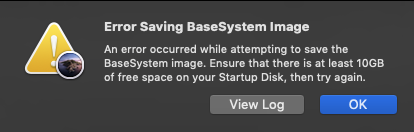

Trying to create usb Catalina patcher and I continually am getting "Error Saving BaseSystem Image". I've tried 3 different usb's and a partitioned ssd external drive. Tried to create usb on iMac running Mojave and MacBook Air running Mojave and same error. Anyone know what is creating this error and preventing it from creating the usb patcher. Same error with Mojave Patcher. usb's are 16GB and I made a partition 32gb.View attachment 870702
Have you turned OFF your firewall? I had that dame issue. Was firewall blocking.

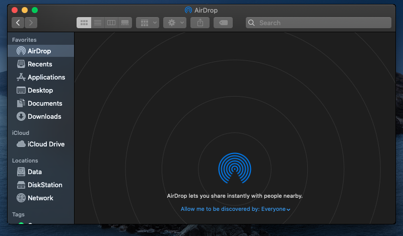

Yes, I actually chose the "Replace" option. The Airdrop icon seems to be correctly shown I think.
The only thing I didn't try was using a Bluetooth 4.0 usb dongle, I was testing using the built-in bluetooth on the MacBook.
From your picture my patch worked, the aim is to make AirDrop to work between Mac on the same wifi network and it does as is, instead to make it work with an iOS 12/13 device you need to plug a Bluetooth 4.0 usb dongle to your Mac, it's a new requirement for Catalina.
