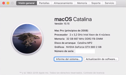

Installed Catalina in my my Mac Pro 3,1, updated Wiifi/Bluetooth module and GPU. Everything works like a charm.

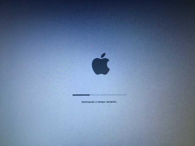

Oh yes, the Ethernet works, just WiFi don’t appears.
My problem now is the installation of Catalina with 1.2.0 dosdude patch. 😕
Install the files without problem for “macOS data install” but after this return a error.
