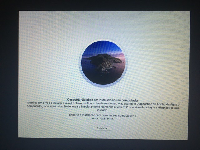

I’m have issues with 1.2.0 @dosdude1 patch.... 😫
any help, please?
